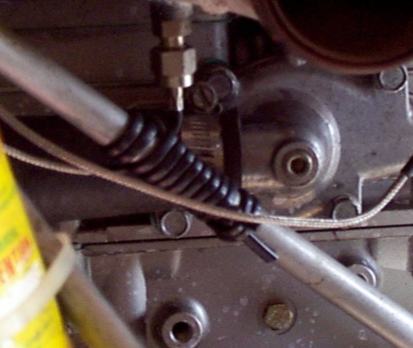

Nylon is a lot faster to install and it does give a good mechanical hold. That's not my beef with it... being sliced on several occasions is and of course those slices although not as deep as a knife blade would make they are a lot more painful and there is the slight matter of all the blood dripping everywhere.
I sure wish I'd seen the surplus sale.. The polyester can be a little on the dear side.
I’d love to see nylon ties do a clean job like this that you could pull a cloth over.
Noel
