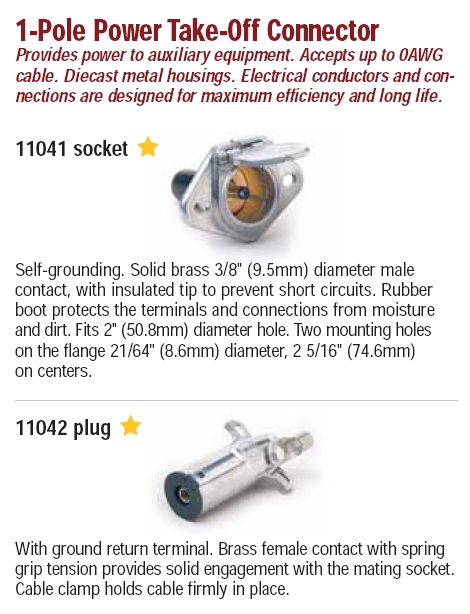

The "military style" 3-prong race-track shaped connector
is common to all bizjets and cabin class aircraft. It's
the connector we used at Cessna on all single engine aircraft
too. I think Piper was the first to adapt the single
terminal high current truck connector to aircraft. It
was lighter, smaller, MUCH less expensive. The "Piper"
style connector found its way onto a number of smaller
Beech airplanes.
Either connector will be found on the FBO ramps.
Having said that, YOU are the one most likely to use
jumpers on your airplane so carrying a set of automotive
jumpers (4AWG) fitted with the Piper plug on one end and
big battery clips on the other is probably the most
practical for weight and cost.

If only a B solution will satisfy you then look to Bob Nuckoll's published
material on this subject. The most commonly found receptacle and plug
arrangement found at FBO's is the three prong. See here:
http://www.aircraftspruce.com/catalog/elpages/extpowerrect.php
The next most commonly found is the Piper receptacle and plug arrangement.**
See here:
http://www.aircraftspruce.com/catalog/elpages/piperplugsock.php
BUT there is a major "gotcha" that you must be aware of if you have a 12
volt aircraft electrical system and you install one of the above
receptacles -- some ground power carts with the above plugs will only put
out 24 volts. If you zap your 12 volt system with 24 volts you will suffer
damage.
'OC' Says: "The best investment we can make is the effort to gather and
understand knowledge."
**PS: There is also a single center post receptacle and plug system similar
in apprearance to the Piper system, but not compatible, that is found on
some Beechcraft airplanes. Very unlikely to find a ground power cart with a
plug compatible with this odd ball receptacle.

Bob Nuckolls suggested that the Piper connector is relatively common -
there are LOTS of Piper aircraft around so I'll probably go with the
significantly less expensive Piper connectors, and make sure to put some
good "12V ONLY" labeling next to the connector.

This is available from just about any auto parts store.
Cole Hersey is the manufacturer.
Socket is 11041. Plug is 11042. Durable, lightweight and inexpensive. I have one on my beast.
Yes, the ground power connection article I published
goes to modifications of the 11041 socket to turn
the rear wire connection into a threaded stud as opposed
to a mash-n-squash termination.
Piper bought their parts from Cole-Hersee but I've
never seen how Piper (or others) have treated
the wire attachment.
[img]cid:7.1.0.9.0.20090513072517.0036fc40(at)aeroelectric.com.0[/img]
A few years ago, I saw this style connector with a
threaded stud already supplied. Don't know who made
it and I've not been able to locate it in any
C-H literature . . .
But agreed . . . don't buy these parts from a Piper dealer.
