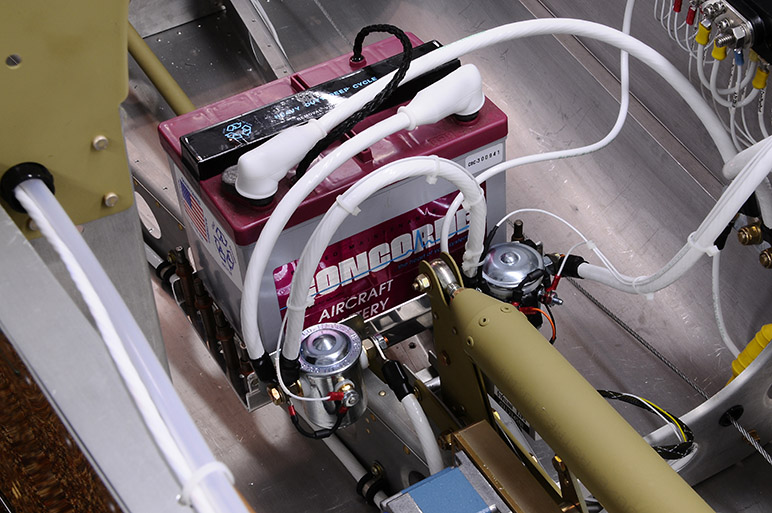

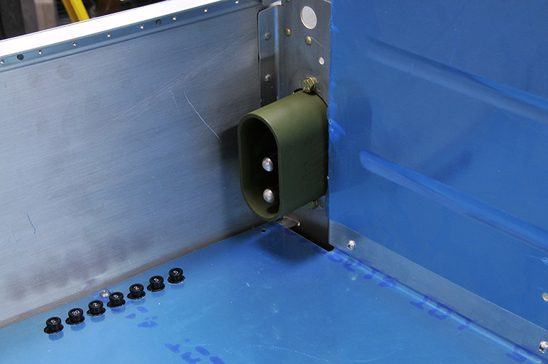

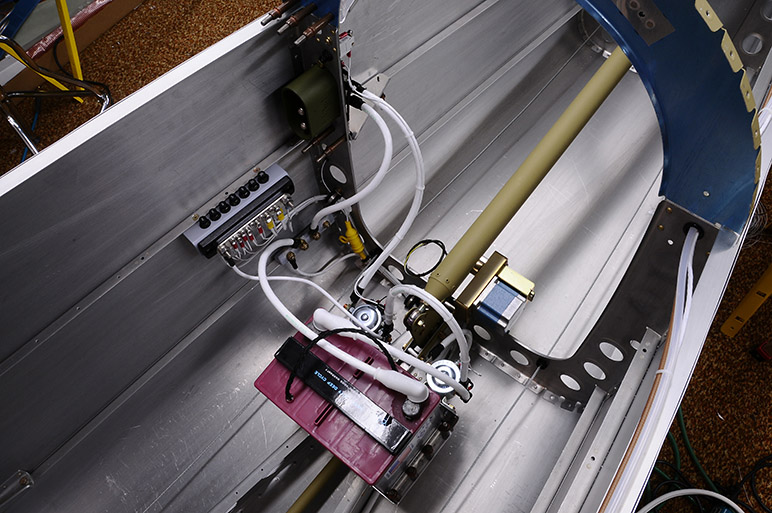

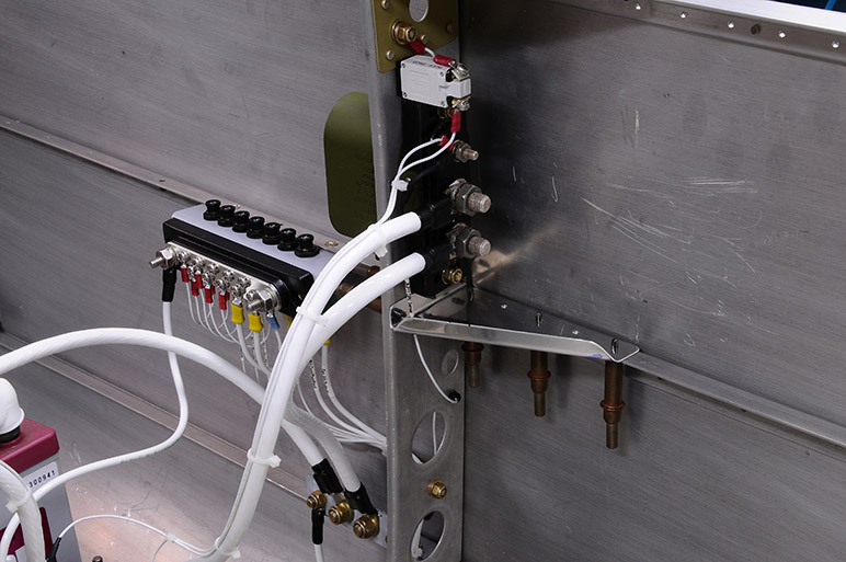

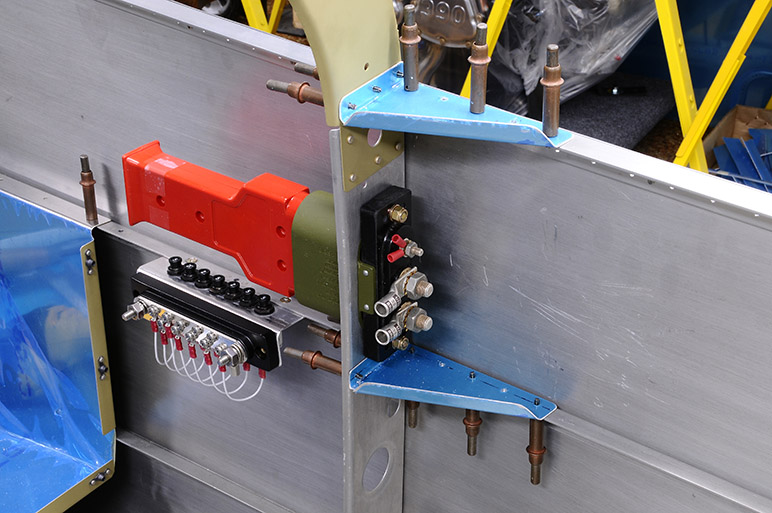

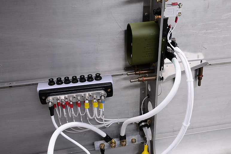

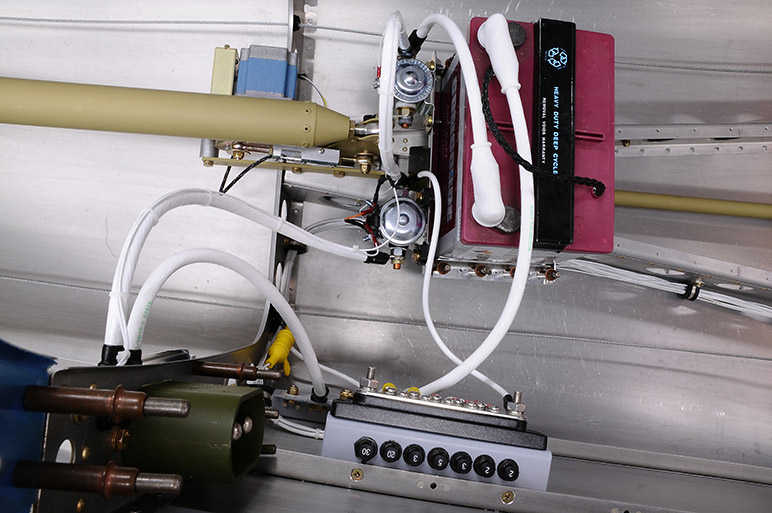

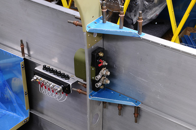

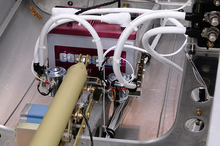

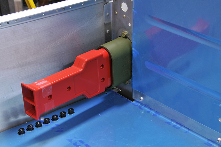

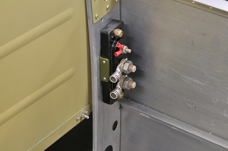

Hi Myron,
Attached are some pictures of my GPU power installation in the RV-8. Works great and allows me to charge the battery, run the avionics, or start the engine. I also included the backbone wiring schematic. I'm using the Vertical Power VP-200 electrical system, but the GPU wiring should be fairly common. The GPU wiring is shown in the lower right hand side of the diagram. I haven't updated the diagram yet, but you might need to add a connection between the Sense input on the GPU plug through a Normally Open push button to the EBus (and through a small fuse or polyfuse). What I found was that the late-model chargers won't turn on their output unless they see about 4-5 volts. So, they won't pull the GPU relay down when you plug the GPU plug in. The button allows you to pull the relay in and make the charger think there is voltage. The only catch is that your aircraft battery has to have enough juice to pull the relay down.
Let me know if you've have any questions.
