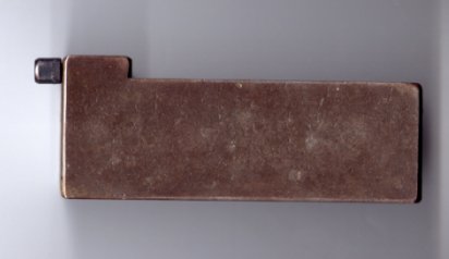

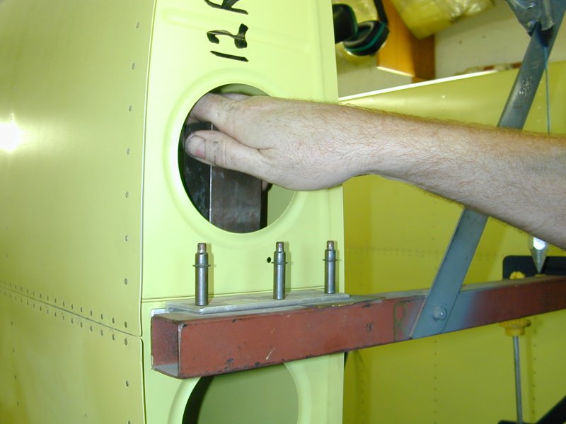

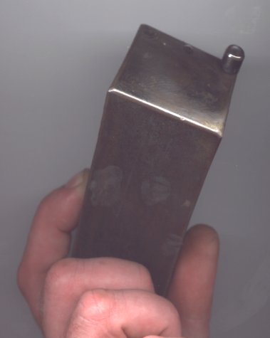

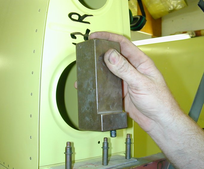

I found that doing this job per Vans instructions to be pure idiocy! It's impossible for anyone (I'm 6'4" with long arms) to be able to accurately buck the rivets for the ribs in the center. I decided to use a different method. I back riveted these rivets in. I fabricated a special, heavy bucking bar for this.
This tool was designed to solve a difficult riveting problem on RV-7, RV-8/A & RV-9A models. On these models, the leading edge assembly is built in a cradle. It is then attached to the wing main spar by riveting the skins and rear flanges of the ribs to the main spar. Setting the 1/8" rivets between the inner L/E ribs and the main spar is extremely difficult to do well. I solved this by fabricating a large "Tim Allen" bucking bar. With this bar, these rivets can be "back riveted" in place.
I inserted the rivets from the front (top as viewed in the jig) to the rear of the wing cord. This is opposite of how Van has you set these rivets. I placed the "Tim Allen" bucking bar with the 1/8" universal set on top of the rivet. I then pressed down on the bucking bar. Fellow RV builder Eric Hensen set the shop heads from below (the rear) using the Avery back riveting set (part # 4580)
Since making this tool (about half an hour with a band saw and drill press) I've found numerous other areas to use it on my 8A. It is basically a piece of cold rolled steel 2" X 2" X 5" with 3 holes to insert your universal rivet sets in. I placed the holes so that I could move the rivet set around. This makes it easier to use the tool to set the end rivets on the leading edge ribs. I did cut a slight notch in the bar so that it would clear the "flange" around the lightening holes in the ribs. This notch allows me to hold the bar perfectly parallel to the rib web while using it.
These 3 holes are there to insert an 1/8" reduced size universal (Avery #1608) squeezer set in. (the ones you use in your Avery squeezer & C tool) The notch is 3/8" deep and 4" long. The 3 holes for the squeezer sets go in the un-notched area. The holes are 3/16" diameter. Make them deep enough to insert the squeezer sets.
Locate them so that the edge of the "reduced diameter" 1/8" universal set comes even with the edge(s) of the bar. Make the cut out area 4" long by 3/8" deep at the top end, away from the holes for the set. The 2 holes on the ends are to allow you to reach the rivets on the edges of the leading edge ribs. I wanted a lot of mass, so that the bar would keep the manufactured head tight against the W-809 rib flange during the back riveting process. To reach the 2 innermost ribs, you won't be able to exert a lot of downward force with your arm muscles. The extra weight (it's 3 pounds) really helps.
I also found this bar great for riveting the main ribs to the rear spar. I was able to install the manufactured heads against the
wing main rib flanges (keeping the manufactured head against the thinner material) rather than against the rear spar.
This method has 4 advantages as I see it.
#1)This method all but eliminates the chance (near certainty) of "tipping" the shop head of the rivets being set on the inner ribs. Using Van's method, the bucker can not see either the tail of the rivet or the surface of the bucking bar being held against it. He is trying to hold the bucking bar at almost arm's length to set the 2 center ribs. Many early RV-8 builders complained of it being extremely difficult to set these rivets without "tipping" them.
#2) Since you back rivet these rivets, the person using the gun can actually watch the shop head being formed. This makes it much easier to get excellent results.
#3)This method puts the manufactured head against the leading edge rib flange. This follows Mil-Spec recommendations. Van's method puts the shop head here where it is very hard to see (read impossible) while setting the rivet.
#4)Place some duct tape on the web of the main rib while back riveting these rivets. This will prevent any damage if the back rivet set slips.
Charlie Kuss
