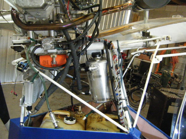

Well it appears that I finally have a handle on my heating problems with the HKS. If you remember I put some shrouds? over the cylinders to pull and route some more air to the heads. This resulted in a reduction of about 20 to 30 degrees which was great, but the OAT was 40 degrees at the time. The weather finally warmed up to the mid to low 70's and I was back up bumping max CHT's temps with any rpm's that were significant enough to keep me clear of the sage.

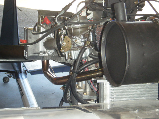

The problem was that the muffler and oil cooler were mounted on top of the tube above the wing and was blocking a lot of air flow. The carbs are mounted just behind them so the air was really screwed up coming around all that crap in front of the cylinders. The oil cooler had at least half of its surface blocked by my little shorty gap seal. With all that stuff up there, and all the oil hoses running everywhere, I just cut off the gap seal even with the oil cooler.
[img]cid:C41E78E252B44FAC88E395B903512861(at)larryPC[/img]
You can see what a tortured route the air has to go through to get to the cylinder heads.

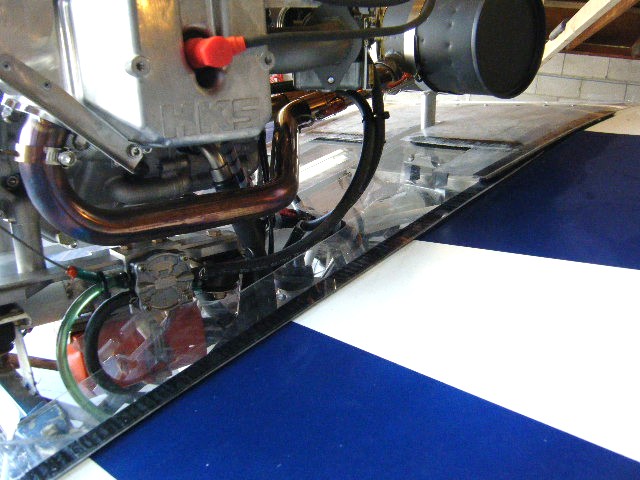

This is what it looks like with the cooler moved.
[img]cid:3F88EC68FF3B45E28453346FEF50956E(at)larryPC[/img]
You can see where the gap seal ended. With the rerouting of the oil hoses this time I made sure that they were as close to the root tube as I could get them and I added some lexan to enclose as much of that area as I could. I ended up with two pieces since I still had to allow for the muffler stand, but I got most of it covered up.
[img]cid:4054121472D74491839AF0B8AA7DEE54(at)larryPC[/img]

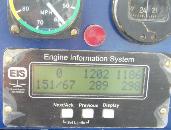

I had noticed when I first flew it after installing the HKS that I had lost about 5 MPH on my stall speed. (yes I do have VG's) It went from about 29-31 MPH to 36-39 MPH. I knew that I had added weight and that was what I had attributed the loss to. Well after I moved the oil cooler I took it for a test flight with the old gap seal in it. (test one thing at a time) The OAT was 71 degrees.
[img]cid:6D57019B0A2F47A99062AB6BF35EA84A(at)larryPC[/img]
This was my EIS reading at (I am guessing since my RPM's weren't working due to a loose wire) 53-5400 rpms. (top line RPM-left EGT-Right EGT. Bottom line- Oil temp-oil pressure-left CHT-Right Cht) The last time I flew over this same spot at this same OAT temp. I was bumping max CHT. I never got within 30 degrees of max with the oil cooler moved.
OK, back on the ground and I start working on the gap seal and take off again after installing it. Now the weather had changed and the wind had come up. The air was pretty bumpy with the thermals and I was getting good climb in the 6-700 FPM range. 350 was about the best I could do with the 503. I decided to do some stalls to see if there was any difference. I was back down to 31-32 MPH and my max CHT was 271. I had fixed the wire to the rpm's and found that I was actually able to fly at 4900 RPM's, which I had not been able to do before. As I say the air was bumpy and very squirrelly, so I am not going to draw any hard and fast conclusions other than CHT temps until I get a chance to test it on a calmer day. However it does appear that installing the rest of the gap seal has improved my performance significantly as well as lowering my temps.

PostPosted: Sun May 10, 2009 4:53 pm    Post subject: The further adventures of HKS Firestar Reply with quote
Larry
Do I read oil temp as 151F?
Isn't that still too high?
Russ Kinne
PostPosted: Sun May 10, 2009 5:08 pm    Post subject: The further adventures of HKS Firestar Reply with quote
Kolb-List message posted by: russ kinne <russ(at)rkiphoto.com>
Larry
Russ Kinne
I can't reply for Larry C and his HKS, but just for info the minimum oil
temp on the 912 series engines is 190F. Reason: To burn off condensation
and contaminents.
My oil temp normally runs 230F and as high as 250F during long full throttle
climb outs.
Red line is 285F for 912UL.
266F for 912ULS.

PostPosted: Sun May 10, 2009 5:34 pm    Post subject: The further adventures of HKS Firestar Reply with quote
Hi Russ,
The HKS ops manual says max oil temp is 230F for 5w30.
Frank Goodnight
HKS Firestar2

lcottrell
Joined: 29 May 2006
Posts: 1494
Location: Jordan Valley, Or
PostPosted: Sun May 10, 2009 6:52 pm    Post subject: The further adventures of HKS Firestar Reply with quote
Yes the oil temps are a bit low, but I am sure they will come up when summer gets here. I may tape the cooler until then.
