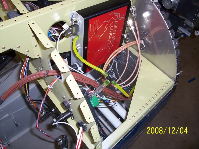

I am wondering how those of you, who use the LSE Plasma ignition and the AFS Engine monitor interconnected the manifold tubes. Is there a Y-connector available that allows to root one pipe to the LSE and the other to the AF Manifold transducer from the firewall tube fitting.

I forget what the ID is on the yellow tubing that comes with the LS kit but get a barb T from Aircraft Spruce for that size. Call Rob at AFS and they can send you a replacement fitting for the inside of the bulkhead fitting from Vans. You then use the yellow tubing from the bulkhead to the T and from the T to the LS. The use another short piece from the T perhaps 1/2" and push it inside some tygon tubing. You will use something like the 1/8" ID tygon tubing and slip it over the yellow tubing and together push it onto the 3rd T fitting. The other end goes to the AFS manafold transducer.
Hope the attached picture helps.

Thank you Gary that helped a lot.
