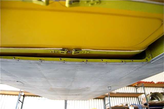

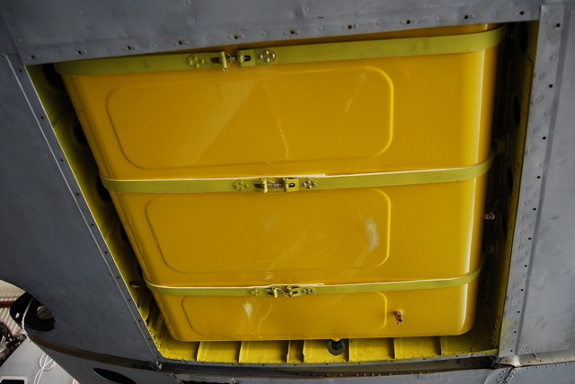

31 Gallon Long Range fuel tank installed. 3rd strap added to support additional weight. Meets all FAA structural sheetmetal modificaiton criterion. Fuel cap with capacitance sending probe at high end of tank allowing for reading of full capacity of tank. Vent fitting not attached.

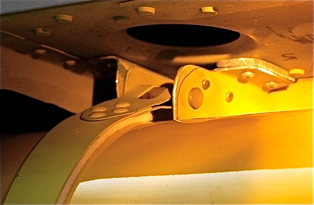

Strap bracket installation.

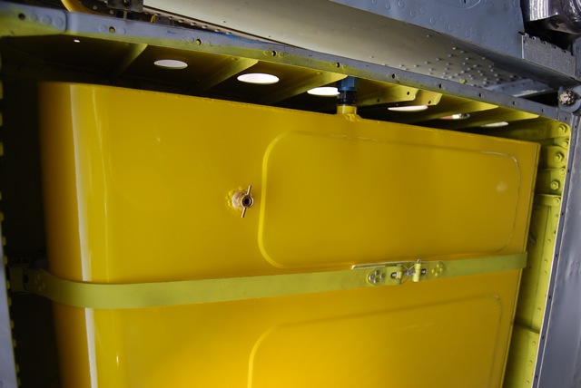

Tank goes through rib which is properly reinforced.

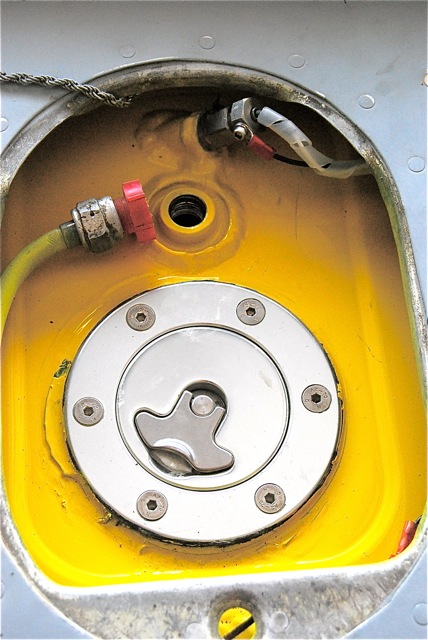

The substantial removal of the wing rib to enlarge the fuel cavity reduced
the cross bracing provided by the original rib. Complex engineering
calculation and test would be required to fully evaluate the effect of your
modification to the wing structure. I assume your engineer considered this.
Has static testing been done to verify your structural design? The tank
suspension system looks good.
