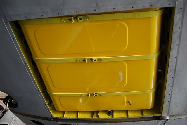

People have been asking about the progress of our fuel tanks. Well, here are pics of our second installation. We are well along on our 3rd installation and have standardized the process. A bit over 31 gallons a side gives you "BBR" capability (Beyond Butt Range or Beyond Bladder Range).

CJ Extended Range tanks
31 Gallon Long Range fuel tank installed. 3rd strap added to support additional weight. Meets all FAA structural sheetmetal modificaiton criterion. Fuel cap with capacitance sending probe at high end of tank allowing for reading of full capacity of tank. Vent fitting not attached.

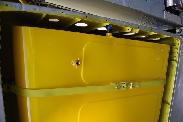

US quick drain installed for ease of defuling. Original strap and fuel fitting locations and specifications.

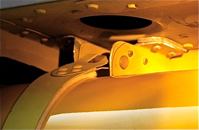

Strap bracket installation.

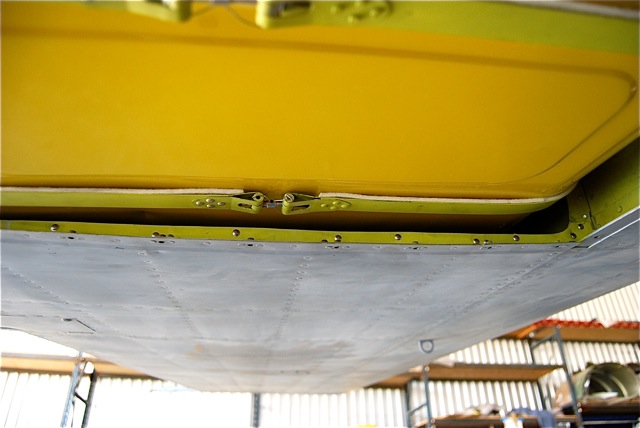

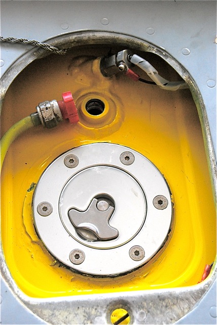

Tank goes through rib which is properly reinforced.
