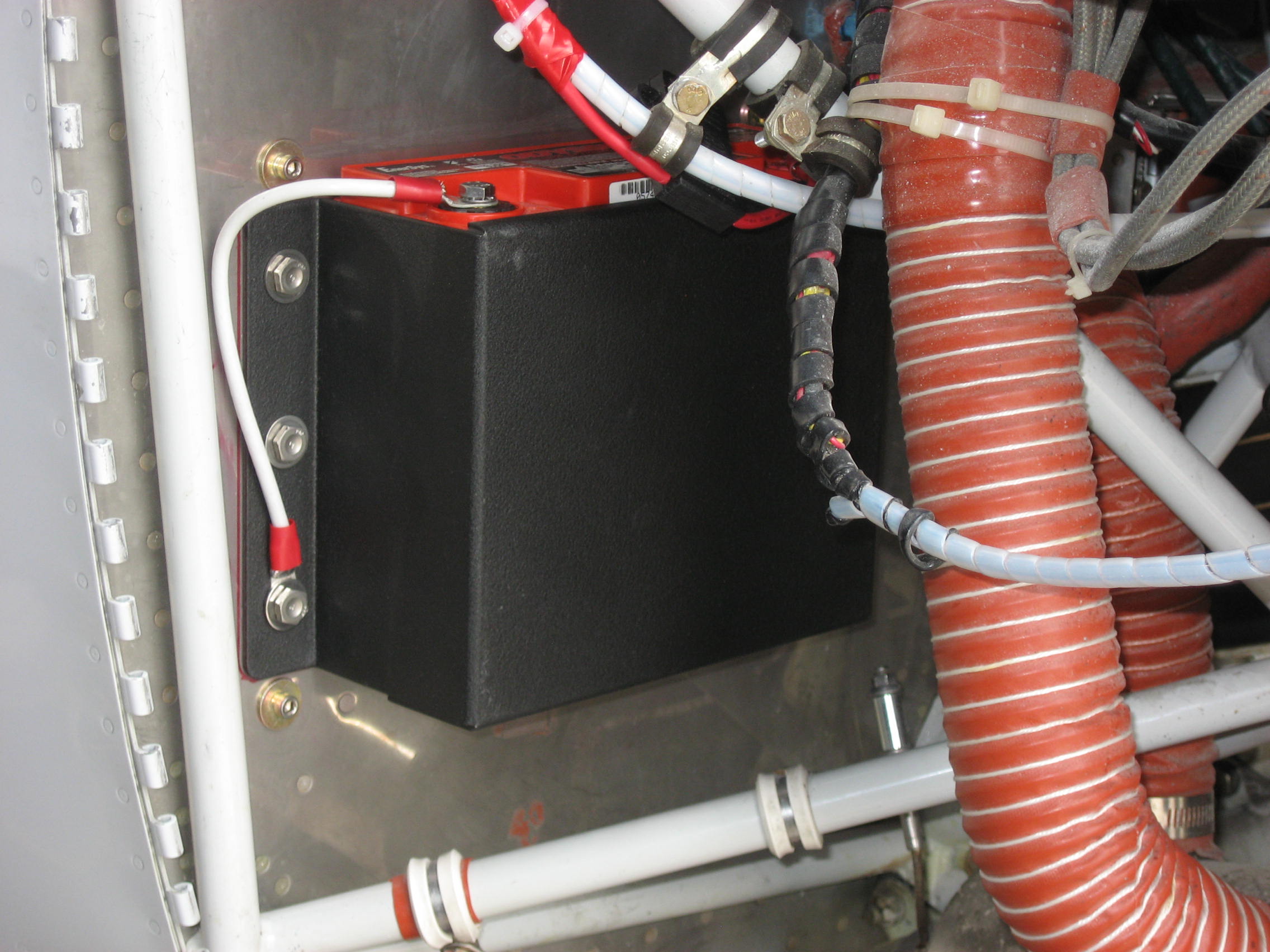

Just completed the first annual and re weighed after installing the extra battery. The new weight is 1666 and a cg of 108.13. installing the 680 on the firewall moved the CG about an inch forward. I won't feel any anxiety loading 100 pounds in the baggage area (35 pounds of tools and 65 pounds of family things). Based on a previous weight I calculate the battery at 15 and the paint at 21.

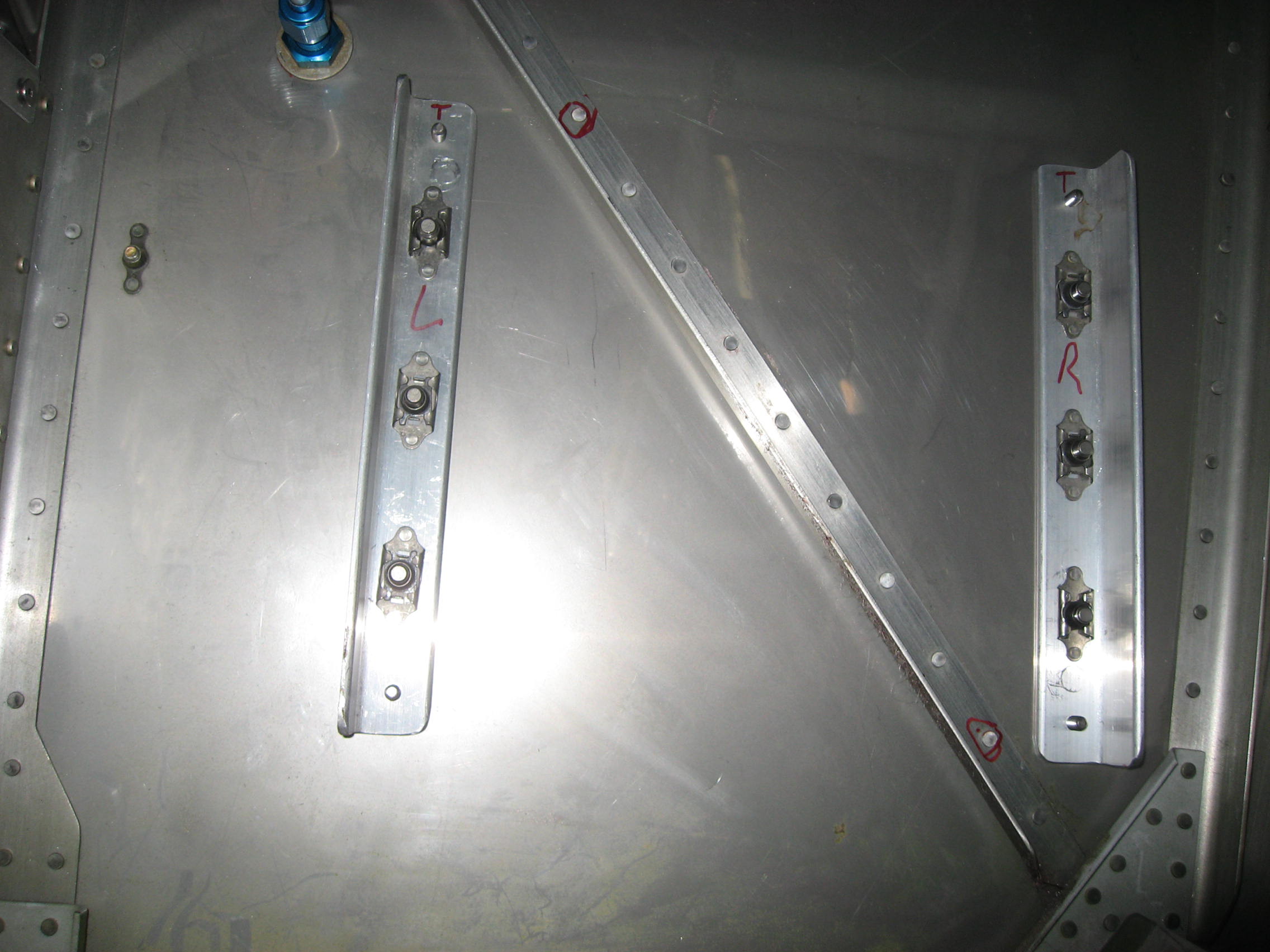

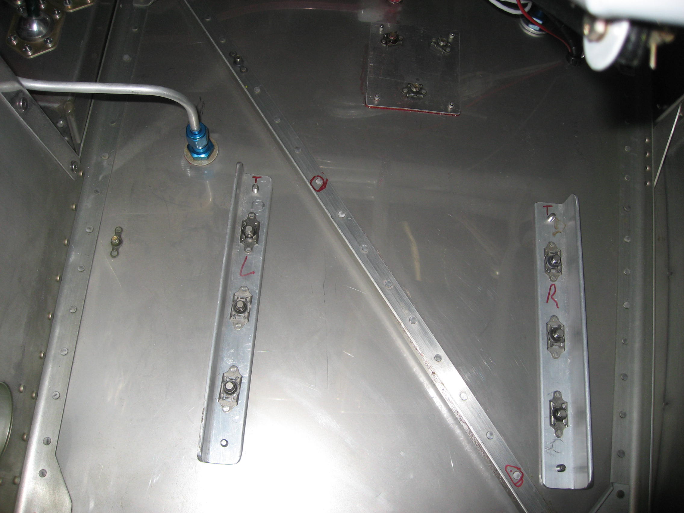

Can you show us where you placed the 680 in the front?
dlm46007(at)cox.net
PostPosted: Sun May 03, 2009 12:34 pm    Post subject: W&B update Reply with quote
Exterior and interior views
