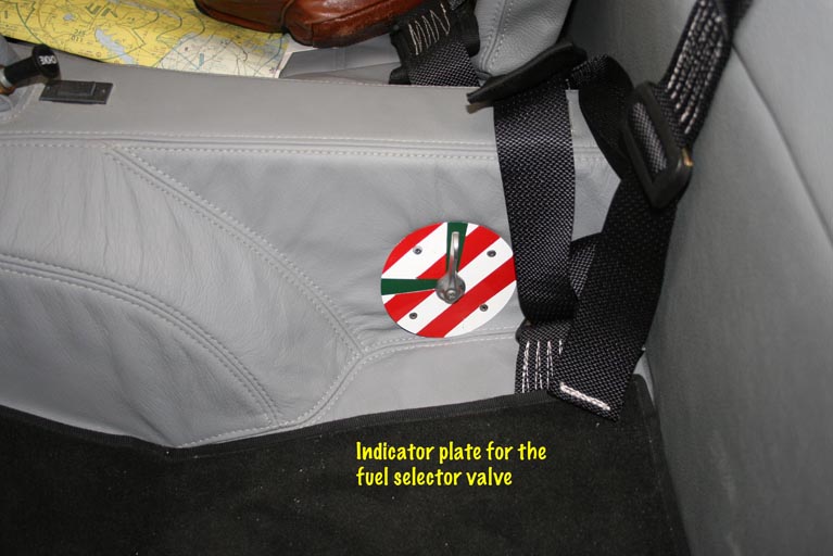

rlborger(at)mac.com
PostPosted: Tue Apr 28, 2009 2:38 pm    Post subject: Fuel valve open or close between flights Reply with quote
Raimo,
I said "many" off positions because my fuel selector valve is a
simple, 90 degree, ball valve which will rotate 360 degrees as many
times as you want to turn it. And in any position besides forward or
up it is effectively (greatly reduced flow) or fully off. That is why
the fuel selector back plate is thus:
Check six,
Bob Borger

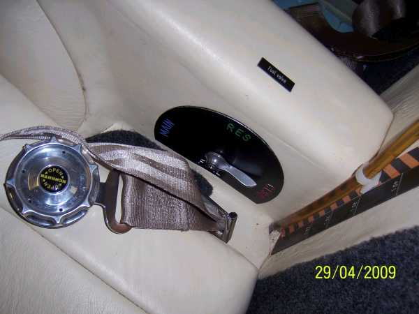

raimo.toivio(at)rwm.fi
PostPosted: Mon May 04, 2009 7:04 am    Post subject: Fuel valve open or close between flights Reply with quote
Hi Bob "check six" Borger and all
This is my fuel selector back plate w blue "main", green "res" and red "closed" positions (one only).
We have similar Europa type valves with two click-type off positions.
You see it is impossible to select another (down) off pos because it is mechanically prevented.
There are hundreds of different back plate arts - would be interesting to see them all!
If you compare our pics there is also one other difference but that is for another topic.
This topic will explode banks I am sure - so please find out your heart medicines.

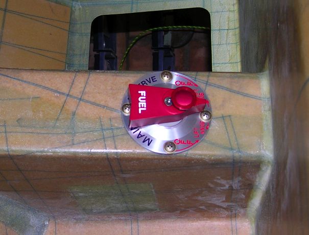

Raimo - attached is a picture of my fuel selector as fitted to the
cockpit module (not yet installed in the fuselage). I had to use a
short extension between the selector and the valve to let the flap
actuating rod pass. I may need to fit a transparent hinged cover for
better elbow comfort, but I think the Andair selector, fitted in this
location, has much better ergonomics than the standard XS factory
arrangement. I tried sitting in the CM and operating the imaginary
valve protruding from the tunnel down by my right hip and found it
most awkward - I would not like to use it in an emergency.
Andair caution against excessive operation of the valve dry (I ran
some kerosene through mine for lubrication while I was fiddling about
with the installation), but they don't seem to place any restrictions
on operation once wet with fuel and in service.

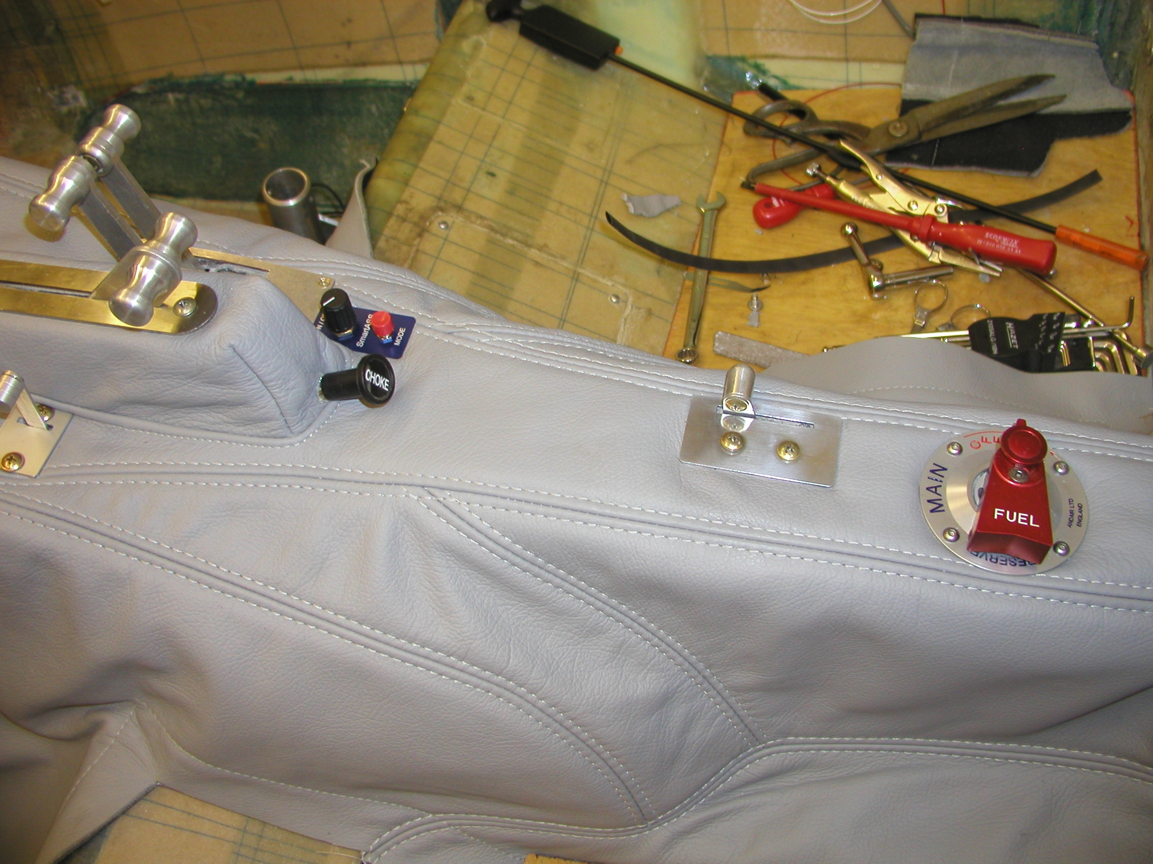

PostPosted: Mon May 04, 2009 12:02 pm    Post subject: Fuel valve open or close between flights Reply with quote
Hi Raimo
My Andair fuel valve is slightly different to Rowlands, Its off position is to the right,You are unable to shut it off unless you lift the centre pin, But you can move between Main and reserve very easily, In my opinion its idiot proof,
I would highly recommend one to replace the standard europa valve, I normally close the valve after a flight,
regards
Ivor
