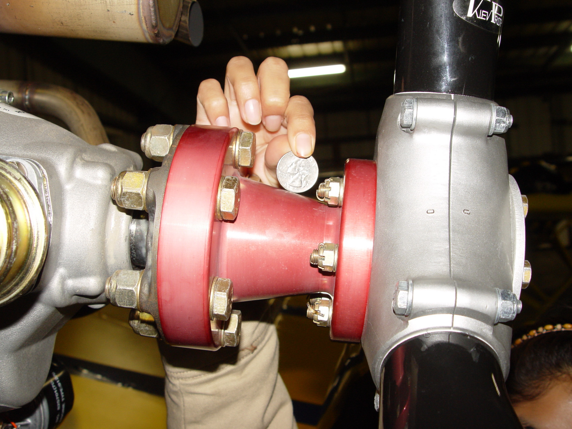

The Kiev has nickel leading edge plating, as does the Warp Drive, this makes it suitable for flying in Rain, Floats, where water would be hitting the leading edge. Either prop would be fine on floats. This does NOT make the Kiev a tough prop, to the contrary, the Kiev is very light and fragile. For mounting on a pusher Kolb MK III, you need a very strong prop capable of staying together when a foreign object goes through it, not one that is ONLY resistant to water spray.
Look at the picture below, putting 100 HP into that narrow aluminum prop spacer is not something I was comfortable with. My Warp Drive prop has a much bigger mounting bolt pattern and much larger diameter spacer. Both the Hub and Prop blades are extremely light, definitely not what I want considering the strong power pulses of the Rotax 912. But if anyone wants a good, slightly used Kiev Prop for a Rotax 912, I have one for sale !!! As much as I would like to sell this prop and get back some of the money I paid for it, I am not the type of person that would sell something that might get someone hurt in their Kolb just so that I can profit. If anyone wants to buy this prop, they will get my honest opinion about and its potential hazards first.
