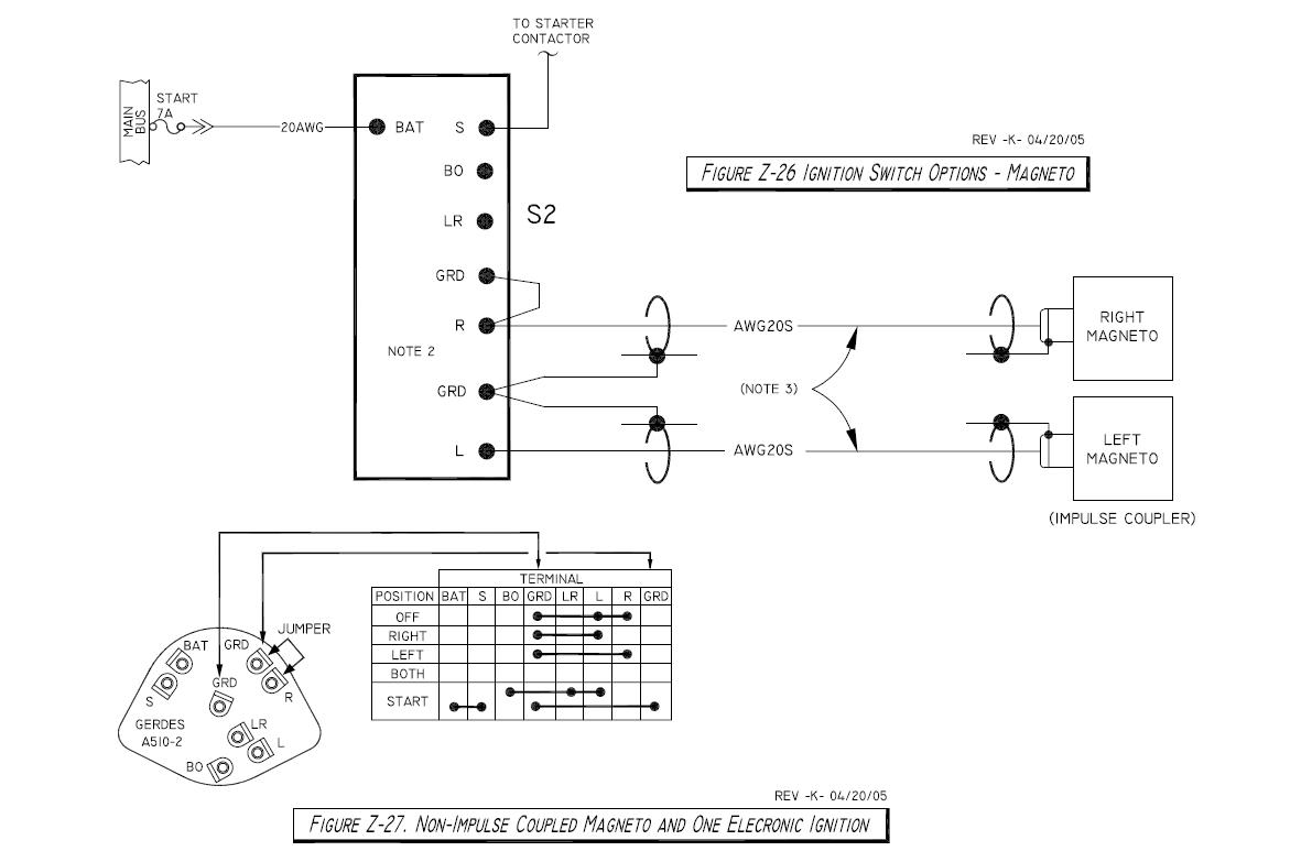

Here is some more information: The common off-left-right-both-start switch from Aircraft Spruce has two terminals on it labeled “GRD”. The shields on the p-leads connect to the GRD terminal in the center of the switch. I’ve attached a snippet from diagram Z-27 in the AeroElectric update on page 36 at the link below. The table shows what actually happens inside the switch.

john.marzulli(at)gmail.co
PostPosted: Fri May 01, 2009 5:08 pm    Post subject: Need some help with the ignition switch Reply with quote
That clears it up!
I was under the impression that power was flowing out of the switch to the p-leads closing a solenoid on them ( or something else ). It makes much more sense that power is flowing out of the mags to the P-Leads.
