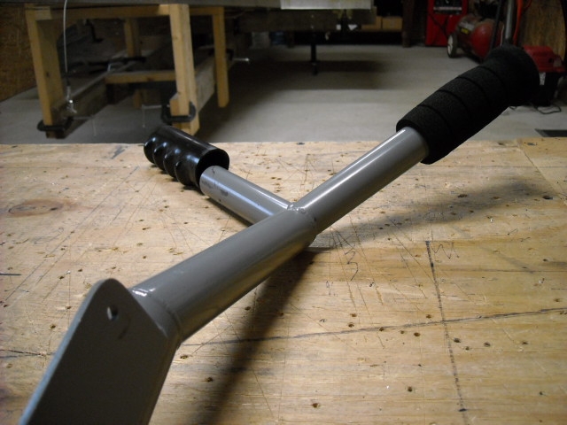

2. Headphone console complete, wiring the PTT switch. Was going to use a Ray Allen handgrip for the pilot side and a Zenith for the other. Guess what. The Ray Allen fits one of the "Horns" of a Y stick, but both the factory Zenith handgrips will only work if you cut the "Y" off. A lister sent me a picture of a Y stick cut down to a single a couple of months ago. I saved it in my "Keepers" file but damned if can't find it. If you're out there, did you modify one of the Zenith grips to work with a Ray Allen switch? Please resend picture of your installation.

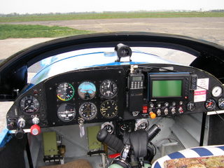

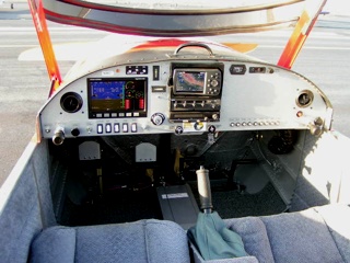

Copy of picture you were looking for attached plus a copy of our panel.
    I am not sure of your problem, as far as I am aware the vertical tube is the same diameter as the horns. We attached a Ray Allen grip with trim & PTT switchs to LHS of Y , for the RHS we fitted a small n/o switch for ptt into the top of the plastic grip supplied & slid this onto the RHS of the Y using some lubrication with no problem. We have a intercom fitted & find the Y stick comfortable & easy to change control between pilots & for the co pilot to operate the radio .

Attached is a picture of my Y stick. To the left is the Zenith supplied grip, to the right is the Ray Allen. I'm sure you can see the step down from the main shaft of the Y to the ears, as well as the obviously oversized Zenith supplied grip. I've been putting up with crap like this for 6 years. Very few parts supplied were to plans and I wound up having to modify them to fit or make them myself from scratch.
Thanks for the single stick picture. Looks like other than a stock Ray Allen grip was used, and it sure isn't Zenith supplied.
