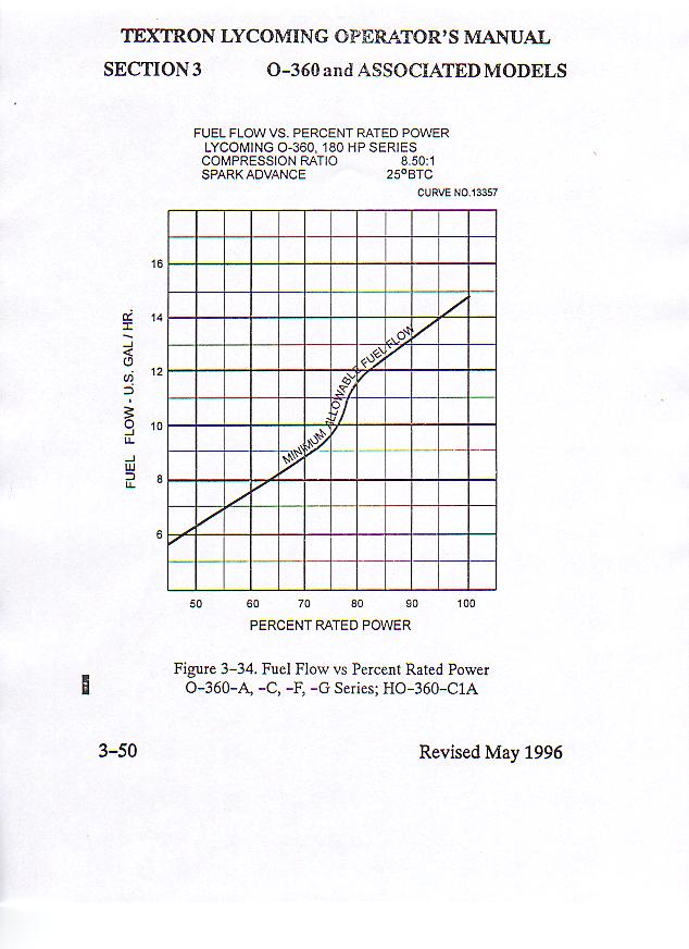

I didn't really understand what you needed when I first read your email. I guess I'm a little slooow but after rereading it a few times I have something for you that might help. The Lycoming Operators Handbook gives Figure 3-34 for determining power in flight. It replaces the Figure 3-2 in earlier manuals that I think you were referring to. Anyway Figure 3-34 is Fuel Flow VS Percent Rated Power. From there you can determine HP from your fuel flow.
Attached Figure 3-34

PostPosted: Tue Apr 28, 2009 6:32 am    Post subject: Cowling: Percent power. How to calculate? Reply with quote
The full throttle curve in Fig 3-2 is for engines with CS props and the propeller load curve is for a prop that is pitched to result in full throttle at 2700 rpm. Any other situation would be a different curve. Fig. 3-34 is for O-360-A4D, -F engines (don't know what the difference is but they should be very similar. Notice on this curve that the fuel flow makes a jog between 75 and 80% power. The upper portion is a rich mixture, probably best power, and the lower portion is a lean mixture, or best economy. If you are at peak on LOP the fuel flow will be relative and a fixed % or power but on the rich side the fuel flow can be all over the place depending on where you are on the curve, i.e., how rich.
Of course you (Gary) have a special situation that changes the relevance of either of these curves! Probably the best curve to use (for FAA purposes) would be Fig. 3-17 provided you have a MP gauge and use that along with RPM, pressure alt. and OAT to determine % power. It is with an MA4-5 carb but there should not be any significant difference with the HA-6.
I don't know where you came up with .435 BSFC.  Fig. 3-2 shows the best BSFC to be about .46 lb/hp-hr at 2350 rpm on the propeller load curve. I don't think you can get that low on any 8.5:1 CR Lycoming engine unless you have FI or a pressure carb under the most ideal conditions.

Page 3-50 Figure 3-34 Fuel Flow VS. Percent Rated Power for the O-360-A Series (which by my assumption must include the A4K in the Tiger)
The logic of the manual seems clear:
A) Figure 3-34 is based on the above specified leaning practices and is meant to be used in conjunction with Leaning based on Page 3-9 LEANING TO FLOWMETER.
B) Figure 3-34 takes into account whether you are at best economy or power and it is based on the leaning instructions given on page 3-7. Notice Lycomings use of the term "approximately" and how that is reflected on the figure in the change you noted from 75 - 80% power.
C) EVEN IF YOU DON'T AGREE WITH THE ABOVE
For the purposes of certification I would argue that Figure 3-34 gives the manufactures data as concerns percentage power based upon fuel flow when the engine is operated by the manufacures stated practices. I would also argue that ALL the test flights whereby data was derived for the certification of the "cowling" were operated in strict compliance with the engine manufacures practices as stated in the manufactures manual and therefore the manufacture provided data ie Figure 3-34 and ALL the flight test derived data is authoritative and accurate. I would also make it clear that the Lycoming Operators Manual States on Page 2 that it is APPROVED BY FAA and because it is APPROVED BY FAA that there is no question as to the applicability or validity of the data contained therein to answer the current question / requirement posed by the FAA
D) I understand what you, Gary stated in PROBLEM 2.
I learned about that during my MT prop arguements with those that argued going from 2500 to 2700rpm was going to get some additional 16 or 32 hp depending upon who was reading what curve...if the correct curve is used one finds that only 6hp is gained.
I would not be concerned with PROBLEM 2. If for some reason you don't like or cannot use the argument above based upon figure 3-34 then pick another figure from the operators manual and make the same argument of logic proposed in C) above.
Figure 3-34 gives the right engineering answer as far as Lycoming data for power. The other figures may or may not give the right answer...BUT it doesn't matter. What you need is to answer the FAA. They don't care what or whether it's based upon right they just want it from an FAA APPROVED source even if it's BS. Focus on giving them what they want and not on what you'd like them to know!

Gary.... what was the manifold pressure reading at the 5000 ft measurement point of your first post?
My DA calculator says the 5000 ft at 30 F was a DA of 4400 ft - for future power chart look-ups...

Gary... if I read this chart correctly, and you had 25 inches of manifold pressure, then you were just over 160 HP at 2700 rpm.
