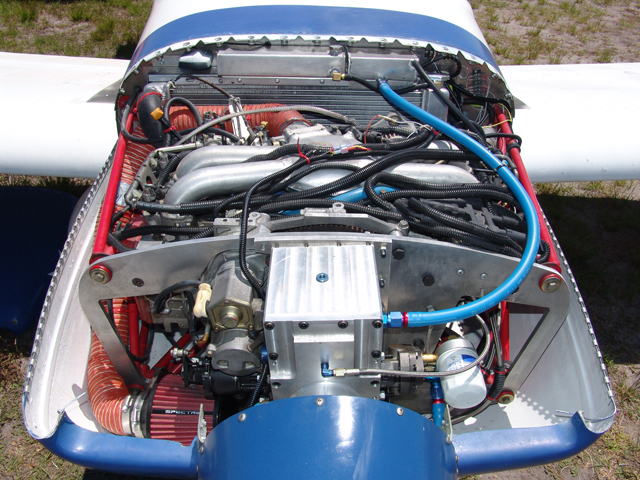

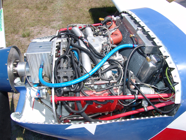

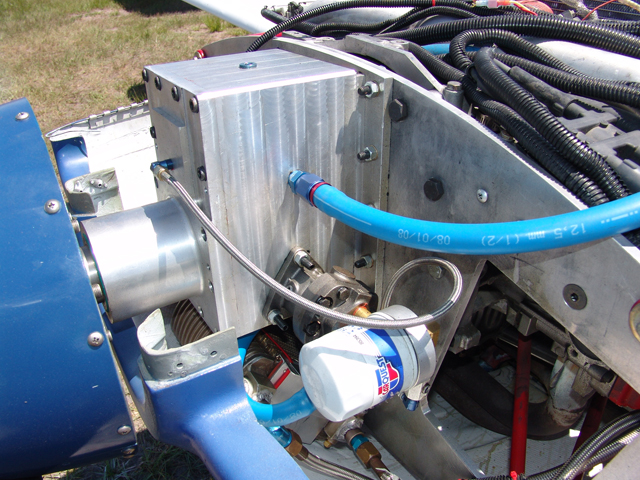

I just got back from SnF, where I saw Jerry Perryman's RV-9A that flew in from Conroe, TX. It has an EJ25 Subie that Bud Warren (geareddrives.com) modified with a rear mounted, 3 pass radiator and a new gearbox. Originally an Egg engine, Warren and Perryman flew in it to OSH last year and Bud was concerned about the high temps and gearbox noise, so he thought he could it do it better.
According to Perryman, his temps are now down 60F to 160, and he's tickled pink. Warren used off the shelf gear sets and other automotive components for the PSRU, which has the added advantage of easy gear ratio changes at about $200 per set. It also has its own enclosed lube system, using hypoid gear oil.
The PSRU prototype is as ugly as sin right now, since Warren started with a spare rectangular hunk of aluminum billet for the gear case, but it appears to be working. The radiator is prettier, though, but it's mostly hidden.
I took some photos if anyone's interested.

PostPosted: Thu Apr 30, 2009 6:17 am    Post subject: Whatever happened to Subies Reply with quote
OK, here's a few.
