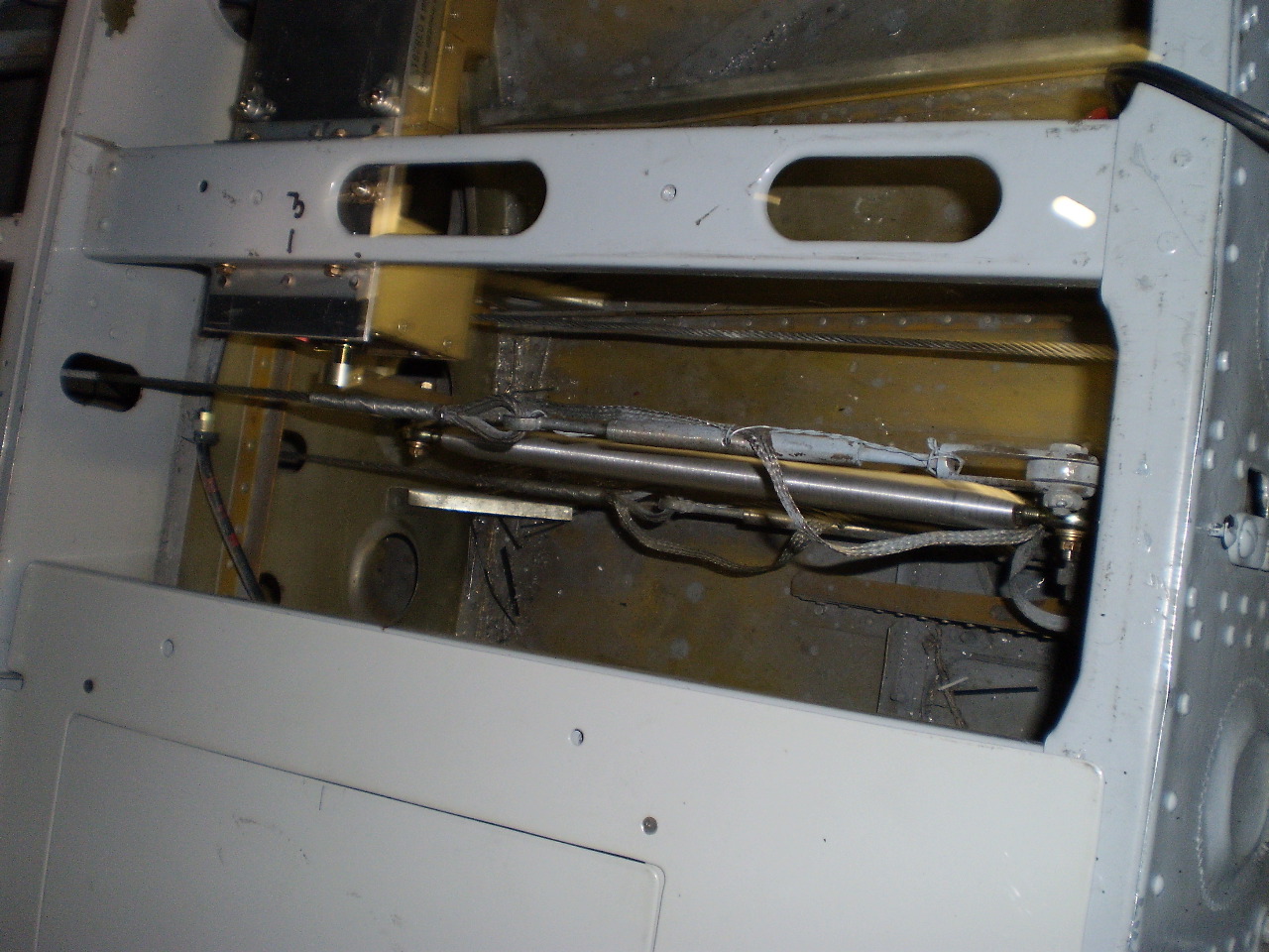

Regarding your post on AP pitch servo installation location we have
determined that the best place is actually under the radio rack area or
"baggage compartment" where you can mount the servo directly to support
frames for the old radio, and more importantly attach the control arm
directly to the bell crank. If you'd like pictures of an installation,
just let me know....

Autopilot servos can provide more than 18 pounds of pressure. Mounting a servo to the skin of the plane or to an inspection panel may not be the best solution.
I'll try to attach the pic of Barry's servo install in my CJ.
Craig W.
CJ-6 Pitch Servo Install by Worldwide Warbirds.
