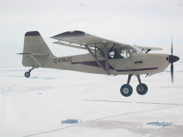

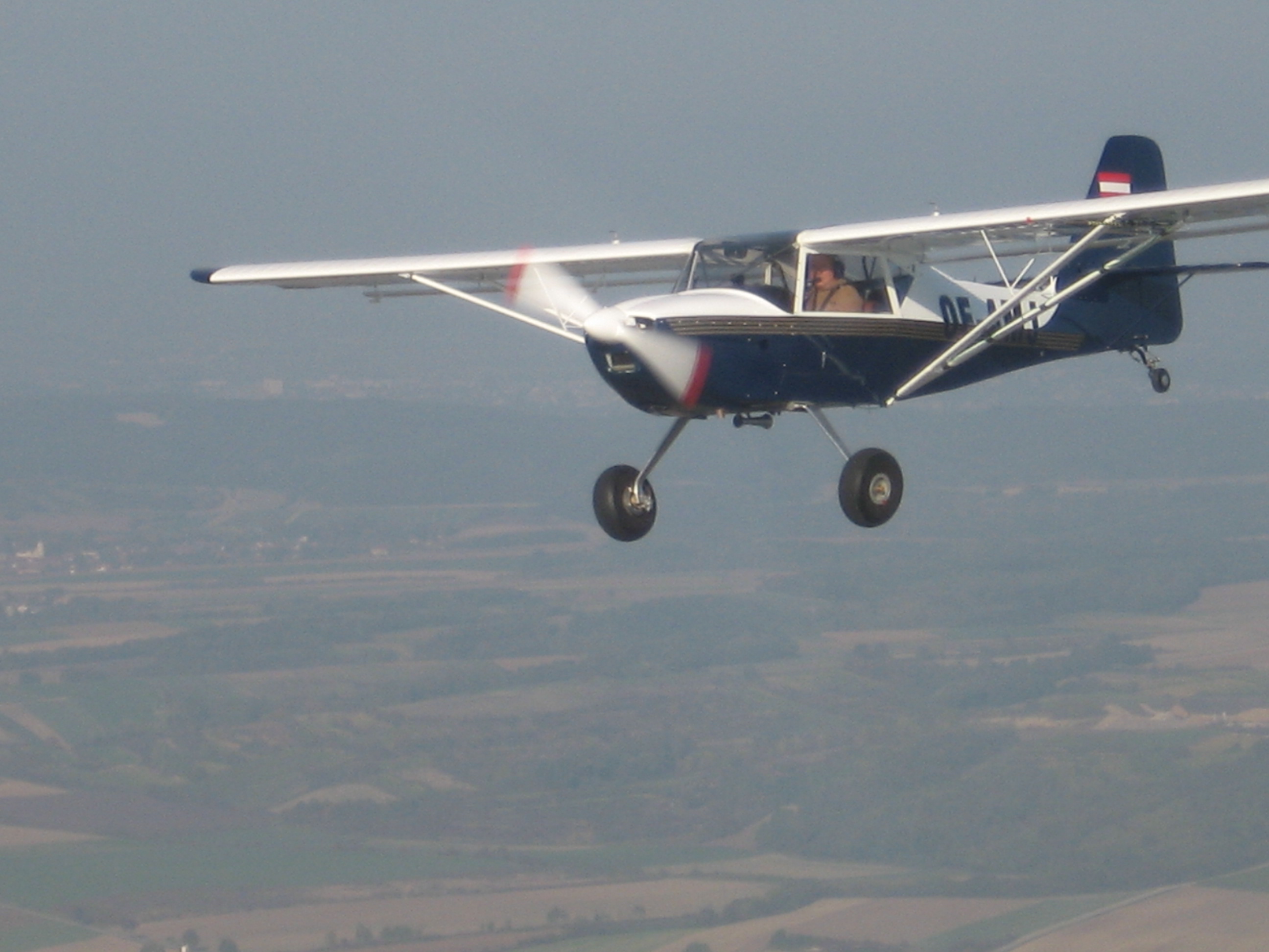

We have exactly no suction from the 4 inch Venturi mounted under the fuselage of our S5. You can see the location in the attached photo - just behind the Grove gear and the top lip of the venturi about in line with the bottom of the gear horizontal part.
Obviously a dead area. As it's difficult to mount such a big venturi on the side of a kitfox cowling, where it would probably work ok, we're wondering what others have done? Drop it further into the airstream in the same location?

I have seen one mounted on a 4 just under the door on the fuselage.
Lloyd Cudnohufsky

Thanks Lloyd. Would that be under the pilot's side door? Just trying to figure out where the best blast from the prop would be. Kerry.

PostPosted: Sun Apr 26, 2009 7:51 am    Post subject: Venturi location - no suction Reply with quote
Mounted mine here, no problems and it works great
Jim
Jim Corner
Model 2, 582,. Ivo med !FA, 1100 hrs
Model 5 0-235 45hrs
Calgary, AB

The one I saw was under the passenger's side door, not sure if it would
matter though.
