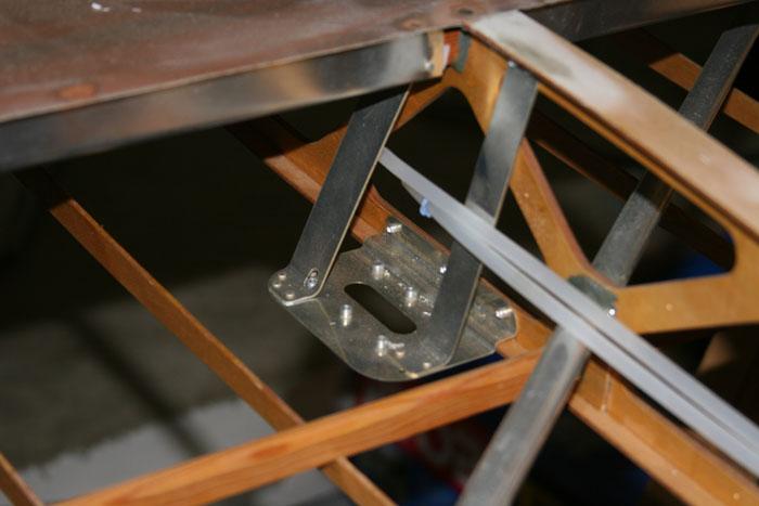

Can someone who has installed Kelly Meiste's unit on a Fox please post some pictures of the installation?

Marco,
I am building, so the attached photo may be of little help to you, but I
might offer a couple of suggestions. If you have a spare wing rib from the
original kit, you may be able to fabricate a mount using that that you could
insert through an inspection ring. Or you may be able to fabricate a mount
that will clamp to the tube between the fore and aft lift struts allowing
the probe to extend forward under the wing. This latter idea might be the
easiest as you may be able to route the tubing down the lift struts rather
than fishing it through the wing.
Lowell Fitt
Cameron Park, CA
Model IV-1200 R-912 UL
Still building
 Filesize:  34.42 KB
 Viewed:  4556 Time(s)
lcfitt(at)sbcglobal.net
PostPosted: Sun Apr 26, 2009 9:56 am    Post subject: Lift Reserve - installation? Reply with quote
One more thought after looking at the photo again, the six rivet like
projections surrounding the cutout are nutserts.
Lowell
