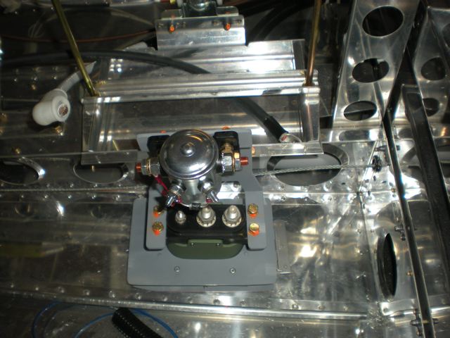

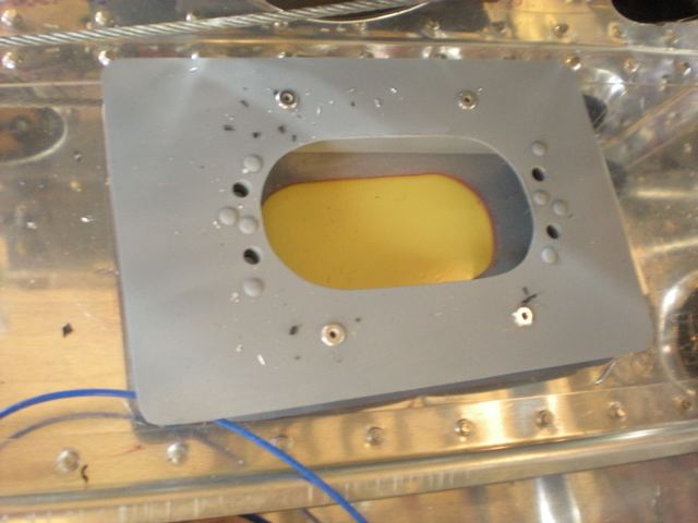

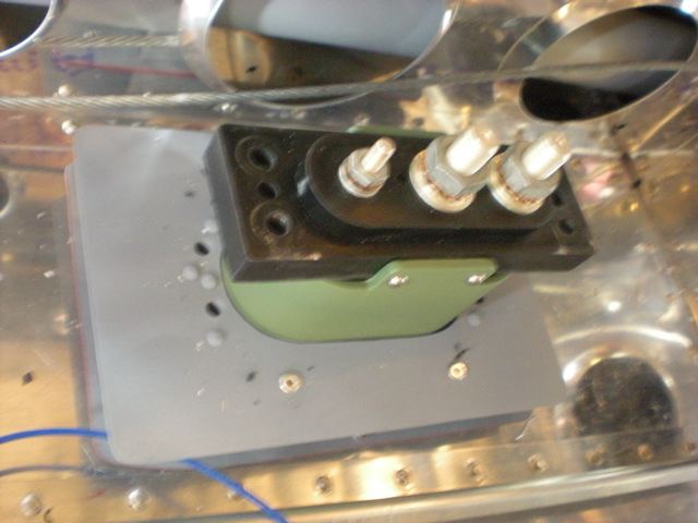

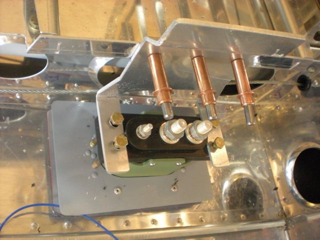

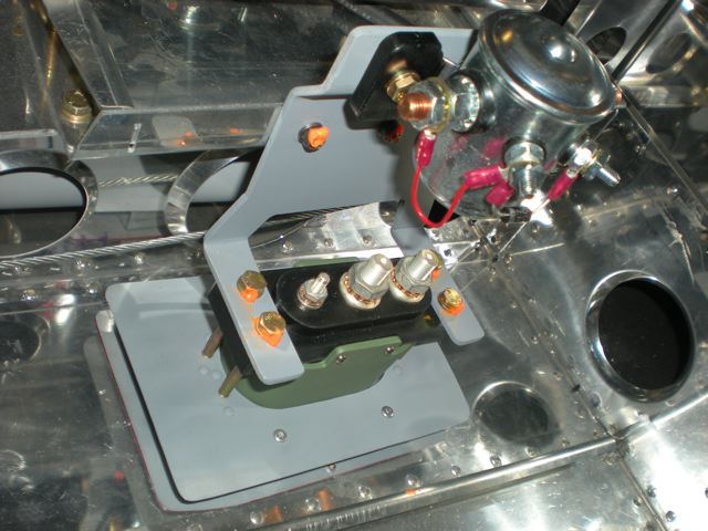

Well, it took a loooonnngg time, but I finally designed, built, and installed an External Power Receptacle in my RV-10 project. I'm sure somebody will see flaws in it, but it doesn't budge a hair!
Basically, it's on the belly with a flap door. Piano hinge at the leading edge and a Camloc at the closing end. A doubler attached to the skin with a hole "just smaller" than the opening in the receptacle. 3/4" square tube is used as spacers for another sheet of metal identical to the first, except the hole is cut so the receptacle can pass through. The AN3-21A bolts basically hold it down hard on the skin and prevent side motion. The 1/8" 3003 bracket I had made by a local metal shop - $45. It is bent "just right" to match the angle of the bolt holes (7º - the floor and the battery box aren't parallel). It's purpose is to lock it in, and tie it to the battery box so it can't be pushed up (or down). The bump out is for the B&C contactor.
The wiring will be according to The Aeroelectric Connection, with a few minor mods suggested by the folks at Vertical Power. The VP200 can sense it powered. The bottom door hinge is a little tricky, trying to keep it hidden, but it can be done. Caution, no more than 5 links - the pin will not clear the J-channel for removal otherwise.
I'm only posting this because I searched high and low for hints and found them few and far between. Hopefully, more suggestions will be added. Photos attached.
