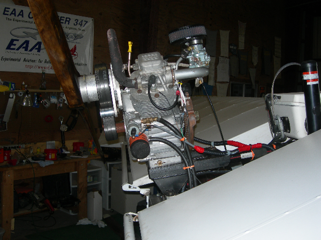

Kolb Folks,
I have a K&N filter on my carb, mounted horizontal (see photo). Last summer someone mentioned I may get better performance by turning the filter 90 deg. into the windstream and going with the conical-style K&N filter common to the 912's. I have been looking long and hard for a 90 deg adapter or boot, but have not located one. I could fab one up, but would rather find one already made if I can. Anyone out there know a source for such an animal?
Thanks -
Jimmy Y

PostPosted: Sun Apr 19, 2009 1:39 pm    Post subject: source for 90 deg. air filter boot? Reply with quote
Jimmy Y
PVC, ruber hose, and hose clamps.
Or, go to a parts store. Ask if you can go behind the counter and look for
a radiator hose that has the correct size and bend you are looking for.
That is how I obtained most of the coolant hoses for my 912.

PostPosted: Sun Apr 19, 2009 1:55 pm    Post subject: Re: source for 90 deg. air filter boot? Reply with quote
>>PVC, rubber hose, and hose clamps.<<
Thanks - that's so obvious, I'm embarrassed I made the post.

PostPosted: Sun Apr 19, 2009 2:18 pm    Post subject: source for 90 deg. air filter boot? Reply with quote
Jimmy C
  There are several companies on eBay the sell intercooler tubing kits.  Some of these companies also sell the individual parts C....like the silicone 90 degree elbows.  If you do a intercooler tubing search on eBay C you can find these outfits.
  I have many of the aluminum tubes and silicone fitting left over from my turbocharger installation.
  BTW C the clamps that came with my kit were almost certified aircraft quality!!  Surprisingly nice stuff!
  Exactly what size tubing or elbow are you looking for?  I may have it in my left over box.  I have lots of thinwall 2" tubes and several silicone fittings.

PostPosted: Sun Apr 19, 2009 3:23 pm    Post subject: Re: source for 90 deg. air filter boot? Reply with quote
Mike Welch wrote:
>Exactly what size tubing or elbow are you looking for?? <
Mike,
I need a 2" i.d. elbow. If it's thin wall material, the K&N filter will probably stretch over it without having to use a reducer. I'll email you off-line to follow up, and thanks for the offer. Very Happy
