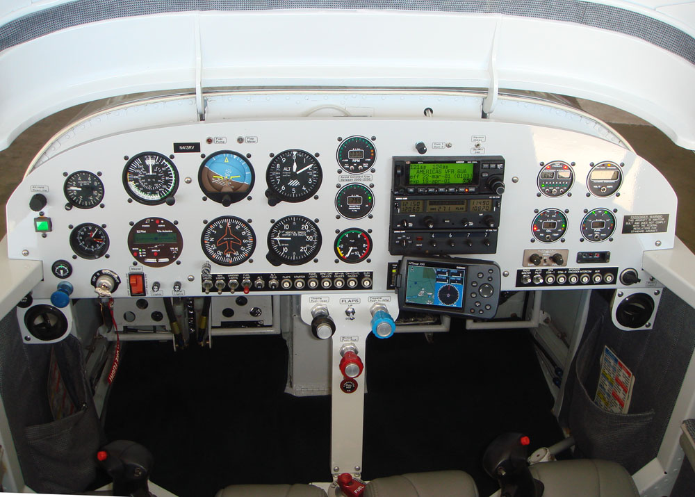

http://painttheweb.com/painttheweb/rv-6a/Exterior.aspx
See side photos of fiberglass strap (carbon fiber in my case) transition from front of tip up to rear windows.

Robin's pictures are excellent.  My Targa strip looks the same, here is a low res picture:
http://N4VY.RotaryRoster.net
I used only regular fiberglass (not carbon fiber)..  but it still flys  Wink

PostPosted: Thu Apr 16, 2009 11:28 am    Post subject: Broken Canopy Corner Reply with quote
I used carbon fiber as a replacement stiffener to the fiberglass only after my shocks got tired and my canopy did not go fully up and I hit my head on the corner of the Targa corner while climbing in. No damage to my head but a really nice crack on the fiberglass Targa corner causing me much angst to repair & repaint. I think I would have preferred a crack in my head and not the Targa strip. IMHO the tip ups don’t look finished w/o the Targa strip.
Since we are on the subject of finish work on a tip up. Another nice feature on my 6A is the fiberglass cover to the underside of the tip un just above the avionics.

PostPosted: Thu Apr 16, 2009 12:42 pm    Post subject: Broken Canopy Corner Reply with quote
Robin,  Nice job.  Do you have anything to cover Avionics from rain getting in?  I velcro'd some sailcloth into place to direct it away from stuff.  Greg

PostPosted: Thu Apr 16, 2009 2:20 pm    Post subject: Broken Canopy Corner Reply with quote
The short answer is no. I have a hangar in moth of my commute locations plus a canopy cover that protects the entire hinge area. Plus I have some compressible door seal material (D shaped [pictured]) to keep rain / moisture out in general. I am sure others have done much more to prevent water / moisture from entering this area including you good idea of sail cloth. To date I have had no issues.
