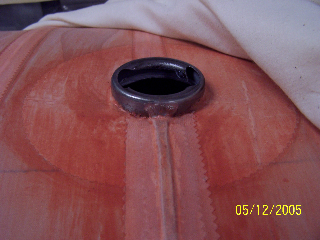

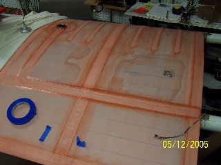

I can offer what I did on my plane during the building. I soldered a
1/4" wide tinned and braided copper strap to the filler neck, ran it
back and across to the rear spar, and attached it to the rear spar
mounting bolt. I covered the strap with finishing tape.

On my Kitfox, I have fiberglass tanks with rubber fuel hoses, so
grounding the outside of the tank itself would not do anything, it
would take a wire or piece of metal going into the fuel tank to
make an effective ground. Can you elaborate a little more on the
grounding setup you are proposing for Kitfoxes ?

I came up with the idea of running a strap from my filler neck to the
airframe after reading a discussion here on the list. I got a lot of
my (sometimes hair-brained) ideas as a result of reading here early
on. Of course, if someone had said that a heavy plane would handle
better, I'd probably put concrete in the tires...what do I know? : )

Lynn,
I really like what you did, but since my Fox is already covered, I just take the ground wire from the pump station and clip it to the metal filler. All we can protect is an arcing across the tank inlet anyway. Won't that work?
