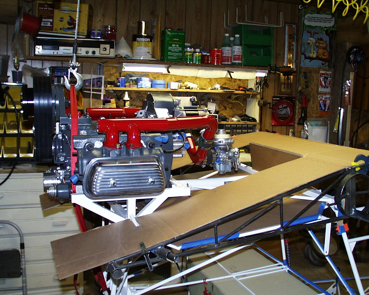

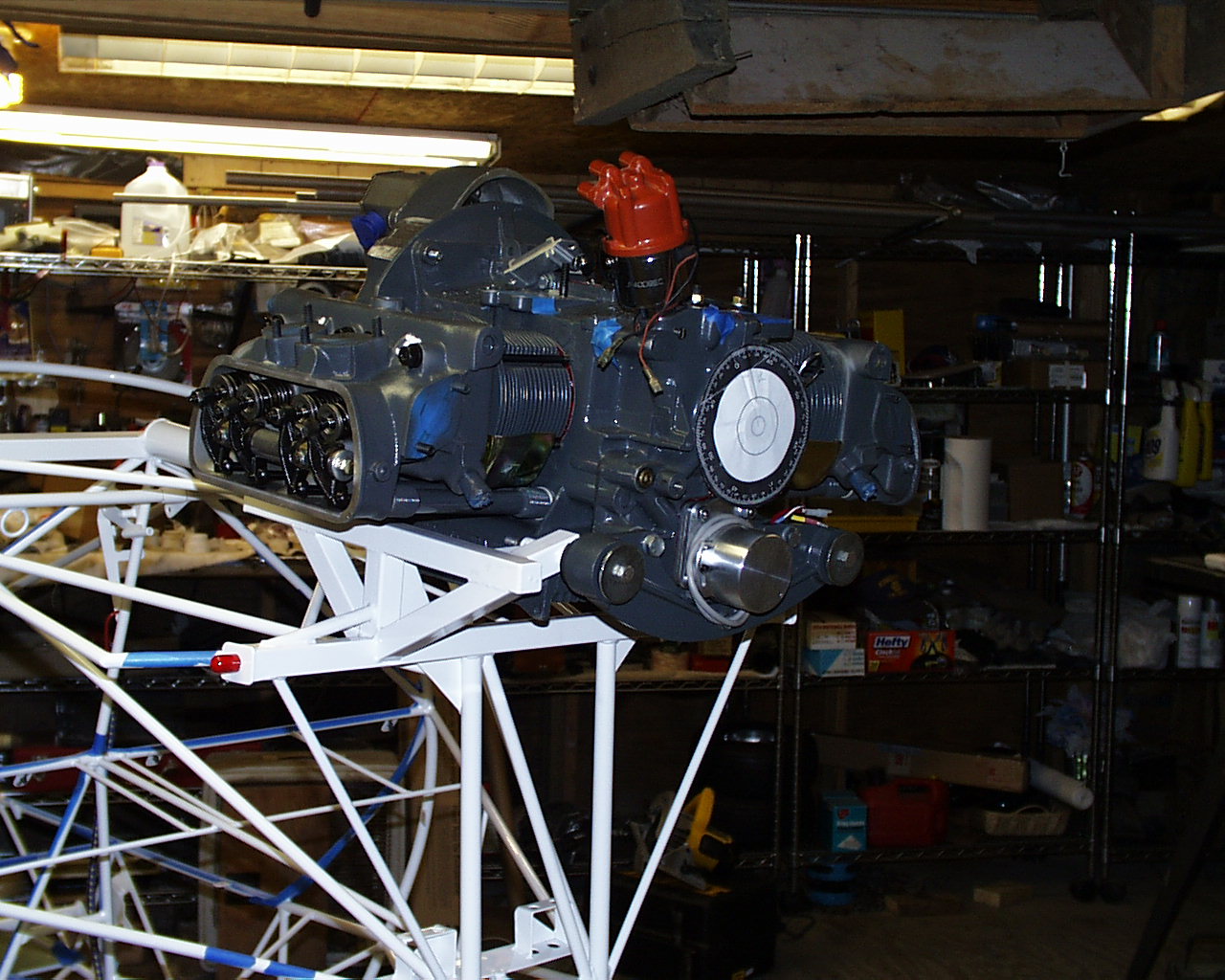

The engine Great Plains offers is probably the way to go. The owner, Steve, has a good background on these engines and can offer most anything you'll need to make the engine perform. He is also presently working on his own version of the water cooled heads. Attached is a picture of my engine that I'm fitting up on my MXIII. The re-drive is a must for good performance and is well made. It cost around $1600.00. You will engine up with a good engine that should perform on your Kolb at only 1/3 the price of a Rotax, especially if you go with the water cooled heads.

PostPosted: Sat Apr 11, 2009 8:31 am    Post subject: V.W.conversion Reply with quote
Hi Rick.
good pictures . Who makes your redrive? Thanks for answering my
question.
Frank Goodnight
