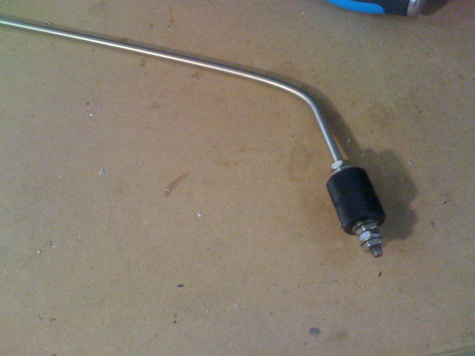

Hi All
Attached is a picture of my COM antenna. To be mounted in the reinforced portion of the turtledeck on the upper rear of the Baggage area on my Zenith 601XL
Question is How do I hook it up?? Crimp a ring terminal on to the center conductor of the RG-400 and attach that with the nut to the bottom of the antenna, and attach another ring terminal to the shield and connect it to WHERE???
Help me or gurus of the RF
Larry
Com Antenna

It's not the best we know how to do, but if you're dead-set on this
device...
Strip the outer jacket off the RG-400 and un-braid the shield. Pull the
shield wire to one side, twist and crimp on a terminal. Attach the shield
to a screw thru the aircraft skin near the antenna base.
Antennas similar to the COMANT CI-122 are much more user-friendly.

Larry,
The RG-400 has an insulated solid core wire that uses a particular connector
as explained in the AeroElectric manual. The antenna that you show uses a
ring terminal for attachment. Better ask Bob on this one.

The shield wire should connect to the skin (that will serve as your ground plane) somewhere close & convenient to the antenna. You could make your reinforcement plate big enough to bend a tab on one edge, or add a tab under one of the rivets, to bolt the shield eyelet to. Just be sure that you have good electrical contact from shield-eyelet-bolt-tab-doubler-skin. If you don't mind an extra connector showing, use a screw through the skin-ring terminal to reduce odds of ground loss.

At 10:36 PM 4/11/2009, you wrote:
Hi All
This style of antenna was used in QUANTITY at Cessna and
other single engine aircraft way back when. By "way back"
I mean the times when these radios were the best we knew
how to do.
http://aeroelectric.com/Pictures/Radios/P1012765.JPG
http://aeroelectric.com/Pictures/Radios/P1012780.JPG
The antennas fell in disfavor mostly because they were
difficult to keep stationary. They would "spin" in the
insulator and often break the center conductor connection.
Secondly, they were labor intensive to install compared
to their factory built descendants. About the time
these radios . . .
http://aeroelectric.com/Pictures/Radios/P1012763.JPG
were the best we knew how to do, the single whisker
mounted on a ceramic feed-thru was pretty much
history. You can still buy this style antenna. Several
versions offer a large ring terminal to install under
the skin and over the hole that mounts the antenna
insulator. Definitely NOT gas-tight to the skin.
If your kit came with this terminal, pitch the
terminal.
I've been fiddling with a DIY comm antenna fabrication
technique that ends up with a base that looks like this.
http://aeroelectric.com/Pictures/Antenna/DIY_Comm_Antenna.jpg
The materials are common hardware and CB radio accessory
store items. This design offers a coax connector to
attache the feed line, good anti-rotation features by
virtue of the two screws through grounding tabs and
the opportunity to get a gas-tight ground connection
(#8 screws tightened down really good).
For your application, consider the technique shown
here:
http://aeroelectric.com/Pictures/Antenna/Figure_13-8.pdf
Prepare your coax connections thusly:
http://aeroelectric.com/articles/shldwire/shldwire.html
Make the shortest practical connection between
the antenna and coax . . . i.e. minimize length
of exposed center conductor and braid pigtail.
SWR of antenna installed thusly? Adequate. Performance?
Also adequate. Cost of ownership? Remains to be seen.
These have the potential for being more problematic
than their modern factory built counterparts.

Oh yeah. Larry, be sure to use RG400 for this
install, it has a stranded center conductor.
RG142 is identical in performance but has a
solid center conductor.
Thank's for reminding me Mike!
