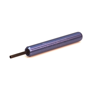

Anyone know where I can get a high quality Molex - AMP "Mate-n-Lock pin extraction tool as sold by Steinair?
I have the blue and white tool as sold by Stein and Spruce but it is not the right tool. Need to do battle with keep on rebending it and once in a while lose a pin.
I have universal tool from Spruce but largest insert it is not big enough.
Radio Shack cheap extraction tool works great for their connectors but it is too small for Steins.
I saw on EAA instructional video a tool that looked like a blue anodized aluminium handle with a stout insert.

there's a whole fist-full of tools for the Mate-n-Lok
series connectors. Further, be sure you're not really
looking for a Waldom/Molex tool. Lots of folks mistake
the W/M parts for Tyco-Amp.
Your description of a "blue anodized tool" reminds me
of this critter:
[img]cid:.0[/img]
This is the Molex 11-03-0006 for the larger, .093 power
pins which are 'close' to Tyco-Amp Mate-n-Lok but no
cigar. The smaller .062 power pin tool is red. But
Digikey will have the tool you need once you figure out
which connectors you're working with.
