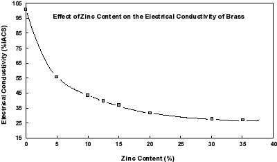

Just to be sure we understand the science correctly….
Contrary to the direct relationship between composition and conductivity implied in your message, the effect on electrical conductivity of trace elements and alloying elements is significant for any of the usual metals used as conductors (Ag, Al, and Cu), and in the case of brass here’s how conductivity changes with the addition of zinc.
A mere 1% of tin (in the absence of any other elements besides Cu) will reduce conductivity by about 50%.
Your conclusion is of course correct. In this case brass is as good as pure copper.
