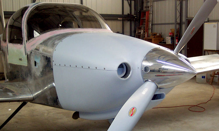

Here is a glimpse of how the SkyBolts look on a -10 (SJ) cowl. Pins definitely look cleaner. SB's are more industrial looking. Since we are not discussing costs I won’t mention that my 6A uses $0.05 S/S screws that work as well as SkyBolts.
Robin
 Filesize:  498.78 KB
 Viewed:  6879 Time(s)
