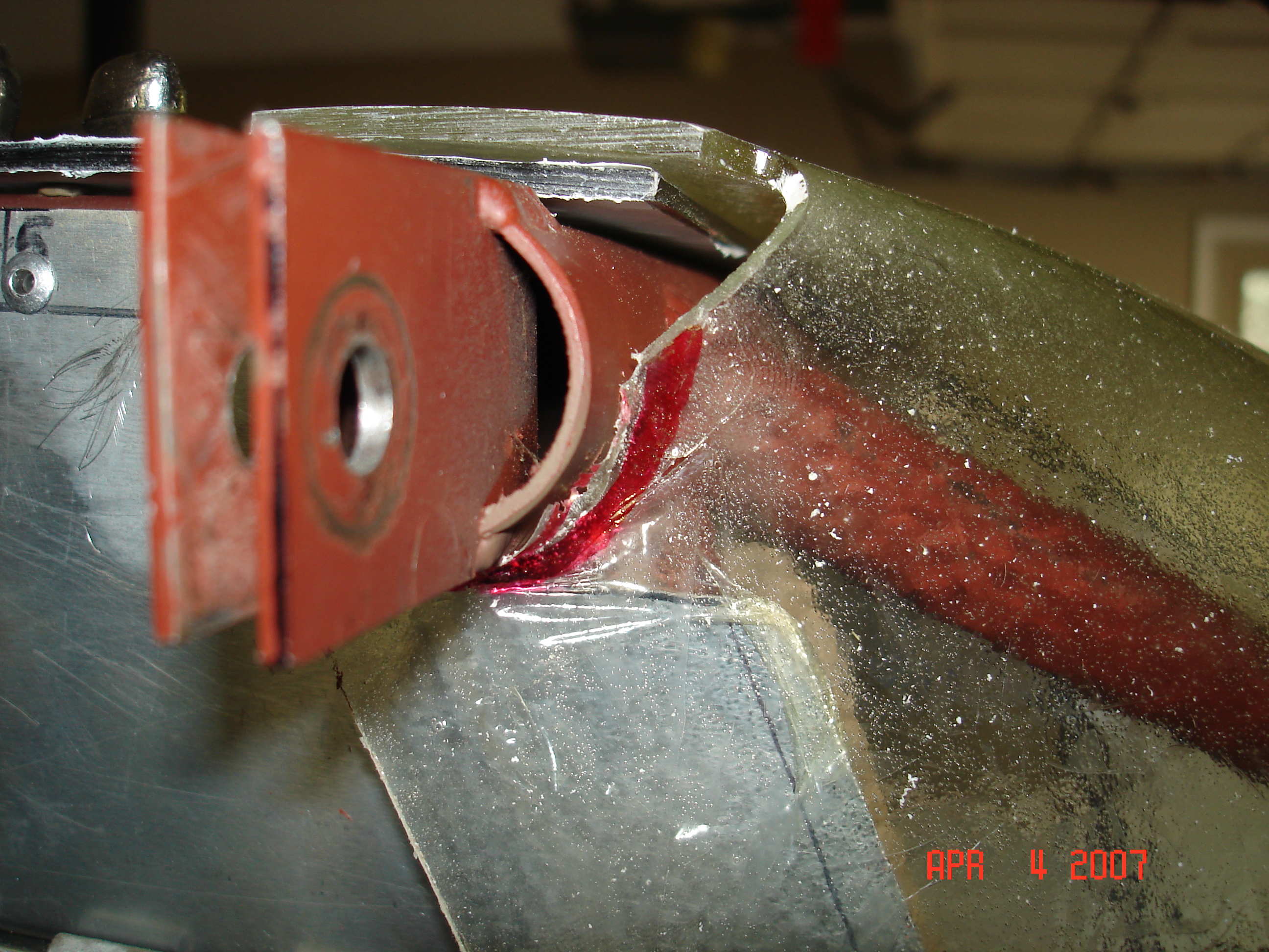

PostPosted: Thu Apr 09, 2009 3:25 am    Post subject: Re: Top window installation Reply with quote
Doug,
There's not a lot of info available on the top window installation.
I'm attaching a picture (I hope) of how the top window sits on top of the cabin frame underneath the windshield lip. We used a seam of acrylic (or some such) to seal the area. No drilling in the top cabin frame.
Hope this helps
Tommy Walker in Alabama
