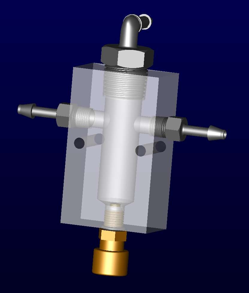

A subject of current personal interest to me, since it was my friends who
were badly injured in the MKIII crash last fall due to water in the fuel
(the plane had no sump or gascolator). It just so happens that I'm making
a simple small gascolator right now, with a clear bowl, drain valve, two
inlets, and no filter (I have a separate fuel filter in the line). Once
it's done I'll post more information on it.
-Dana

OK, here's my new transparent gascolator. As I've said, I don't want a large heavy expensive aircraft gascolator for my ultralight, don't want a cheap glass tractor gascolator with no drain, either, but I do want to be able to see what's inside... so I made my own (see attached picture).
Basically, it's a 3" x 1.75" x 1" polycarbonate block with nylon fittings and a Saf-Air drain valve. No filter, since I also have an inline filter. It's not on the plane yet, but it's sitting on my workbench filled with gas/oil mix as a final chemical compatibility check.
-Dana

JetPilot
Posts: 1246
PostPosted: Fri Apr 03, 2009 8:41 pm    Post subject: Re: Transparent gascolator with drain valve Reply with quote
Dana
That is quite a nice rendering of your gascolator, what program did you use to make that picture ? That should be great, given that you check your plastic tanks anyways, you will probably never get more than a trace of water in your system. The biggest problem is, most f us don't have the materials and ability to make a gascolator, I suppose I could build one, but it would take so much time and effort, probably days, that I am better off to spend the 80 bucks. The one from Aircraft Spruce weights only about 8 ounces, and not so big that it would look out of place on an ultralight.
The important thing is that we have a gascolator. As in the case of the outside airplane, the gascolator saved a failed engine by keeping a bunch of water rather then sending it to the carbs. A gascolator is also useful for getting any small solid debris out finds its way into the lines.
Mike
