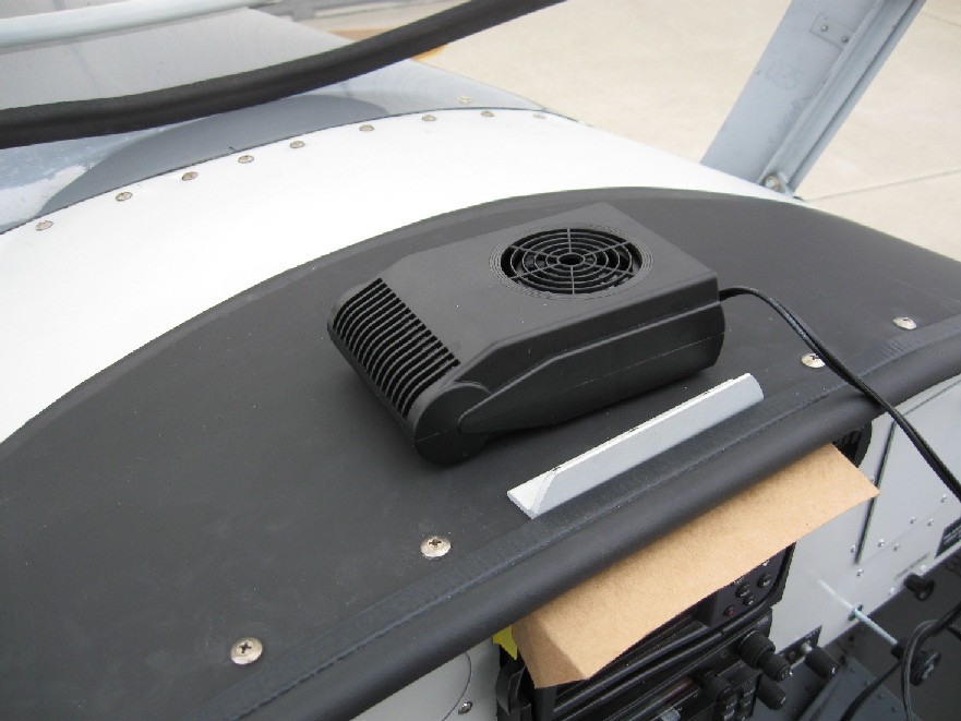

I did some flying this winter with OAT's in the mid to upper 30's and on the ground during taxi is where I experienced canopy fogging. In-flight, I had no problems with the fog clearing up even though I only have the one hole for heat in the lower firewall. I bought a 100W 12VDC portable car de-froster unit that plugs into a cigarette lighter for taxiing. I sit it on top my panel until ready for takeoff when I un-plug and stow it. It is a very light unit and only uses the equivalent power of a landing light. Picture attached.

Hi DaveG601XL, I like the look of the top of your dash.Where did you source the edge rubber? and what material is the black anti-glare ?Like the sun visor for the EFIS/GPS Cheers Alan

The glare shield edging in automotive trunk seal. I actually got mine from Zenith, but I have seen the same thing sold in various on-line dealers like JC Whitney. The anti-glare paint is Rust-o-leum flat black.

Try this for the trim, they also have all metal and all rubber trim. This and the type Dave used, has metal in the U shaped part that covers the sheet AL. This makes it less of a cutting edge, in my way of thinking.
http://www.mcmaster.com/#trim-seals/=1bqah2
