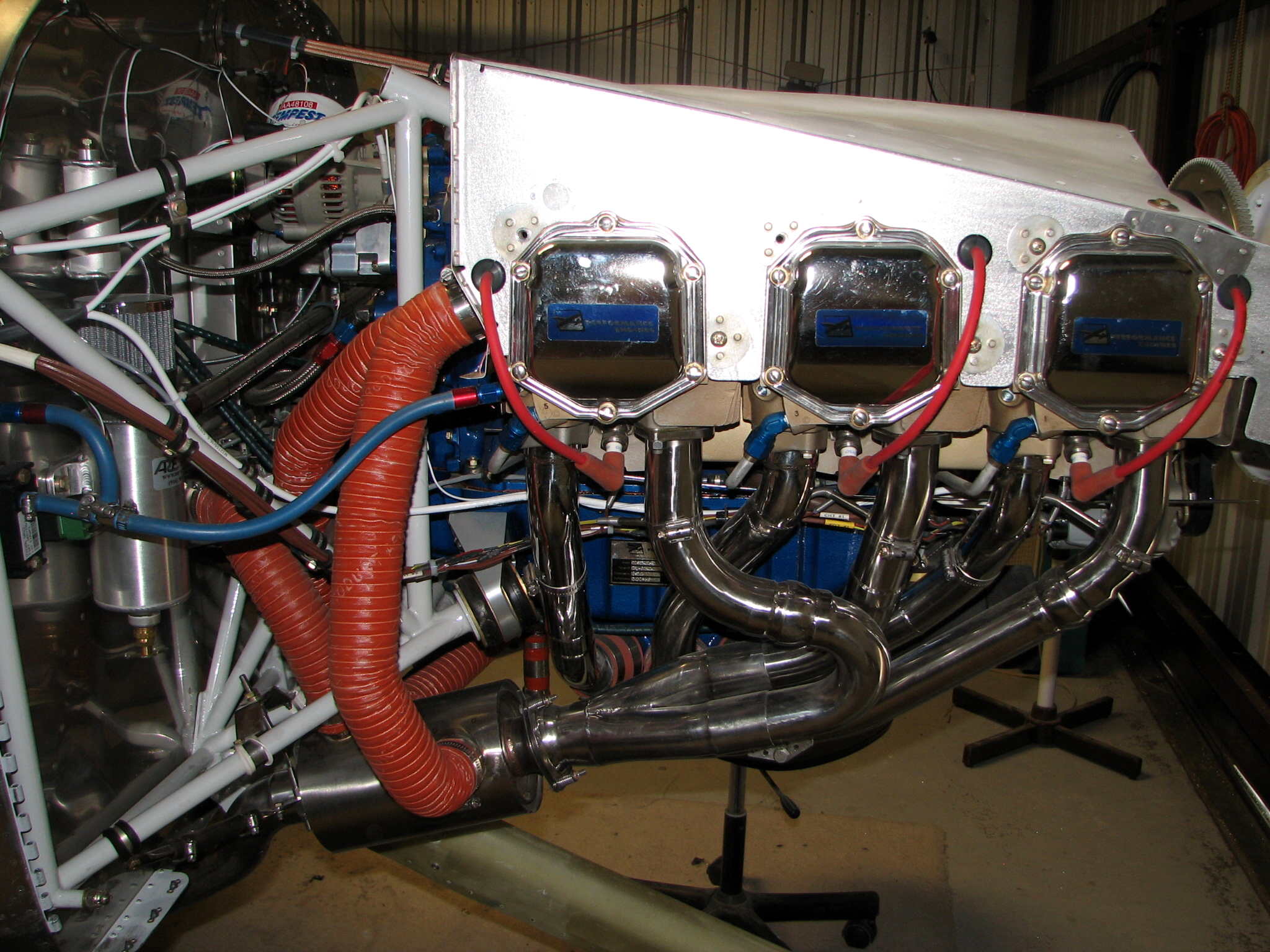

I have the AFS3500 EGT kit. Any suggestions or better yet pictures of the final installed position of the sensors?
I was told to install 2" out from the flange on the engine. I am worried about the clocking so that the wire ends do not interfere with the cowling.
Any suggestions, comments and pictures appreciated

Tim Olson
Joined: 25 Jan 2007
Posts: 2882
PostPosted: Fri Apr 03, 2009 3:20 am    Post subject: EGT Sensors installation and clocking Reply with quote
Make sure as you set them up you also have your plugs and wires in
place so you don't interfere there. If you do that and then clock
them as low profile as possible you should be ok.
Tim

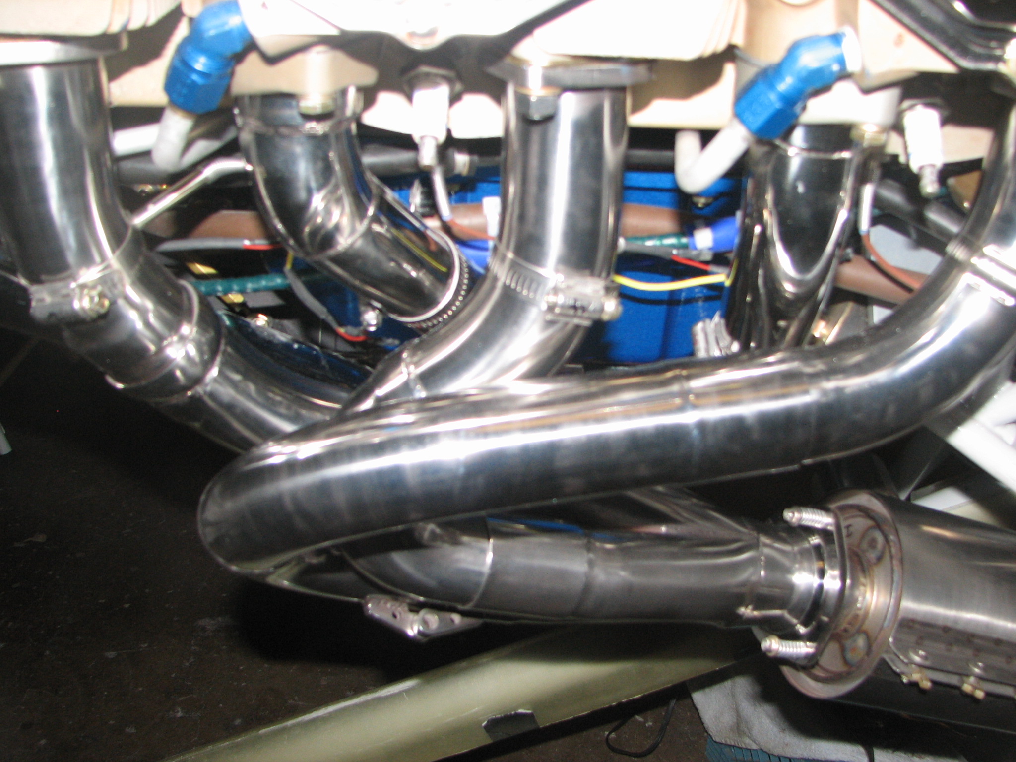

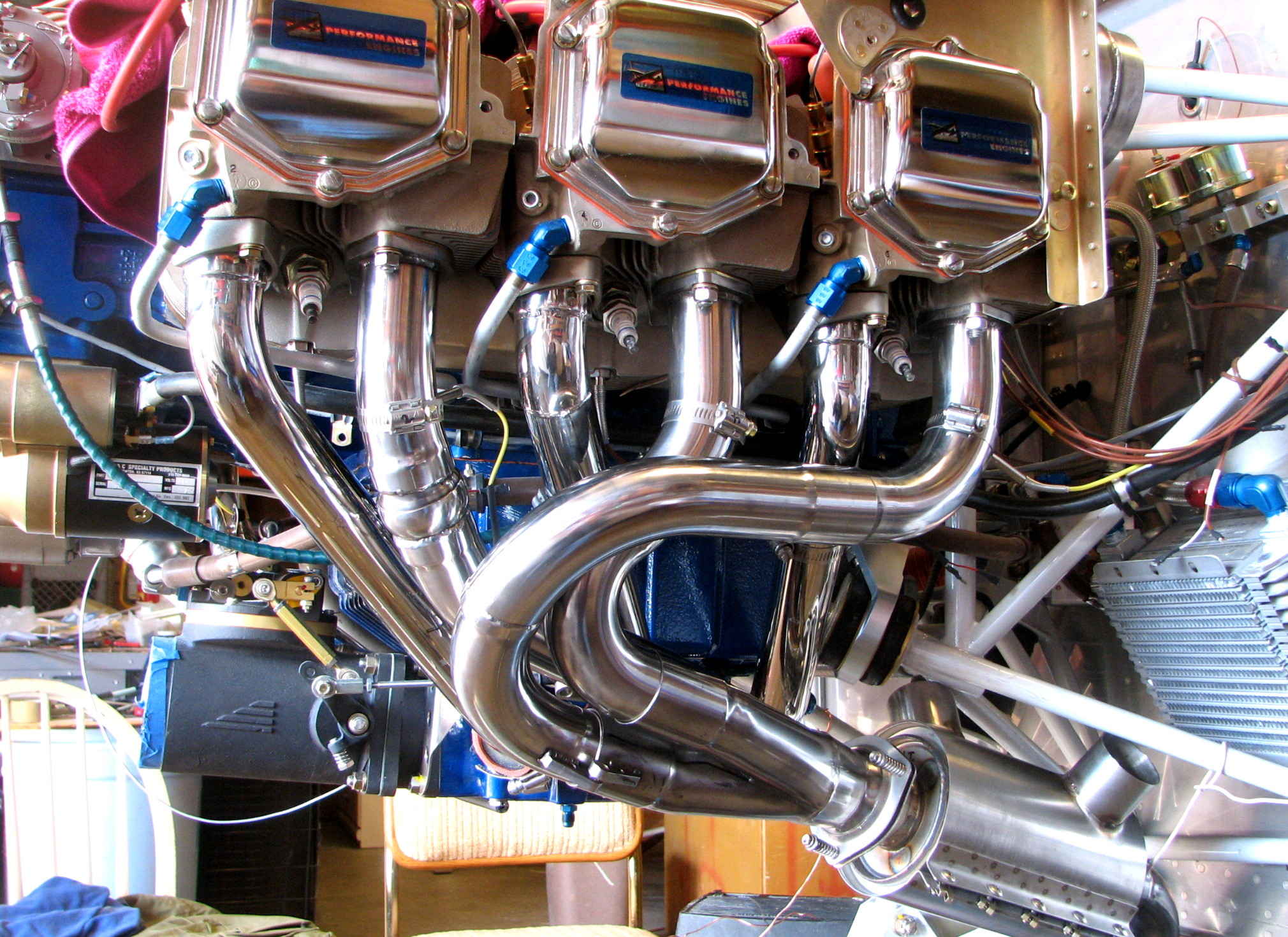

PostPosted: Fri Apr 03, 2009 6:52 am    Post subject: EGT Sensors installation and clocking Reply with quote
Mike;
How soon do you need pics.? I have the same setup. I can pull the
cowling this weekend and take a few pics if that would help.

PostPosted: Fri Apr 03, 2009 7:18 am    Post subject: EGT Sensors installation and clocking Reply with quote
Can't remember exactly what distance was recommended (2"-4"?), but I believe the critical element is to make them all the same. I think mine are 3"... Make sure you measure the inside radius of the pipe and make a mark, and then the outside of the radius of the pipe and make another mark. Then figure where the sensor needs to be to clear everything (plugs, wires, etc), and then draw a line between those tow marks. I kept mine to the inside thus avoiding the cowl problem.
Don McDonald

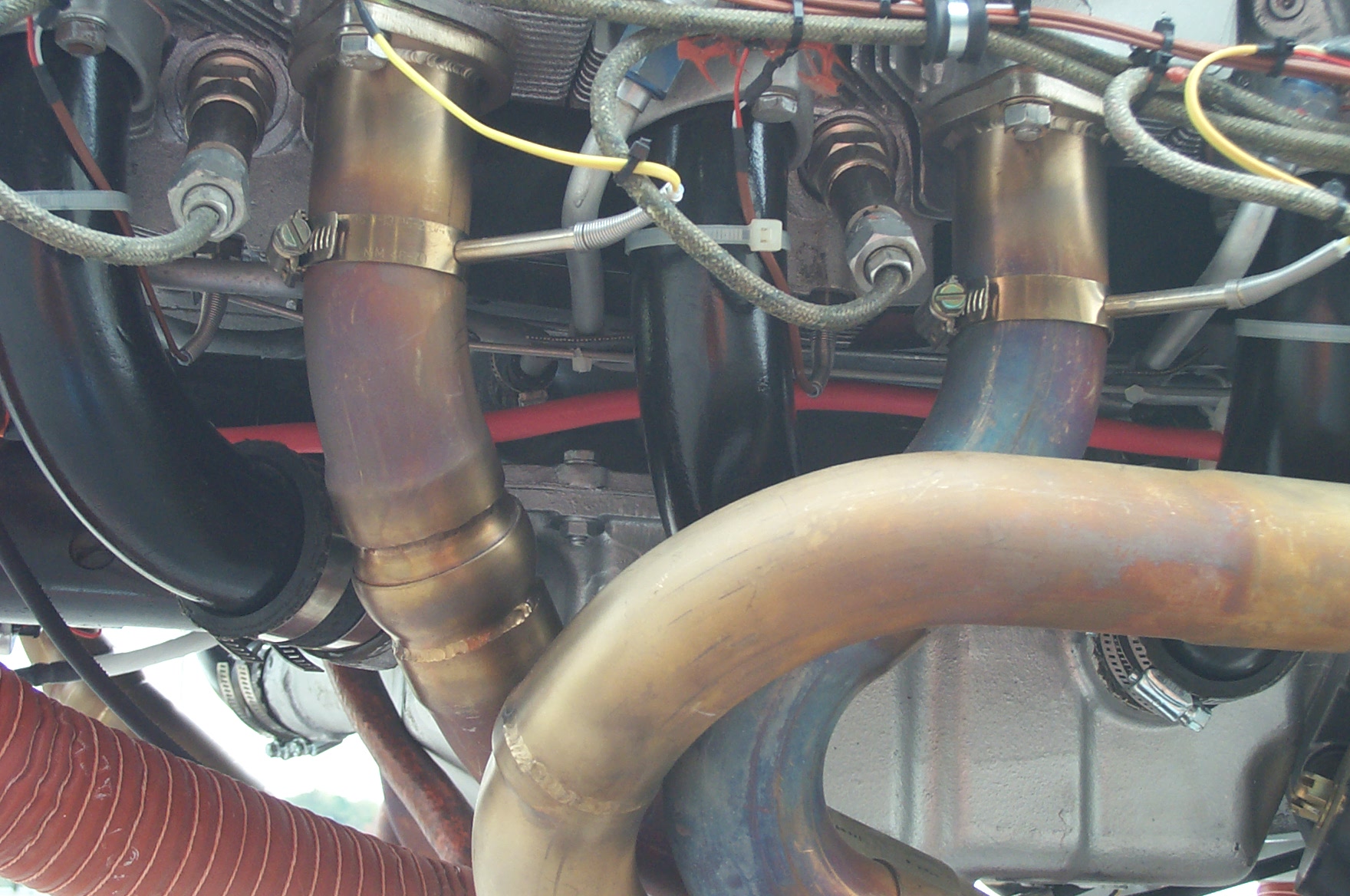

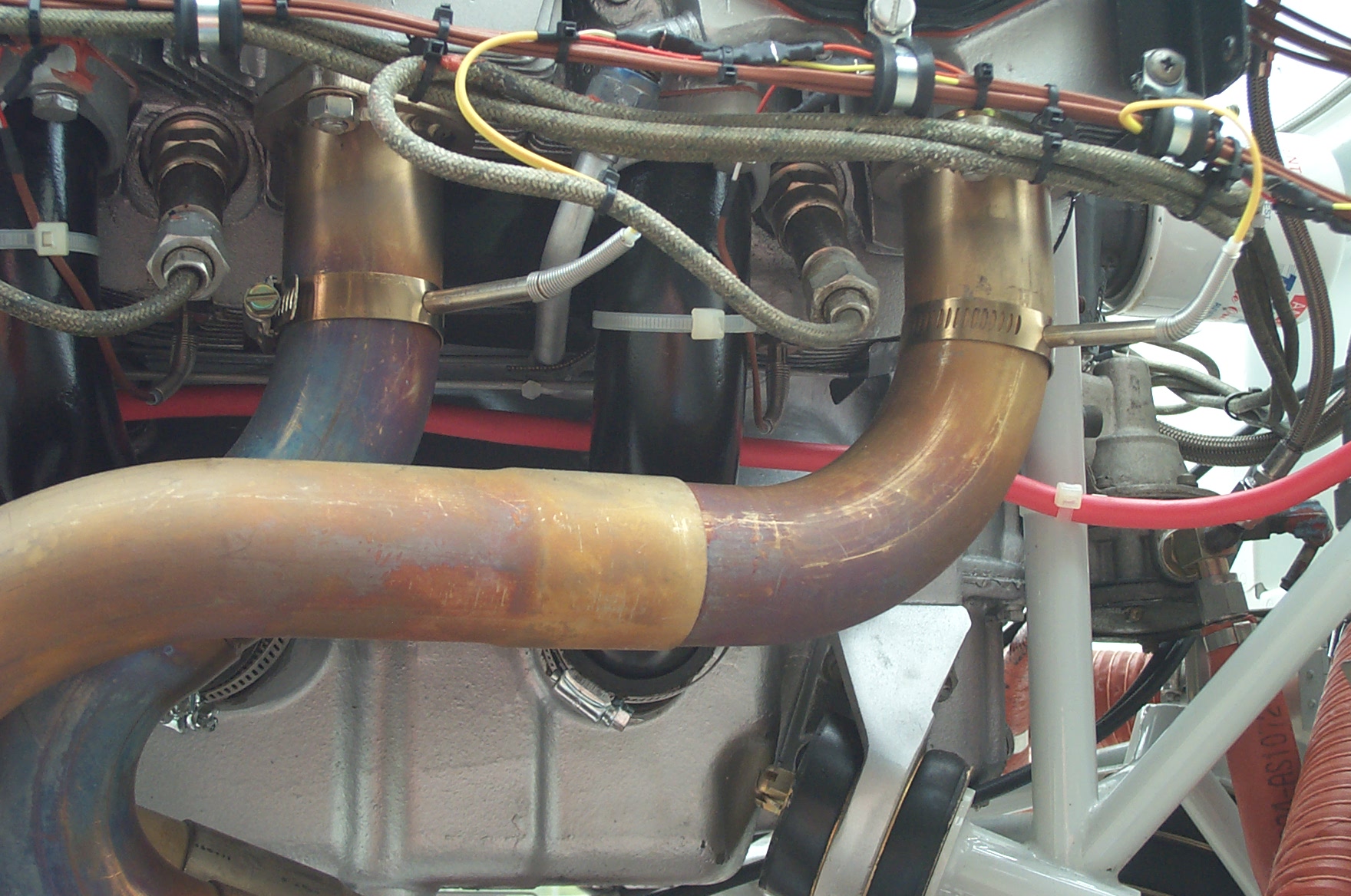

PostPosted: Fri Apr 03, 2009 5:37 pm    Post subject: EGT Sensors installation and clocking Reply with quote
Here is the left side of my installation. Picture xx35 is the front / middle pipes, xx34 is the middle and rear cylinders. I used the same clocking on the other side (leads go toward the prop).Jim CN312F - Flying (40192)Do Not Archive--> RV10-List message posted by: "AirMike" <Mikeabel(at)Pacbell.net>I have the AFS3500 EGT kit. Any suggestions or better yet pictures of thefinal installed position of the sensors?I was told to install 2" out from the flange on the engine. I am worriedabout the clocking so that the wire ends do not interfere with thecowling.Any suggestions, comments and pictures appreciated--------OSH '08 or Bust (busted) be there in &quot;09Q/B Kit - wiring and FWFRead this topic online here:http://forums.matronics.com/viewtopic.php?p 37488#237488
 Filesize:  440.32 KB
 Viewed:  8470 Time(s)
 Filesize:  407.2 KB

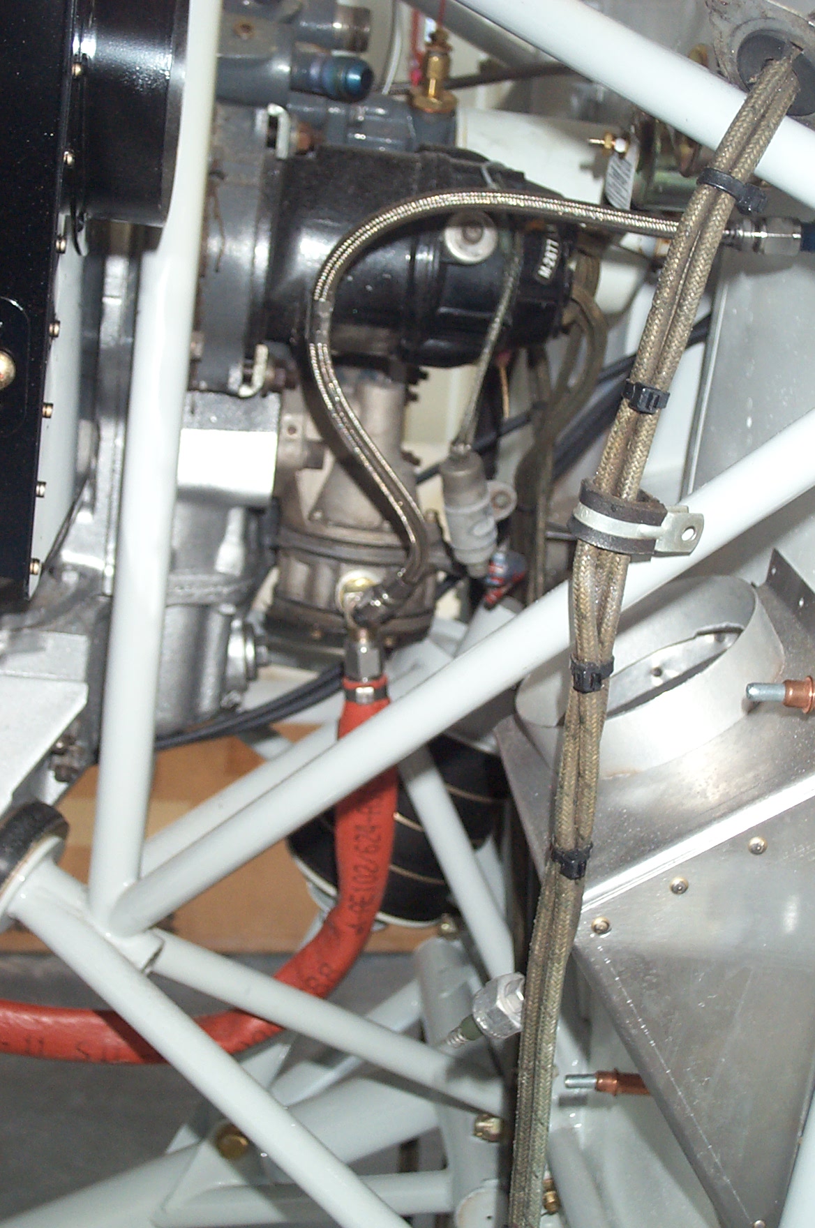

Jim C

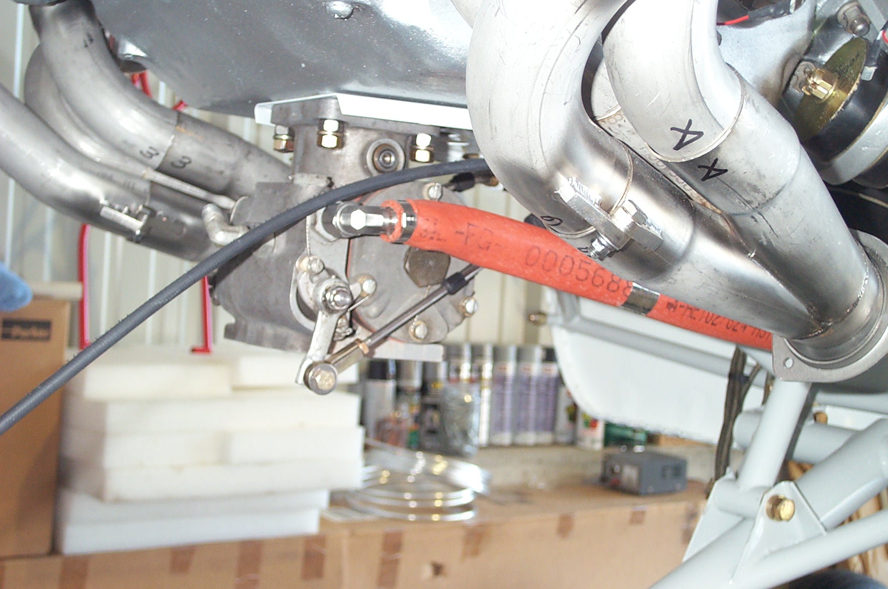

Do you ( or anyone else) have a photo of the area about 6" under the pictures you sent? I'm trying to figure out the best routing for the fuel line from the mechanical fuel pump to the Bendix servo to get it away from the exhaust.
Thanks C

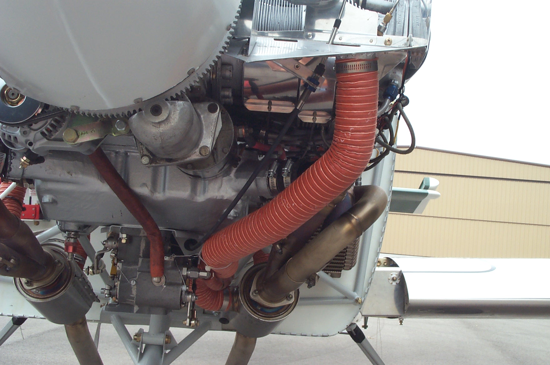

PostPosted: Sun Apr 05, 2009 3:44 am    Post subject: EGT Sensors installation and clocking Reply with quote
Vern,Here is a front view from the front. There is a right angle fitting at the fuel servo and the line runs along side it back to the fuel pump. The DAR suggested and helped me attach the scat tubing to the fuel line for the same reason. Get it away from the exhaust.Jim CombsN312F - Flying (50+ hours)40192-------------------------------------------------------------------------------------------------------------------Jim,Do you ( or anyone else) have a photo of the area about 6" under thepictures you sent? I'm trying to figure out the best routing for the fuelline from the mechanical fuel pump to the Bendix servo to get it away fromthe exhaust.Thanks,Vern Smith (#324 finishing)do not archiveDate: Fri, 3 Apr 2009 21:35:28 -0400Subject: Re: EGT Sensors installation and clockingFrom: jim(at)CombsFive.ComTo: rv10-list(at)matronics.comHere is the left side of my installation. Picture xx35 is the front/ middle pipes, xx34 is the middle and rear cylinders. I used thesame clocking on the other side (leads go toward the prop).JimCN312F - Flying (40192)Do Not Archive-->RV10-List message posted by: "AirMike"<Mikeabel(at)Pacbell.net>I have the AFS3500 EGT kit. Anysuggestions or better yet pictures of thefinal installed position ofthe sensors?I was told to install 2" out from the flangeon the engine. I am worriedabout the clocking so that the wire endsdo not interfere with thecowling.Any suggestions,comments and pictures appreciated--------OSH '08 or Bust(busted) be there in &quot;09Q/B Kit - wiring and FWFRead this topic online here:http://forums.matronics.com/viewtopic.php?p 37488#237488_________________________________________________________________Rediscover Hotmail®: Now available on your iPhone or BlackBerryhttp://windowslive.com/RediscoverHotmail?ocid=TXT_TAGLM_WL_HM_Rediscover_Mobile1_042009
 Filesize:  353.12 KB

PostPosted: Sun Apr 05, 2009 3:57 am    Post subject: EGT Sensors installation and clocking Reply with quote
VErn,Here are a couple more.Jim CombsN312F - Flying----------------------------------------------------------------------------------------------Jim,Do you ( or anyone else) have a photo of the area about 6" under thepictures you sent? I'm trying to figure out the best routing for the fuelline from the mechanical fuel pump to the Bendix servo to get it away fromthe exhaust.Thanks,Vern Smith (#324 finishing)do not archiveDate: Fri, 3 Apr 2009 21:35:28 -0400Subject: Re: EGT Sensors installation and clockingFrom: jim(at)CombsFive.ComTo: rv10-list(at)matronics.comHere is the left side of my installation. Picture xx35 is the front/ middle pipes, xx34 is the middle and rear cylinders. I used thesame clocking on the other side (leads go toward the prop).JimCN312F - Flying (40192)Do Not Archive-->RV10-List message posted by: "AirMike"<Mikeabel(at)Pacbell.net>I have the AFS3500 EGT kit. Anysuggestions or better yet pictures of thefinal installed position ofthe sensors?I was told to install 2" out from the flangeon the engine. I am worriedabout the clocking so that the wire endsdo not interfere with thecowling.Any suggestions,comments and pictures appreciated--------OSH '08 or Bust(busted) be there in &quot;09Q/B Kit - wiring and FWFRead this topic online here:http://forums.matronics.com/viewtopic.php?p 37488#237488_________________________________________________________________Rediscover Hotmail®: Now available on your iPhone or BlackBerryhttp://windowslive.com/RediscoverHotmail?ocid=TXT_TAGLM_WL_HM_Rediscover_Mobile1_042009
 Filesize:  434.76 KB
 Viewed:  8451 Time(s)
 Filesize:  380.1 KB

planesmith(at)hotmail.com
PostPosted: Sun Apr 05, 2009 10:00 am    Post subject: EGT Sensors installation and clocking Reply with quote
Jim C
Thank you for the pictures. They are just what I needed.
Vern
