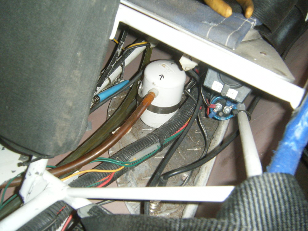

PostPosted: Sat Apr 04, 2009 9:33 am    Post subject: non-transparent gascolator Reply with quote
 Filesize:  152.25 KB
 Viewed:  4111 Time(s)
