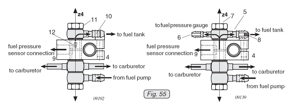

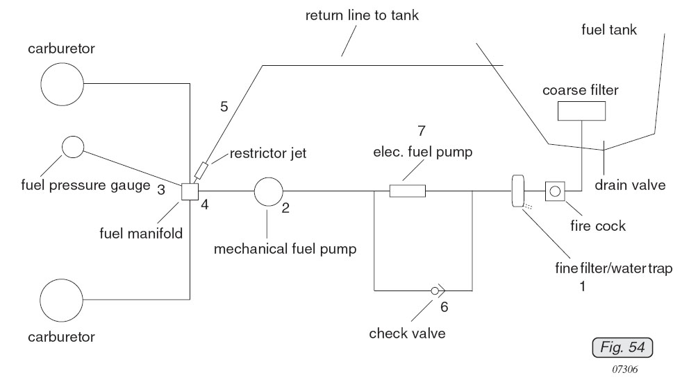

PostPosted: Wed Apr 01, 2009 2:20 pm    Post subject: Vapor Lock and E-10 mogas Reply with quote
Which SBs talk about return lines? I see information in the installation
manual but a quick search through the SBs on rotaxowner.com didn't show any.
-- Craig
- The Matronics RotaxEngines-List Email Forum -
http://www.matronics.com/Navigator?RotaxEngines-List
trigo(at)mail.telepac.pt
PostPosted: Wed Apr 01, 2009 2:38 pm    Post subject: Vapor Lock and E-10 mogas Reply with quote
And where are the return lines connected from?
Carlos
[quote] --
craig(at)craigandjean.com
PostPosted: Wed Apr 01, 2009 3:03 pm    Post subject: Vapor Lock and E-10 mogas Reply with quote
In the stock engine the fuel return line connects to a banjo bolt with a restrictor on the fuel manifold that clamps to the balance tube between the carbs. I’ve attached two figures from the 912 installation manual (Edition 1 /Rev. 0, May 01/2007). If Matronics doesn’t pass them through let me know and I’ll mail them directly to you.
-- Craig
From: owner-rotaxengines-list-server(at)matronics.com [mailto:owner-rotaxengines-list-server(at)matronics.com] On Behalf Of Carlos Trigo
Sent: Wednesday, April 01, 2009 4:37 PM
To: rotaxengines-list(at)matronics.com
Subject: RE: Re: Vapor Lock and E-10 mogas
Carlos
[quote] --

Roger Lee
Posts: 1464
Location: Tucson, Az.
PostPosted: Wed Apr 01, 2009 5:29 pm    Post subject: Re: Vapor Lock and E-10 mogas Reply with quote
Hi Craig and Ira,
Looks like you guys are on top of it. The return lines are very easy to install. Many just return to a gasolator like many of the SLSA's and ELSA's or back to a header tank if you don't have a gasolator.
p.s.
Don't forget to put your fuel line in fire sleeve and dip the ends of the fire sleeve, plus you should be using band clamps (Otiker is one type and easy to use) and not worm drive clamps.
There is no return line specific SB. It is in the installation manual. Even though there is not an SB you should be keeping up on manual changes for your engine health and your personal safety. Your right that many of the older engines were put in homebuilt's and many didn't have them under cowl, but of course some did. It didn't seem to be a big issue many years ago (but we learned), but todays planes, the way we fly and where we fly has changed, fuels are changing and finally our knowledge is catching up. You brought up owners doing the work and that's perfectly ok, but some do it wrong for a number of reasons, but all should take a Rotax class and do it right.
Rotax has been manufacturing the 912 since late 1989 and it has had 4K changes since then. Some very small or minor and some very significant changes.
*Note*
If I ever sound like I'm being disrespectful in some way to anyone I never ever mean it that way, but in emails it is easy to get the tone of the message wrong. I enjoy helping others with problems and working with people and sometimes throw a little philosophy in along the way. I usually get at least 2 calls a day from out of state with 912 issues and people bring me their 912 engined plane's to work on from 5 or 6 different states.
*** Bottom line in all this dicusion thread is a return line is a good idea and can be found in the Installation manual.

One problem with the factory design of the fuel manifold with return line is
the difficulty of measuring fuel flow. You either:
1. Modify the factory design to place the flow transducer after the return
line and before the "T" to the two carbs (increasing the risk of vapor lock)
2. Use two (expensive) flow transducers (either on the feed and the return
or one for each carb) which places extra requirements on the instrumentation
3. Try to compensate or estimate the volume flowing through the return line
(which makes my EFIS's fuel range calculation worthless)
I just don't see a good solution. Option 2 is the safest and most expensive
(what a surprise).

The usual 912 or 912s return flow is a very small fraction of the
forward flow, in essence a slow drip. For these engines a single
Floscan works fine (if a < 5% error is OK). I use this approach.
For 914 engines the return line has always been mandatory so far as
I recall. The return flow is a much higher fraction of the forward flow
as well. Here, two floscan sensors are required with an A-B computation.

Hi Craig,
re the small resitrictor on return flow.
I suspect that it really is there to give any formed vapor a place to go
and get it out of a dangerous area!
Ira

Hi!Ira
Re:- the small restrictor....it is to control back to tank volume.(as
well as any vapour possibly) Without the restrictor on some systems the
flow back to tank will take priority so starving the carbs hence the
restrictor keeps the pressure up to the carbs.
