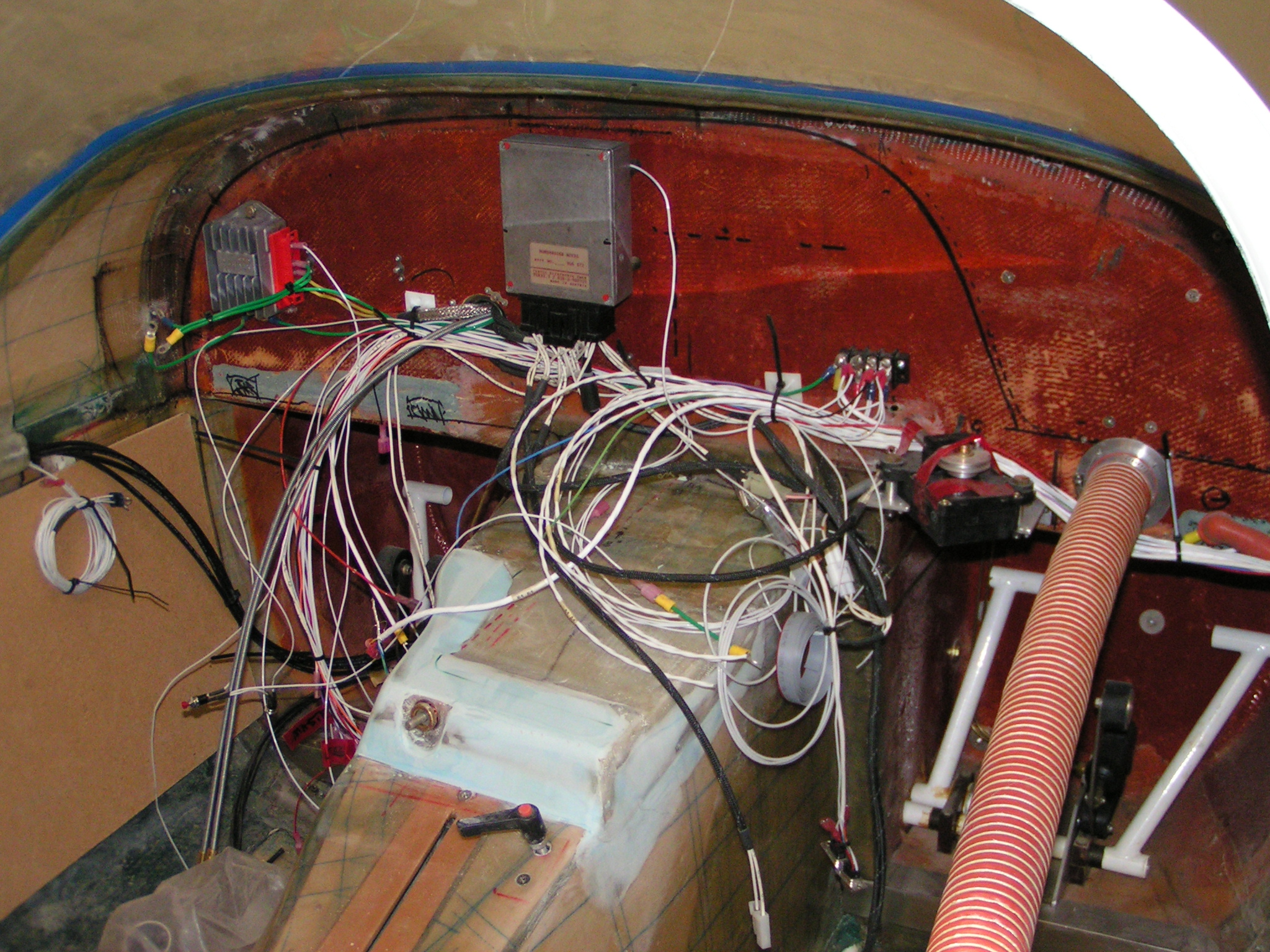

Hi All,
I am attempting to "shoe horn" in a second Grand Rapids EFIS screen into my panel which is turning into an mechanical challenge.  It is pretty much looking like I am going to have to move it to the outside of the firewall.  I know a few folks have done this and provided cooling with a blast tube.  I was wondering if anyone had some photographs and best practices to share.

Hi! Paul
I have no photos at present but have installed mine on the P1 foot well with the Ignition regulator both in an insulated lightweight box unsealed to the firewall to allow circulating cooling air to escape. I have a 1” dia. Hose picking up intake air from well in front of the radiator with a little permanent position flap “catching” air to the box.
I do not have the “gills” open (left them closed since it has been established that they were a development item providing little cooling benefit on shut down(positioned too low) and are now a “leftover” item.) I took some crude temperature tests early days and in flight they were generally less than 30 deg but on shutdown without top cowl service doors closed they never reach more than 37deg approx. Obviously opening the doors immediately defrays the cowling heat quicker as does parking into wind.

There is room, just barely, for the waste gate servo to mount on the cabin side of the firewall – see the attached photo. In this somewhat (OK, more than somewhat) cluttered image, the servo is just to the left of the SCAT tube. Note the black outline drawn on the firewall to indicate the instrument panel molding features. The red tape on the servo is holding some loose components in place.
In order to facilitate this mounting location I fabricated an aluminum bracket; the plan view is shown in the attached pdf file. The bracket was made from a piece of aluminum channel (with one leg removed) since an appropriate angle 90 degree shape was not conveniently available. Other stock would also be suitable.

Or you might consider mounting on the front of the passenger footwell inside the cold air intake housing for the 914. I mounted my rotax regulator there and wish I had considered mounting the servo there as well.No hose or box needed. I mounted the servo per the manual on the tunnel where it is hard to get at and I made a box cover to keep instrument wires clear.

<?xml:namespace prefix="v" /><?xml:namespace prefix="o" /><![endif]--> Paul,
Contact Jerry Hope...He has pictures of the installation he did with me.
email: herebitty(at)embarqmail.com (herebitty(at)embarqmail.com)
Made a little bump in the left side of the panel.

I am from the school of thought, that if the engine needs something to function (ie wastgate servo) that it needs to be where it can be checked, as needed, replaced if necessary, without having to access it from behind the panel.
I installed the servo on the top of the passenger side of the footwell. We have 800 hours on this installation, and at this point in time there have been no problems. I am able to system check the servo each time I have the cowling off. When and if I need to work on, or replace the servo or cable it will just a matter of removing the cowl.
