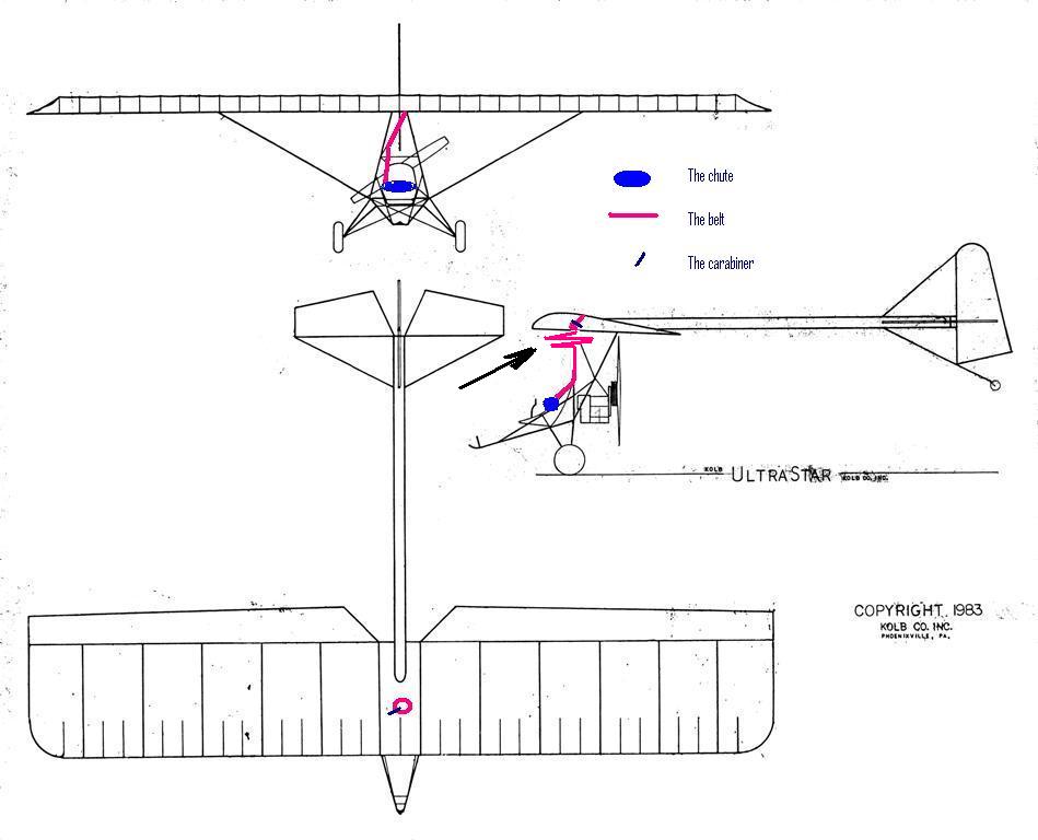

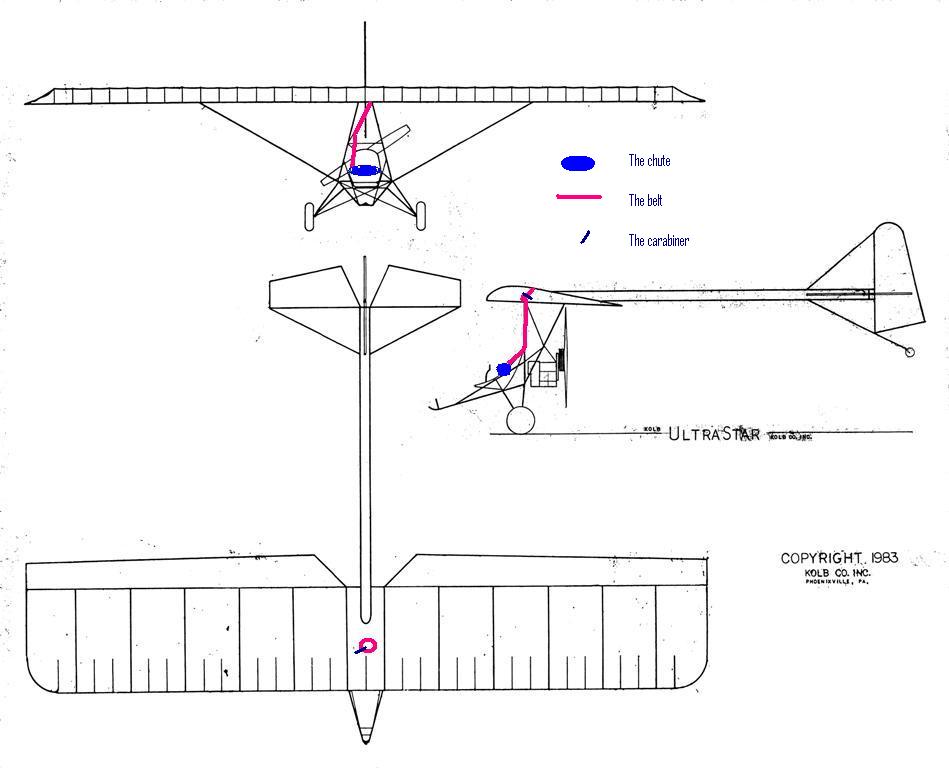

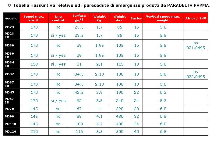

I have a question regarding the hand launch rescue chute installation on my Kolb Ultrastar. I get a chute from ParaDelta Italia, spec are:
Max weight: 250kilos
Max opened speed: 170 km/h
Weight 5kilos
See the drawing NumberOne.jpg : the chute is on a ventrally position on my thighs, It is fixed to my harness.
The security belt is too long, I do put it on the top near the karabiner (see NumberThree.jpg) ?
The chute must be removable easily, what is the kind of fixation do i use?
Bests Regards
Jean PILLAUDIN

PostPosted: Thu Mar 26, 2009 1:35 pm    Post subject: Ultrastar hand launch rescue chute installation Reply with quote
Jean:
I would use a zig-zag fold of about 10-12" to take up the extra length of the bridal, what you refer to as a security belt. Secure the fold with a couple nylon tie wraps. Then secure the folded section to a tube inside the gap seal. The end of the bridal, I would secure the loop aroung the 2" root tube of the airframe behind your head. That is where I attached my bridal on my Ultrastar.

PostPosted: Sat Mar 28, 2009 11:57 am    Post subject: Ultrastar hand launch rescue chute installation Reply with quote
<< zig-zag fold of about 10-12" to take up the extra length of the bridal, what you refer to as a security belt
the bridle (security belt?) in a "Z" shape, about 10-12 inches long; put a couple nylon tie-wraps on to hold it in that shape; .. even break the tie-wraps. >>
Of course, if you use a one-ended zig-zag with relatively loose tie-wraps, you don't have to break the tie-wraps. See the crude diagram:

Jean, To brothers Jim and John's advice, I would add this.Before you do anything, take your parachute to a certified rigger and have it evaluated for your purpose. Make sure your parachute has a deployment bag. There were reserve parachutes manufactured without one. A deployment bag is essential to make sure the chute doesn't get snagged on wreckage.
Parachutes are sized by the sphere they fit over, not by their area. Many hand deployed parachutes are woefully under sized for the load they will be expected to get to the ground at a survivable descent rate.
In my case I got the first thing right, I got the chute out and I lived. The second is what got me. When the rigger I took the chute to looked it over he said it wasn't large enough to bring me down alone, much less adding 80 lb. of hang glider and harness. My chute was a 26' with an area of 360 sq. ft. The parachute I fly with now, and have for the last 29 years, is also a 26', but it has 540 sq. ft. of area.
The first step in a deployment situation is to look for a path through the wreckage and throw the parachute there. Don't worry so much about which hand you use, you must get the 'chute out into clear air. Jim is right about the 'chute not having or needing a pilot 'chute. Because of this, the inertia of the chute after you throw it is all the energy available for popping it out of its deployment bag. Anything that impedes the chute from getting to the end of its bridle line takes away from that energy. Even though I threw it out of the wreckage and saw it go to the end of the bridle line, mine did not come out of the deployment bag until a wing of the now spinning glider caught the bridle line and jerked the chute out. From 800 feet I got at least six turns before deployment. There was just enough time to get line stretch, realize I was coming down far too fast and wham. Spent six weeks in a back brace and eventually ended up an inch shorter when the disk between the two damaged vertebra dissolved and the disks fused. No fun at all.
Rick
On Sat, Mar 28, 2009 at 8:49 AM, John Hauck <jhauck(at)elmore.rr.com (jhauck(at)elmore.rr.com)> wrote:
I doubt anybody on the Kolb List is using a hand deployed parachute.  When I got mine, 1984, ballistic recovery systems were extremely new, and my poor budget would not allow me to have one.  It took extra time to get into the parachute harness, was cumbersome getting in and out of the airplane with it on, difficult to get the seat belt and shoulder harness connected, and finally, the weight of the parachute was always on top of my legs.  I often dreamed of the ease of getting in and out of an airplane equipped with a ballistic parachute.  So much easier to get in, buckle up, and take off.  However, my desire to fly was so great, I never complained about the hours that Jim Handbury hand deployed parachute rode in my lap.
Brother Jim is correct.  I could best grasp the handle on top of the pack tray with both hands, snatch the deployment bag out of the pack tray, then throw it out, down and to the left, with both hands.  I am right handed.  A left hander will probably be able to do a better job of tossing out the deployment bag down and to the right.
October 1985, I flew to Florida so Brother Jim could repack my parachute.  Before we opened it up, Jim asked me if I had ever practiced deploying it.  I had not.  He told me to put it on, sit down on the ac unit beside the house, and throw it.  I did.  Seven days later the parachute saved my life.
-----  You throw it forehand, across your lap?  I would have thought you'd throw it down on the side of the arm you're using.
-Dana

PostPosted: Sat Mar 28, 2009 1:02 pm    Post subject: Ultrastar hand launch rescue chute installation Reply with quote
Tom K:
Not necessary. Snug down the tie-wraps. When the canopy opens, there is enough power to pull the kevlar bridal through aluminum and steel tubing. The main square tube that ties the main spars together on the top of the fuselage was flattened by the bridal. It wouldn't know the tie-wraps were there.
bridle-------------------- __ __ --------------bridle
Tie-Wrap --> | | |   | | |
    |__| |__| |__|
Tom Kuffel

Hi Richard,
Thank's for your advice, there is a pod (deployment bag) the surface (area) is 62 square/meter (670sq.ft) see the picture joined (mine is PD57 CR).
Via google from italian to english:
"The product range includes emergencies PARADELTA for free flight (gliding and paragliding) and for single-seater ultra-light aircraft and two-seater capable of satisfying the most varied needs."
http://www.paradelta.it/nuovosito/prodotti/sportivi/emergenze.htm
I used to fly glider always with chute (required in French country), and hang-glider too, and the balistic chute is the price of the UL....Then this is my choice.
