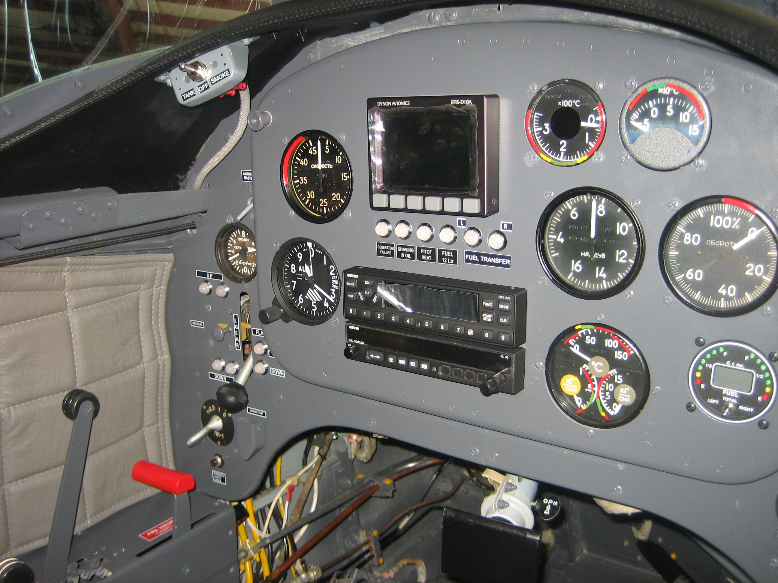

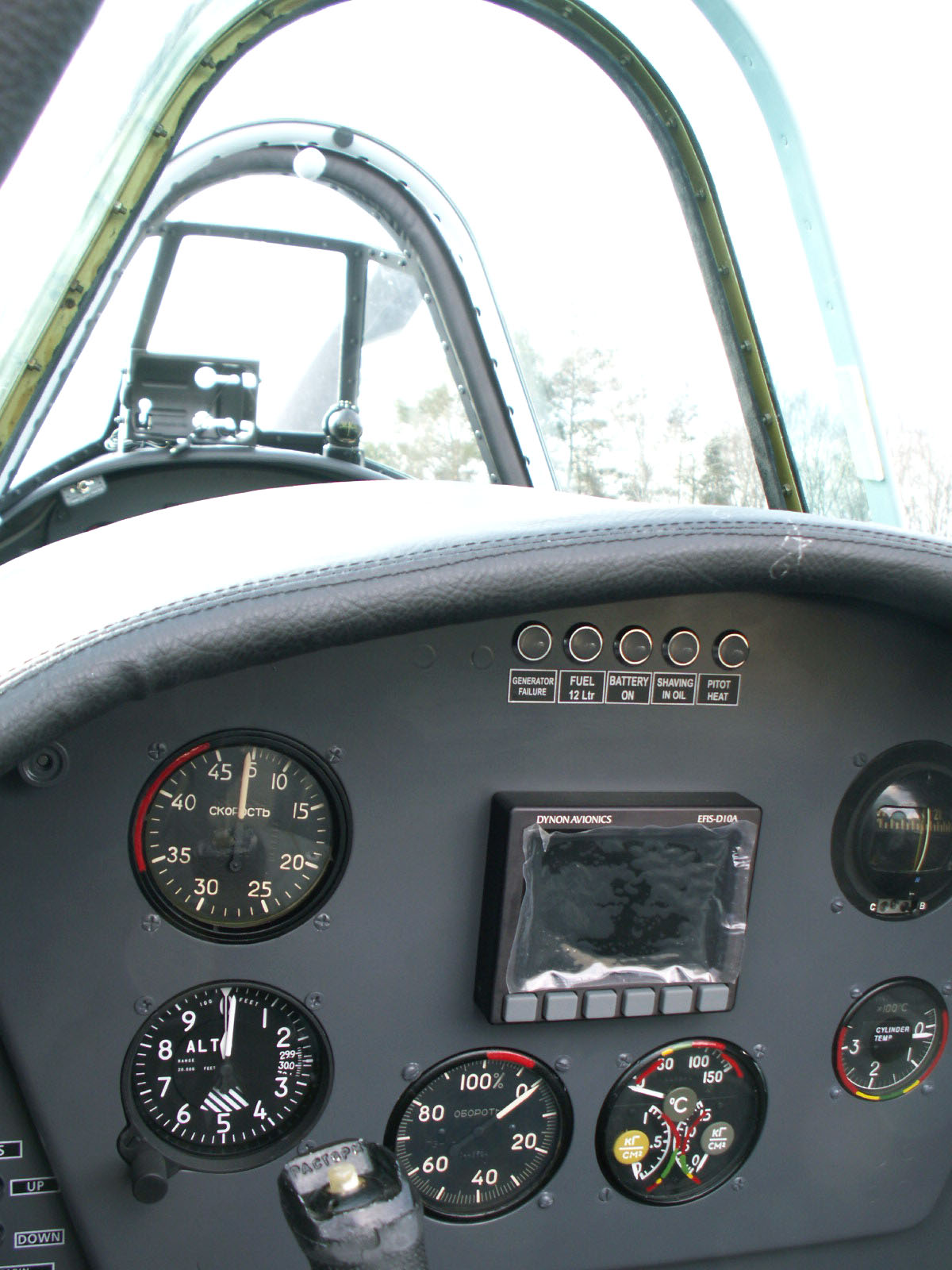

Do you by chance have a pic of your panel with the Dynon fitted?
Mark

PostPosted: Sun Mar 29, 2009 2:47 pm    Post subject: RC Allen RCA2600 ADI Reply with quote
Mark: Here are some photos of the Dynon I put in my 52TD in the front and
back. It is Gucci!
dave jester
