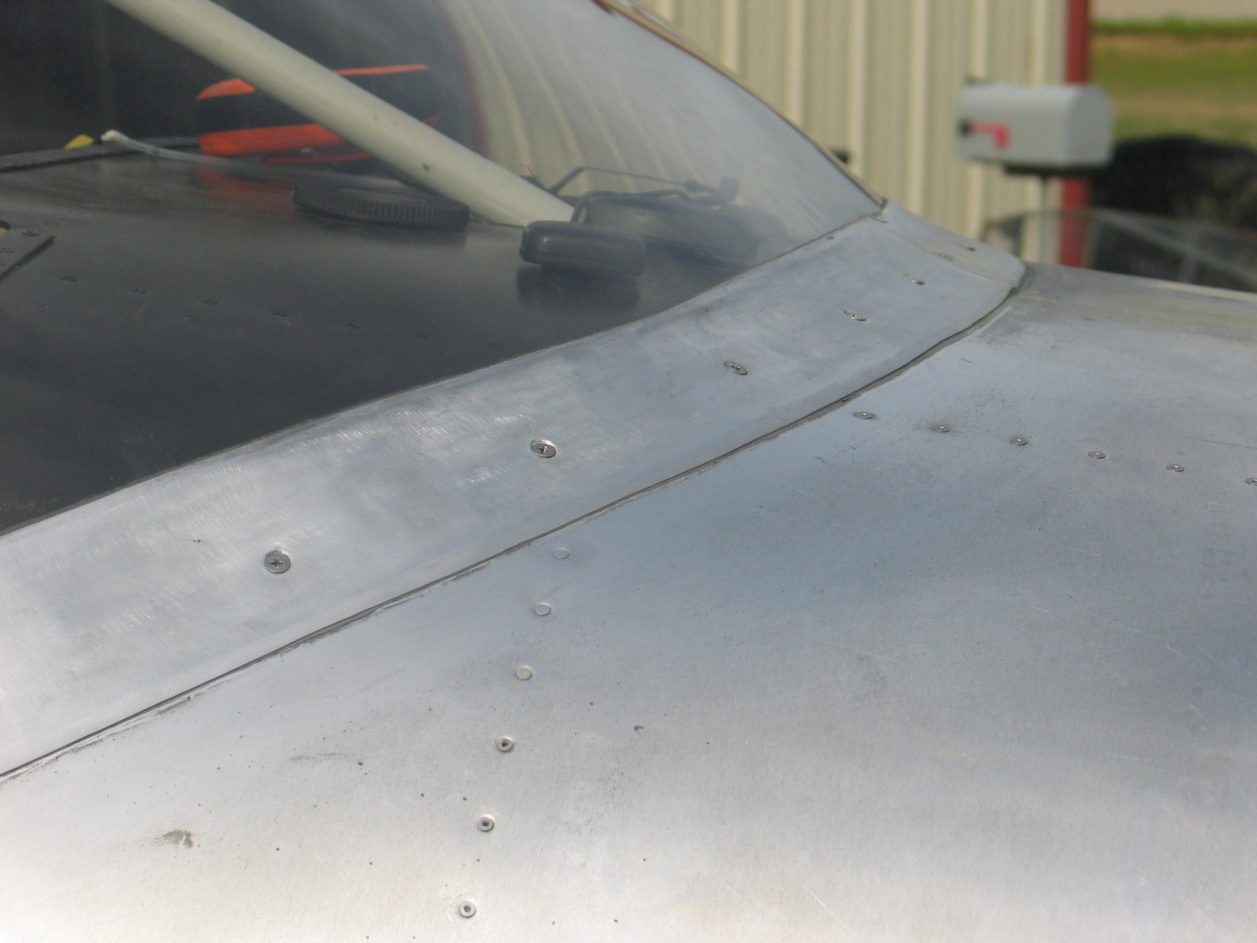

gipsowh(at)hotmail.com

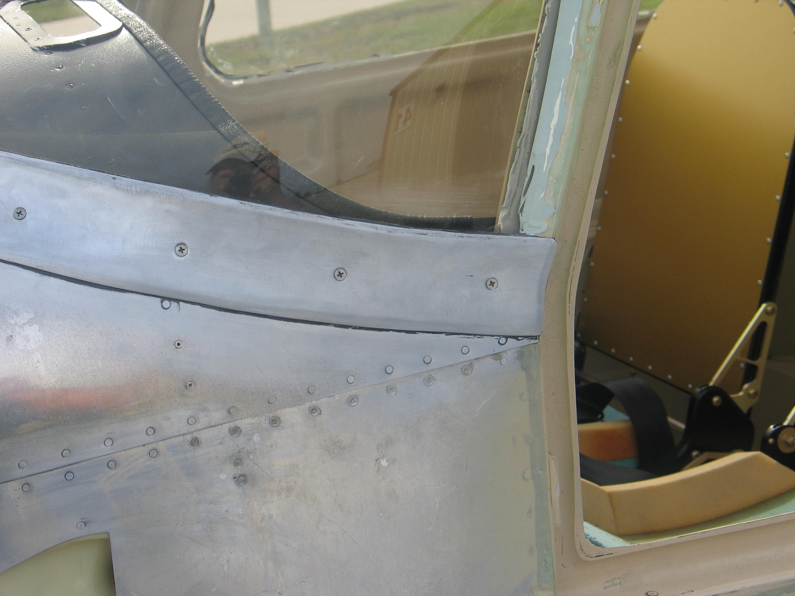

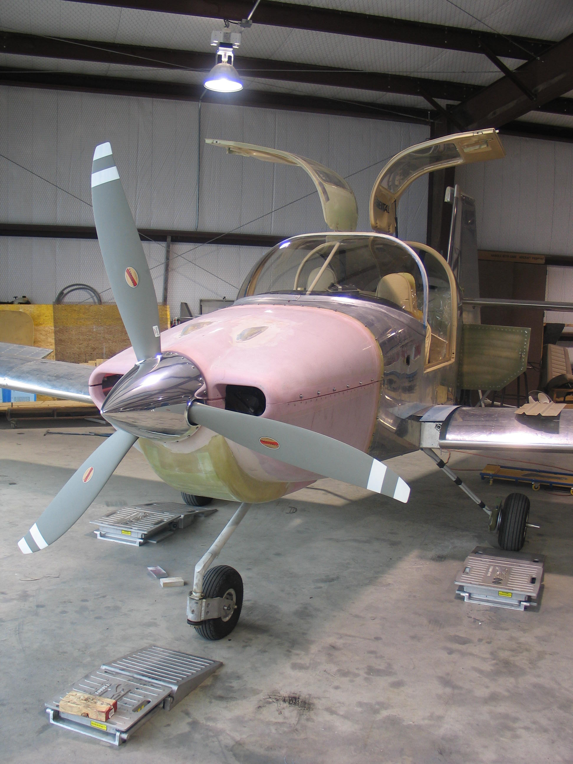

PostPosted: Mon Mar 23, 2009 5:22 am    Post subject: Wind screen fairing Reply with quote
Dave, we installed a metal fairing that Bud Warren fabricated. He had done it before and was up to the challenge. I think it came out quite nice. May save a paint job down the road should the windshield need replacement. The installation was the easy part. Bud spent several hours fashioning the fairing from a piece of sheet metal. This job is for the experienced, not a novice or else you will probably be disappointed.
Bill Gipson
N720WL
LS1 powered RV-10
Conroe, Texas

daveleikam(at)wi.rr.com
PostPosted: Mon Mar 23, 2009 6:05 pm    Post subject: Wind screen fairing Reply with quote
Is the fairing one piece? Can you post some close up pics? Thanks.

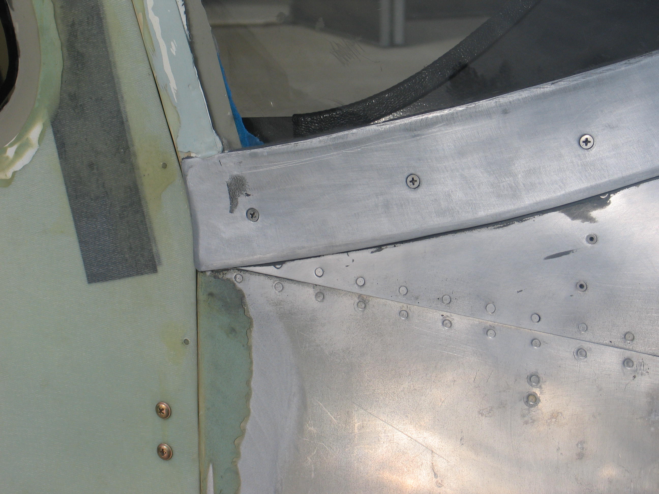

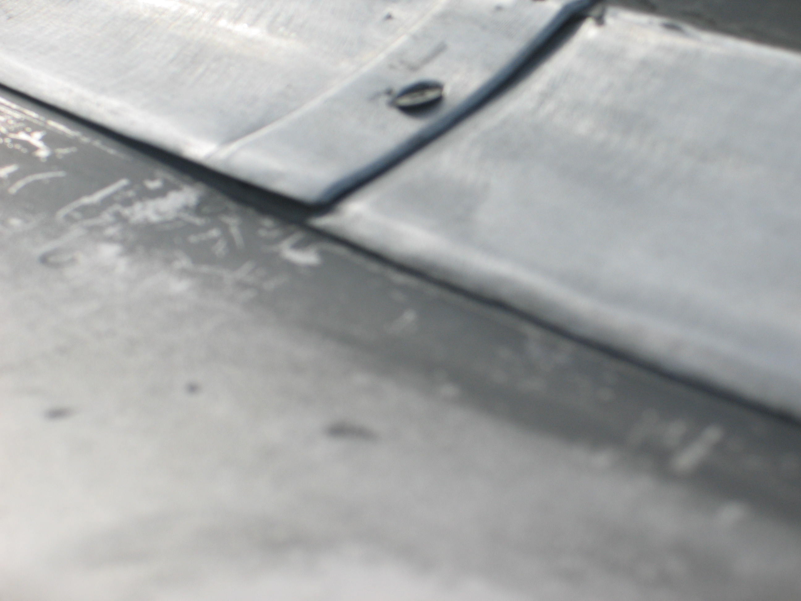

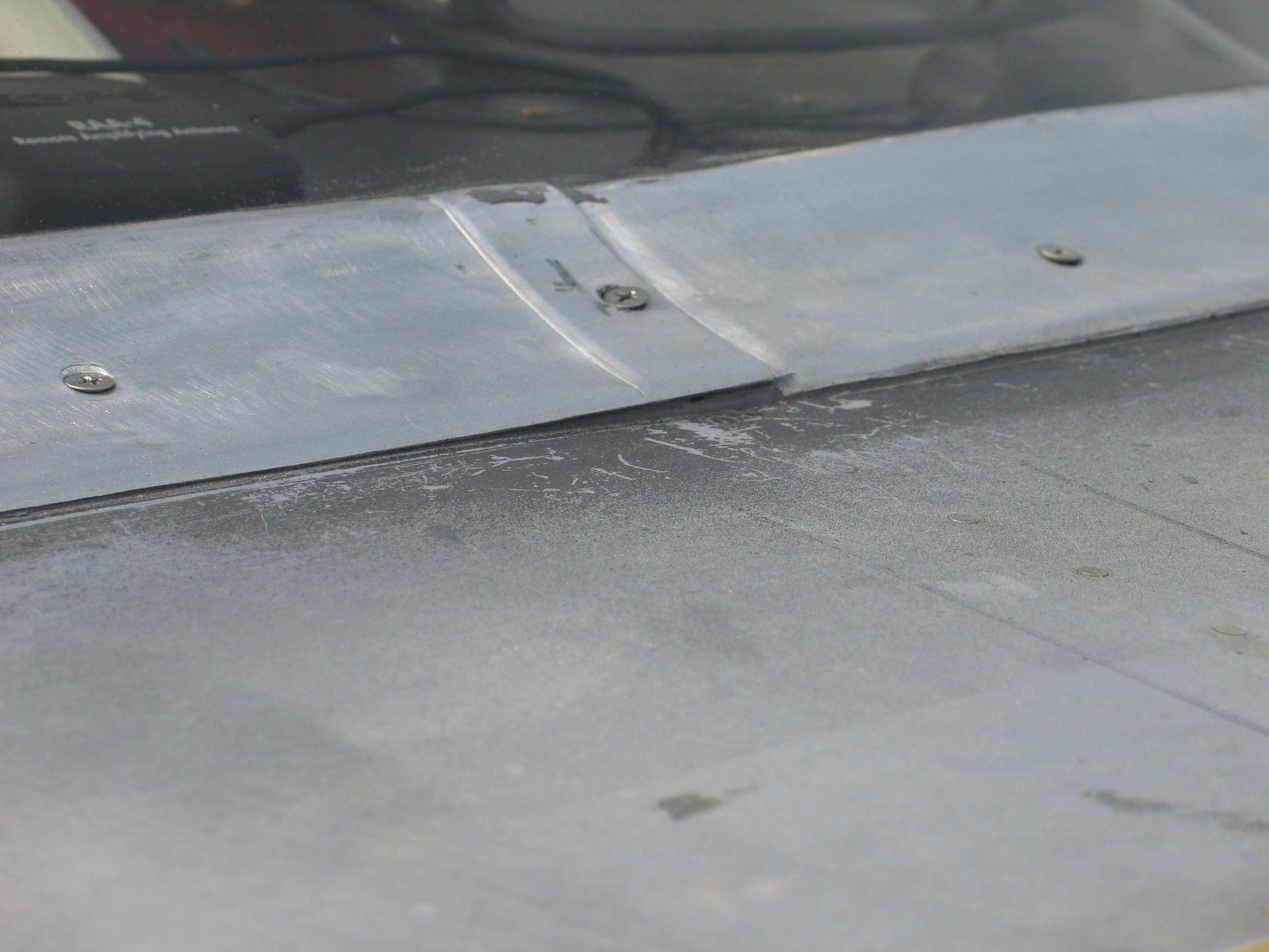

PostPosted: Mon Mar 30, 2009 4:04 pm    Post subject: Wind screen fairing Reply with quote
Was at the airport this weekend and got these close-ups as requested. The fairing is two pieces with a knuckle joint in the center. The fairing is held on with rivnuts and the void between the fairing and winshield/skin is filled with black RTV for water-tight seal.
Bill Gipson
