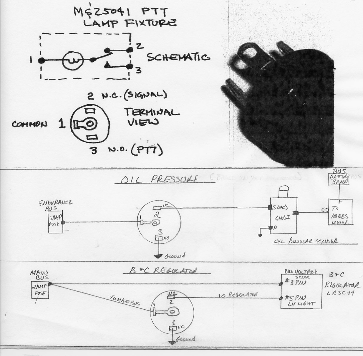

I'm installing a couple of these Lamps in my 9A - 1 for Oil Pressure and 1
for Low Voltage Protection. Now, I've researched these lamps and proper
circuit runs for a couple of months both on Aeroelectric and other homebuilt
sites. There is "some" info out there, some of which is confusing and some
that make sense.
What I've done is attach a drawing ( a jpeg & word doc)of what I determine
to be the circuit layout for Oil Pressure and Low Voltage. Can you please
take a look at these and let me know if they're correct and or make
corrections where needed.
Appreciate your input.
Henry
Henry
What you have illustrated will work fine.
