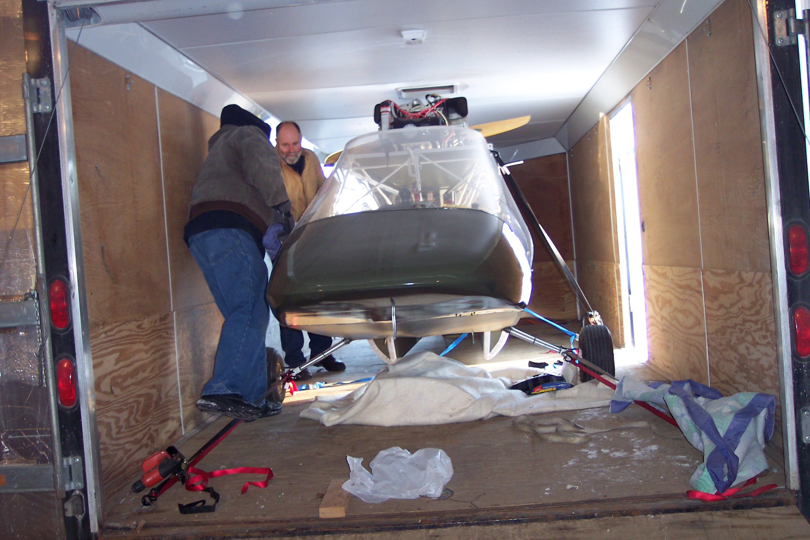

PostPosted: Thu Mar 26, 2009 1:39 pm    Post subject: Re: How long is a folded mark 111 classic? Reply with quote
Well....when I pick up my m3x in January I had a 25' enclosed snow mobile trailer and we had to rig up the rear door to stay open at the top about a foot....a 26 footer would have just made it.If there is any way he can get an enclosed trailer...tell him to do it! As far as him fitting into it...I am 5' 10" tall and I fit just fine .I think anyway you look at it he is going to have to try it on !
Good luck!
chris ambrose
m3x-jab

PostPosted: Thu Mar 26, 2009 1:41 pm    Post subject: How long is a folded mark 111 classic? Reply with quote
Brian, a 16 foot trailer has to have an extension added onto it, at least 2 feet, then it has to be wide enough for the main gear. I bought a MK-3C last year from a guy that wasn`t that tall, but had such a large girth( Belly), he couldn`t reach across to the throttle.

PostPosted: Thu Mar 26, 2009 2:40 pm    Post subject: How long is a folded mark 111 classic? Reply with quote
Brian
Not apples to apples, but my MKII is about 24' folded. The previous owner was about the size of your buyer, and he was able to fit in and fly it.

PostPosted: Thu Mar 26, 2009 4:24 pm    Post subject: How long is a folded mark 111 classic? Reply with quote
My 26' trailer can fit my MkIII and close the back tailgate, and, when closed, have just barely enough room to squeeze by if I want to cross to the other side.  But only if you're really skinny.
I've flown 2-up for a total people-weight of about 420 lbs (and I'm 6' tall), so a single 275 lbs shouldn't be an issue... but, as Jim said, reaching the throttle might be an issue if the belly is large.
