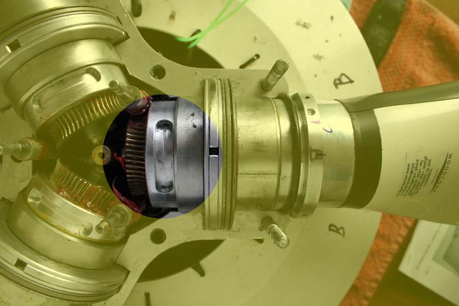

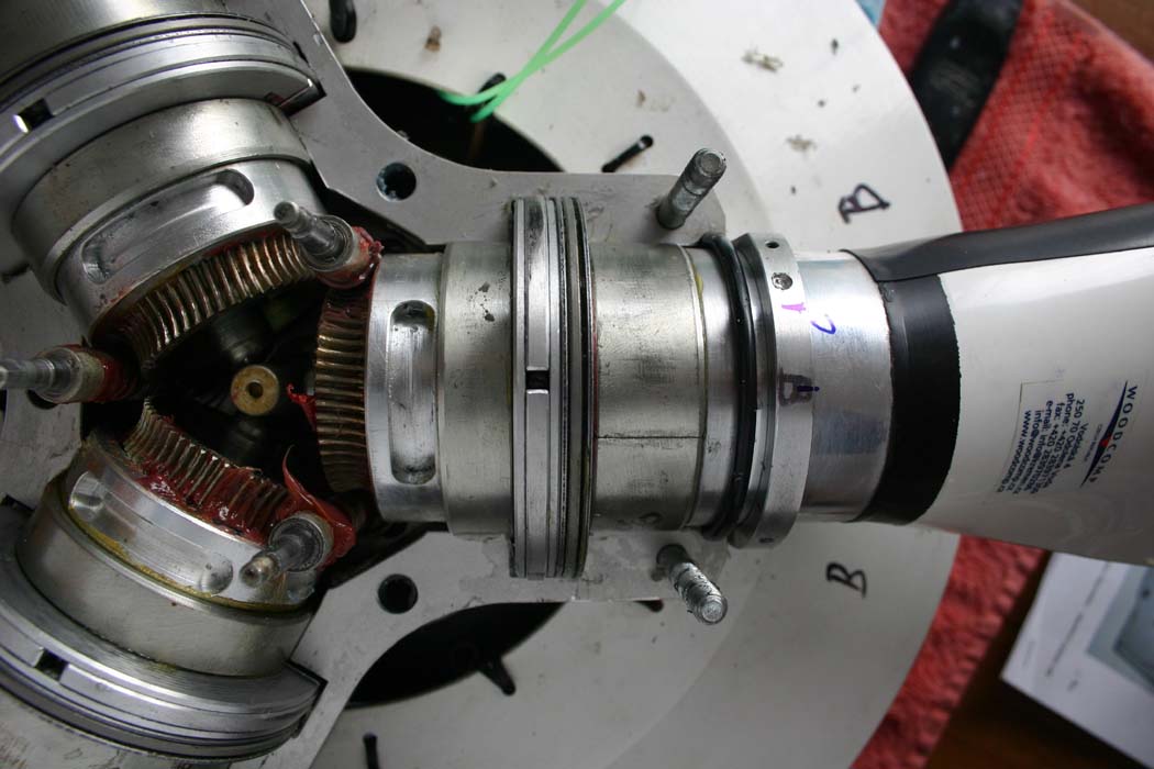

For the avoidance of doubt these propellers are definitely fitted with an
end stop mechanism. If you look at the photo there is a machined groove to
the right of the bronze coloured cog. There is an M6 bolt through the front
of the hub which locates in the groove limiting the blade travel.
The problem is that this prop has the facility for reverse thrust so the end
stop is of no use if the motor takes the blade beyond fine pitch. Thats why
I need to get it modified. I assume that your propeller Jos will have been
the same.

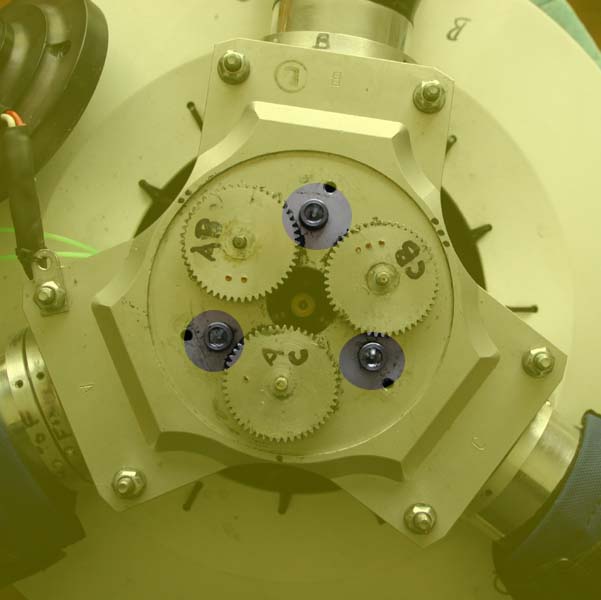

As David says there is definitely a groove and a limiting stop in Williams
prop - photos herewith..
I have just sent it back to Woodcomp for them to shorten the length of the
groove so the blades can't travel beyond the fine setting (ie: into reverse
pitch).
It isnt clear but the end stops are 6mm allen head bolts through the front
hub. These slot into the grooves limiting the blade travel.
