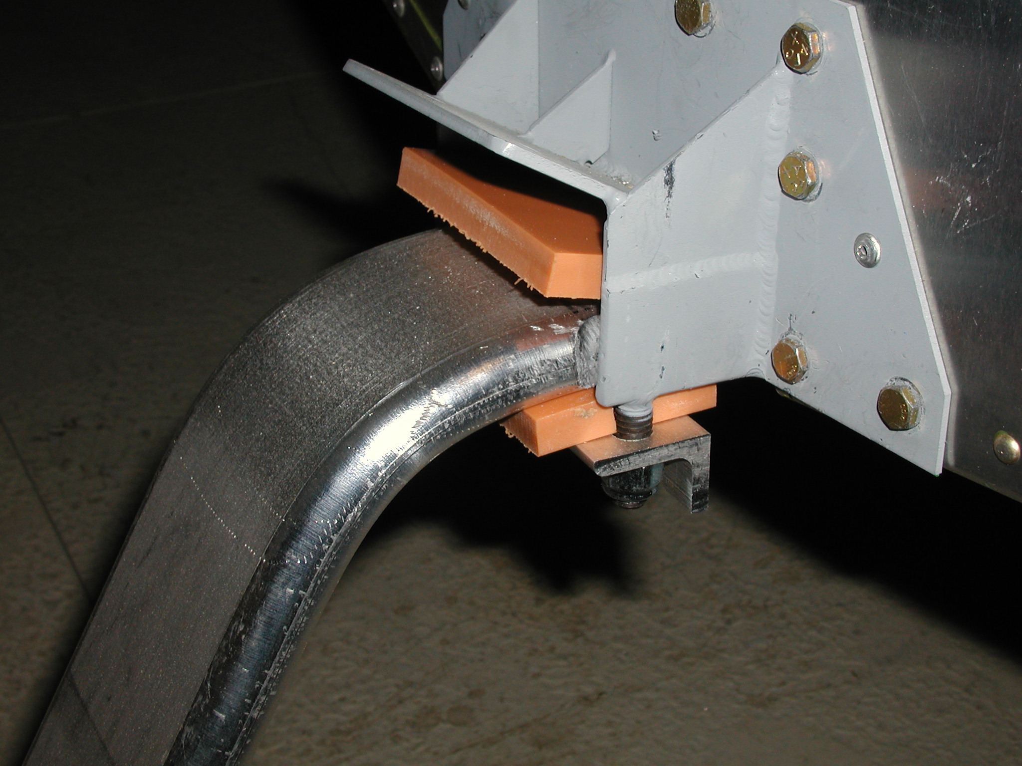

PostPosted: Thu Mar 26, 2009 6:04 am    Post subject: Rubber Spacers on main gear Reply with quote
Mine are in place for temporary fit.
These were hard to drill out the openings for the studs.
 Filesize:  617.01 KB
 Viewed:  8354 Time(s)

PostPosted: Thu Mar 26, 2009 10:47 am    Post subject: Rubber Spacers on main gear Reply with quote
I have about 50-hours and many rough field landings on the new Zenith
Urethane pads... They don't show any wear on them and seem to be working
fine.

Thanks to all for the help on this issue. I really like the urethane
solution but not the color. However, being frugal (cheap) and having an
abundance of discarded tires along side the road in my area, I will go
the tire route. This will also please my wife since I will be greening
the landscape. Reduce, reuse, recycle, repair. Smile
