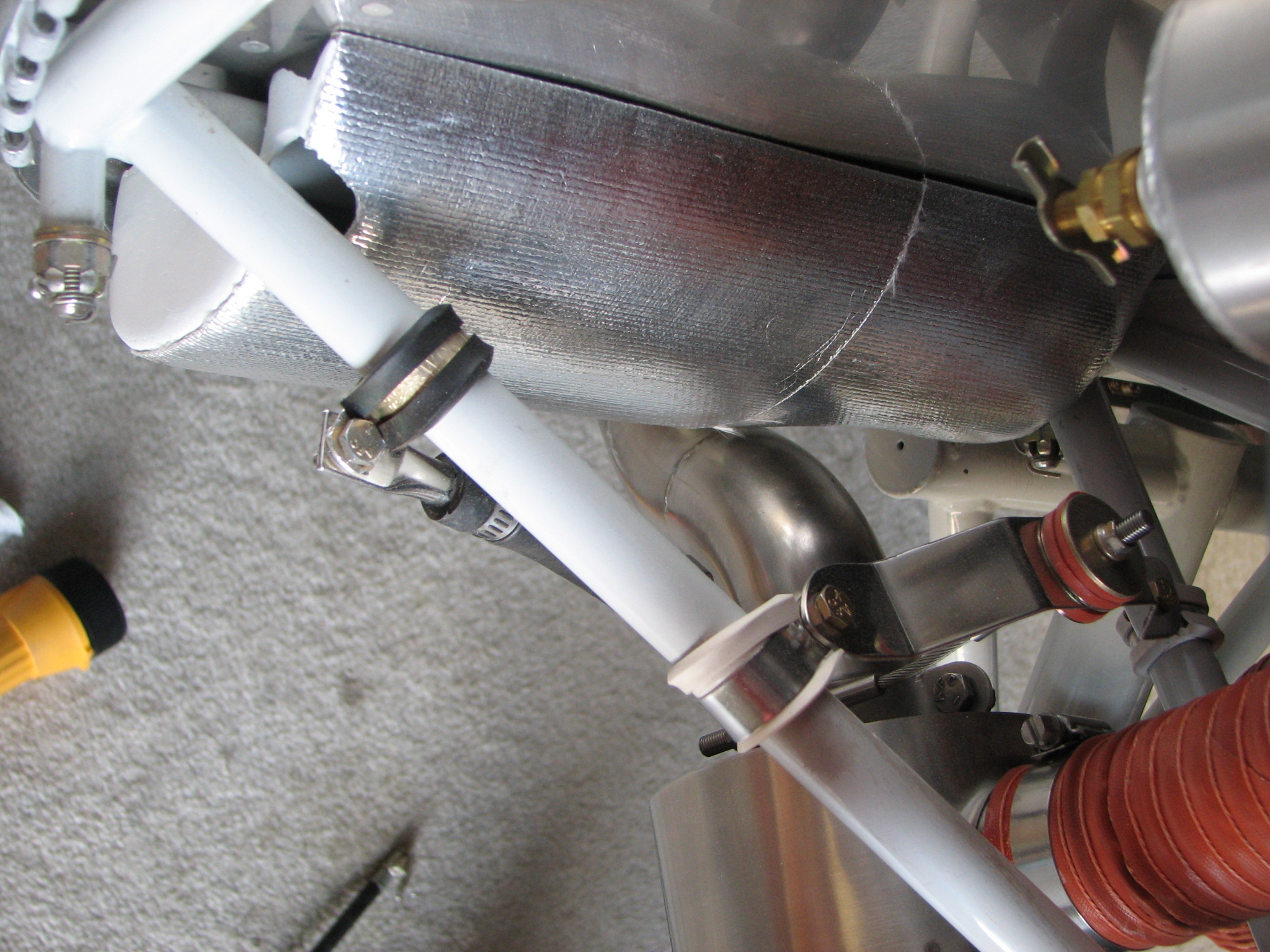

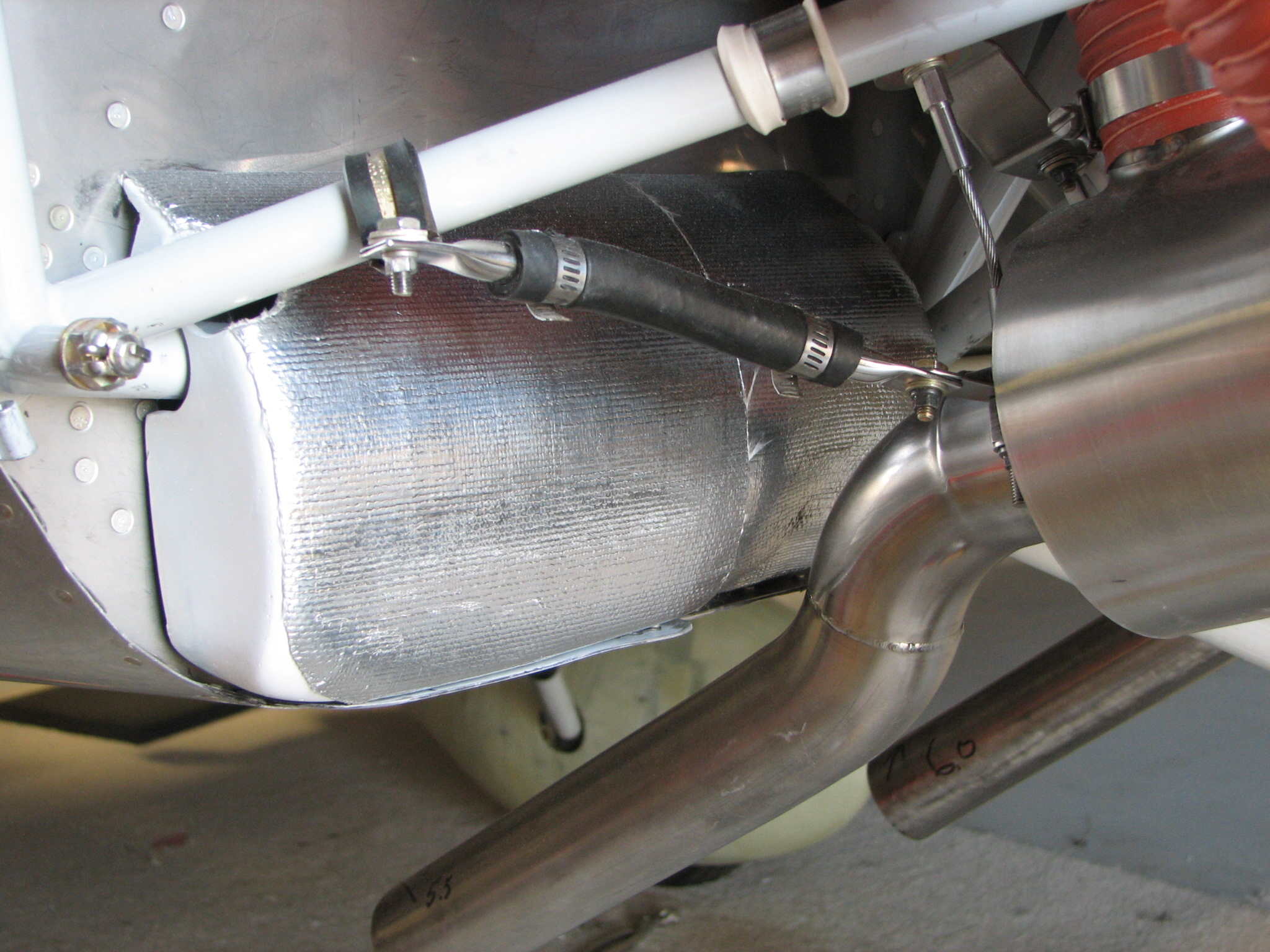

After twenty months I finally opened my box of exhaust parts and -oppps - it does not match the drawing on pg FF6-2.................
My Vetterman exhaust manifold has two tail pipes instead of the two manifolds combining into one tailpipe. Is this the new program for the IO540 engine?????
Is there a replacement Pg FF6-2 etc that shows the install of this two pipe system? - Anybody with info or pics????

This is old news. Van's switched exhaust kits early
on. They never updated the plans. Even my kit that's
been flying for over 3 years now has this Vetterman
exhaust, so most builder pics you will find will
not resemble plans. I'm not sure how many kits were
shipped with the old system, but it was under 170.

Mike, the brackets that support the exhaust to the motor mount are really wimpy... I think I made up an extra set out of stainless. Plus they need to be bent upward to support the exhaust properly.

Talking of old news and old fogeys. My memory came up with Chris Stepp
from American Exhaust who was talking with me when I began talking to
John Forsling on the Barrett project. The desire was a tuned system to
improve on Air/Fuel balance, ported heads for extraction of a few more
ponies than from a more conservatively built Aerosport. Attached are
the First Gen VANS/Vetterman system that the original plans drawn from
(I think for the first 140+ kits). Then Chris sold his unique "One Off
"design to Larry Vetterman who changed it to the Second Gen VANS "now
known as Vetterman" for mass production. Although they did not achieve
the identical exhaust flow that I desired, they did go to the dual
collectors, dual heat muffs, and improved hangar support helped. The
intent was to reduce or eliminate the irritant popping sound that would
intermittently emanate when cutting throttle quickly as the ole four
banger RVs would turn base to final. The reduced exhaust pressure of a
short stack was thought to contribute. Hence today a longer stack to
discharge distance.

PostPosted: Sun Mar 22, 2009 4:33 pm    Post subject: Vetterman Exhaust system - Page FF6-2 frm 2007 Reply with quote
That's just what my Vettermans do.
2 separate systems.
Works just fine for past 2 years now.
