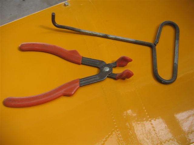

Hi Folks, Here are the shock cord tool pix and instructions.
The red handle tool is a (K&D??) tool from NAPA for pulling spark plug leads. The hook with a handle is homade from 1/4" steel round from the hardware store. It has a bit more hook than it seems in the photo. I have changed at least a dozen cords witht hese tools
I reach in the cabin and hook the first loop of the cord.thread it down to Mary,she pushes it back up. I pull hard as I can and send it back down.she sends it back and I hold TIGHT with the KD tool. The important thing is that you hold tight . Don't let anything slip back. Do it with the KD. send the end back down. She pulls as hard as she can and you hold while she sends it back up. You pull like heck and grab whith the tool.Repeat,repeat. Sometimes I grab the cord with the KD and PUSH down to her and hold. Last step is to push the hook down through to her and she hooks the end loop on it. If you have done well you will pull up more cord than you actually need and hook it over the knob. You will have taken a lot less than 10 minutes.
Remember,don't let any slip back.If you do you may have to unwrap the whole cord and start over again. I have often thought for the few dollars for the KD tool,it might make it easier if you had two. One to pull up with and one to push down with.

Larry C Thanks for the pictures. I have that exact sparkplug puller tool in my tool box. I am surprised you can hold the shockcord that tight with that tool. If I ever need to redo mine I will use your method.

Hi Folks C   Here are the shock cord tool pix and instructions.
  I reach in the cabin and hook the first loop of the cord.thread it down to Mary Cshe pushes it back up. I pull hard as I can and send it back down.she sends it back and I hold TIGHT with the KD tool. The important thing is that you hold tight . Don't let anything slip back. Do it with the KD. send the end back down. She pulls as hard as she can and you hold while she sends it back up. You pull like heck and grab whith the tool.Repeat Crepeat. Sometimes I grab the cord with the KD and PUSH down to her and hold. Last step is to push the hook down through to her and she hooks the end loop on it. If you have done well you will pull up more cord than you actually need and hook it over the knob. You will have taken a lot less than 10 minutes.
  Remember Cdon't let any slip back.If you do you may have to unwrap the whole cord and start over again. I have often thought for the few dollars for the KD tool Cit might make it easier if you had two. One to pull up with and one to push down with.
  Good luck and have fun.
