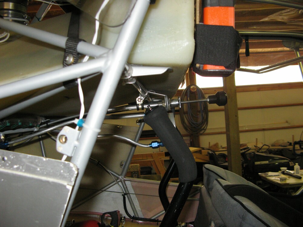

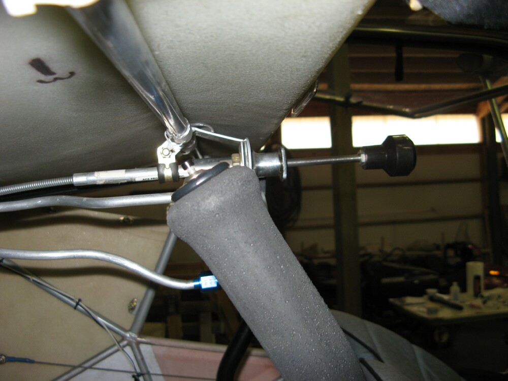

Clem, the perspective in these photos make it look a little further forward than it actually is. The top front edge of the stick handle is 1-1/2 inches directly below the trailing edge of the lower panel fuselage tube. Classic 4 built by the book.
