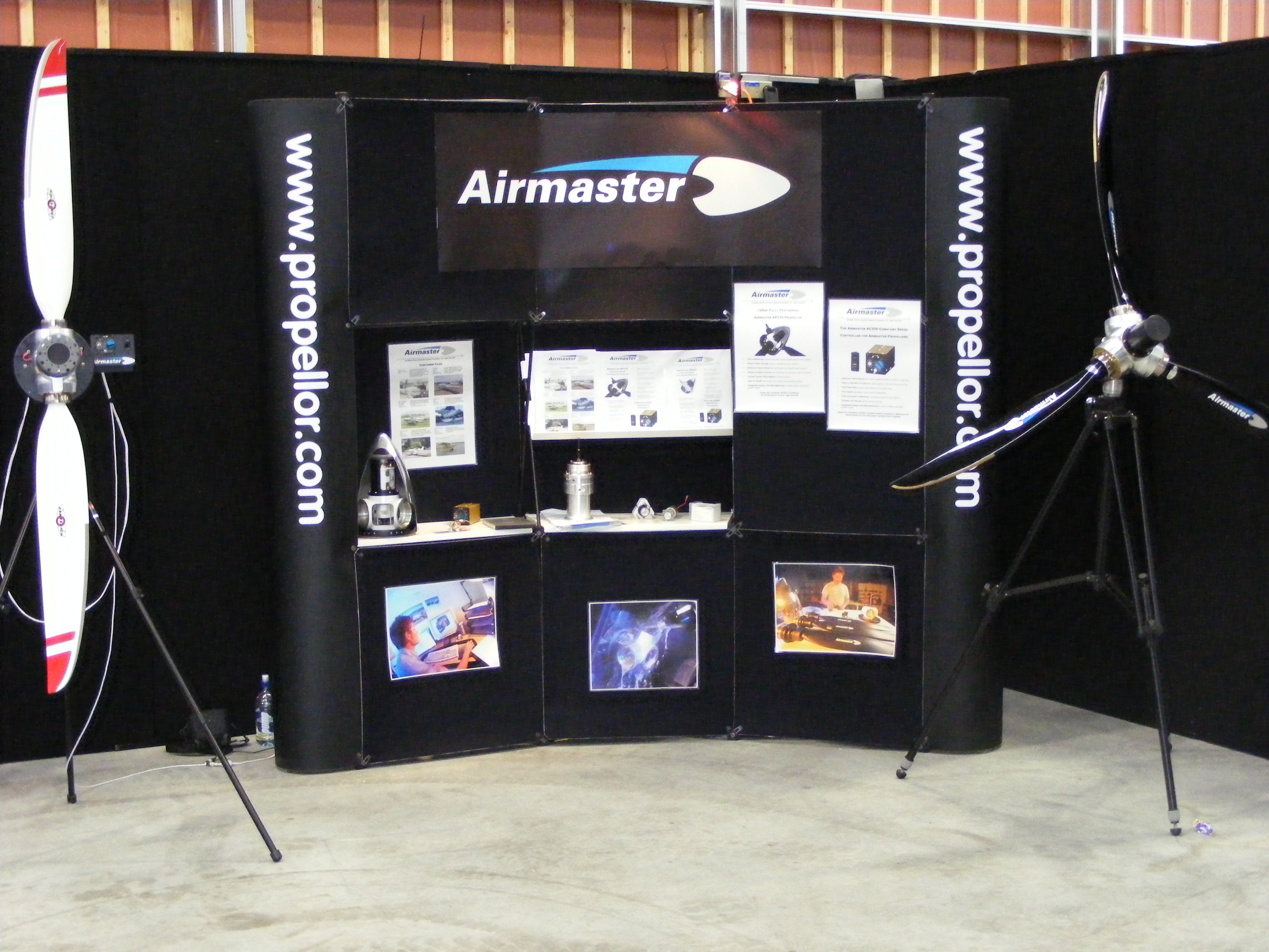

To those who have yet to make a prop-commitment, these new blades Airmaster is testing look like a vast improvement over the Warp Drive blades.
Fred
Begin forwarded message:
[quote]From: "Airmaster Propellers Sales" <sales(at)airmasterpropellers.com (sales(at)airmasterpropellers.com)>
Date: March 19, 2009 7:54:38 PM PDT
To: "Fred Klein" <fklein(at)orcasonline.com (fklein(at)orcasonline.com)>
Subject: RE: AP332 blades
Reply-To: <sales(at)airmasterpropellers.com (sales(at)airmasterpropellers.com)>
Hi Fred
It is true we are testing new propeller types.
For the Europa we are currently in the process of testing a two blade
propeller using Sensenich blades and a three blade propeller using Kiev
(amounst others) Both are at a diameter of 64in. Each will have advantages
and disadvantages compared to the Warpdrive.
I will make results available once I have a good idea of how these new
propellers will perform.
Martin
