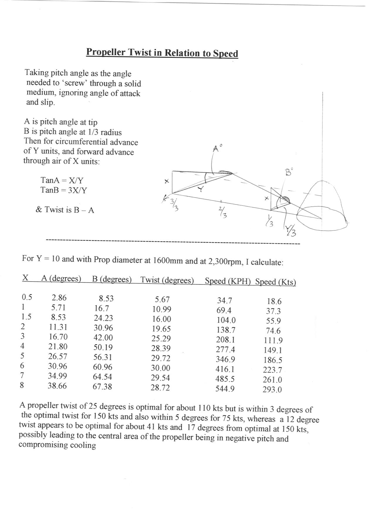

Fred, The twist of a blade along its length is fairly critical to engine
cooling. Changing from a Woodcomp SR2000 with 12 degree twist to an SR3000W
with about 26 degrees of twist has transformed my 914 cooling , totally
eliminating the overheating on delayed take off or prolonged climbs. It has
also added 4 kts to top speed and improved fuel consumption.
As you can see from the attached mathematical analysis a 12 degree
twist is optimised for air flow through the prop of about 40 kts, which is
what you get sitting on the ground at about 1/2 throttle, before take off.
At 100kts + you have negative AoAs in the central portion of the propeller,
which doesn't help anything. It's no coincidence that all really fast planes
(Spitfires, Red Bull racing planes, turboprops, etc) have props with twist
more than 20 degrees. Regards, David Joyce, G-XSDJ
