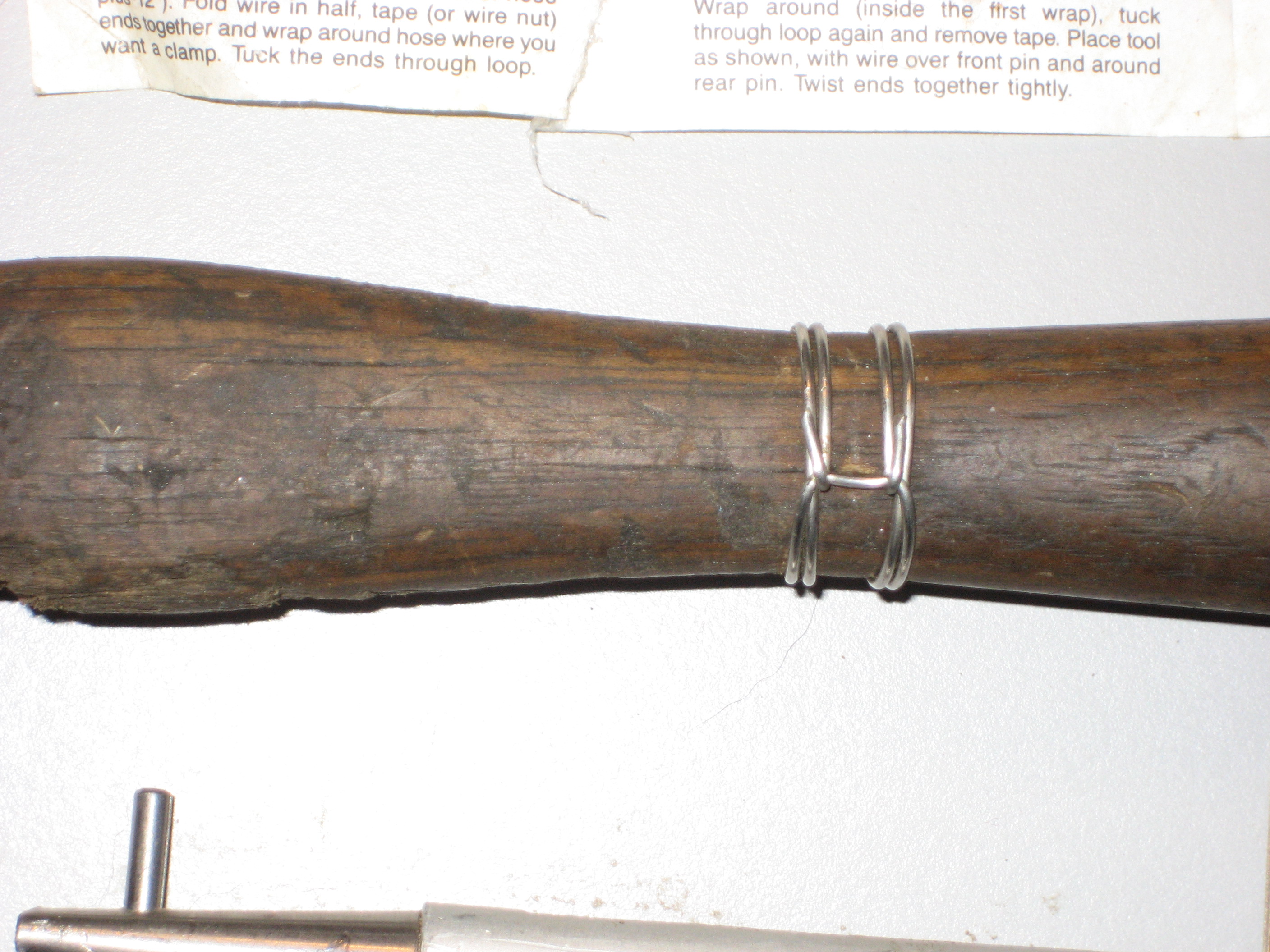

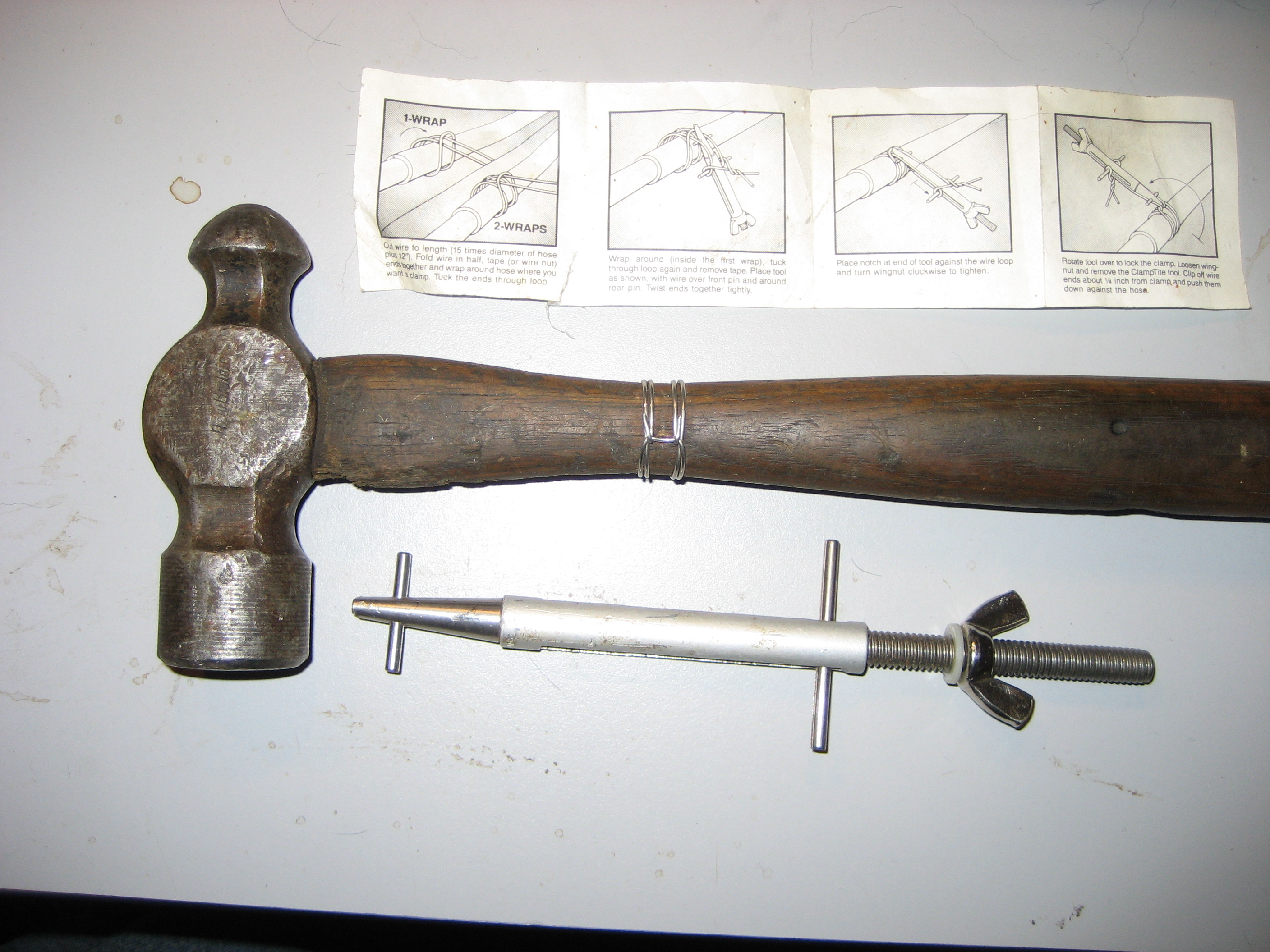

The tool I used to fasten the two ends of a bungee cord together and for many other things I first saw at an air show but didn't buy it. Later I wished I had and then did a great deal of searching and found the source. Regretfully, I don't have that information easily at hand anymore.
The first picture shows the tool and a broken hammer handle I fixed with it using safety wire.
The next photo is a closeup of the safety wire repair. You can make as many wraps as you like. I made 6 wraps on bungee cords which is 12 strands. I think 3 wraps (6 strands) is plenty.
The last photo is a scan of the instructions that came with the tool. The repair job was my first trial with the tool. I've been using that hammer for years since making the repair and it is tight and holds together like new.
Close up of the tightened safety wire wrap

Closeup of the tightened safety wire repair on the broken handle.

Tool and repair job on hammer handle

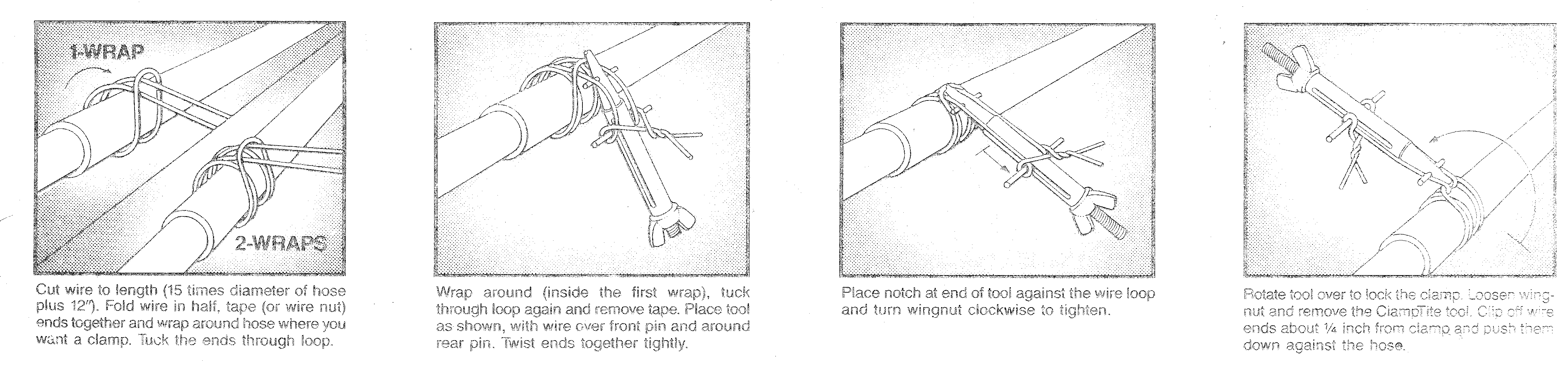

Oops. I screwed up the picture posting. Left off the instructions and somehow posted two pictures of the same thing. Here's the instructions. Here they are.
Instruction sheet - back side.

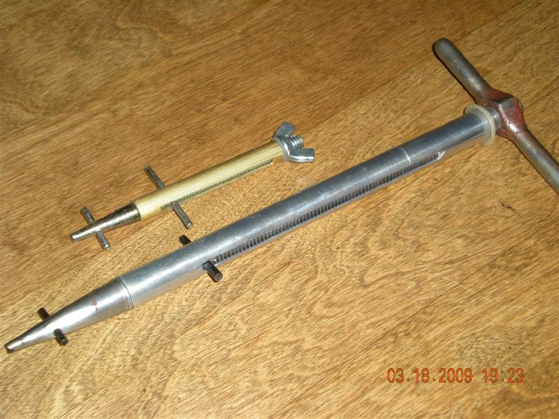

PostPosted: Wed Mar 18, 2009 6:44 am    Post subject: Safety Wire Repair Tool Reply with quote
I also bought one online for about $25 or so several years ago. It was too
small and I wanted something I could use in my plumbing business for things
like 1.5 inch black plastic pipe and other things here on the farm. So,
using my metal lathe I made one that is about 12" long and using heavy wire
I can do some serious clamps. Cost was about zero as I used materials I
already had on hand. I haven't used it very often because SS hose clamps
work well for most things, but when I need that thing it definitely does the
trick. If anyone is interested I'll take a pic of it and post here.
Deke

PostPosted: Wed Mar 18, 2009 5:07 pm    Post subject: Safety Wire Repair Tool Reply with quote
By popular demand...drum roll. I don't know if I can do coat hangar wire
with mine as I haven't tried it, but it'll take some pretty heavy stuff with
ease. I've attached a photo of it for those who have expressed
interest...and those who haven't. Smile
The body is just aluminum tubing, the tip is 5/8 steel rod that is pressed
up inside the tubing about an inch, and I used a
long bolt down through the middle. The handle is a big nut with short
pieces of steel rod welded on each side and ground down to look nice. The
only thing I had to buy was the roll pins. Pennies.
The small one next to it is the one by Clamptite that I paid $25 for.
> too
> things
> wire
> the
Must have been something many people wanted since I see they now sell a
big one for
$100 or so, depending where you see it advertised that will handle big
wire, even coat
hanger wire. Making one shouldn't be too hard since it is has just three
pieces and a
couple pins and a wingnut. Need a swaging tool to connect the nose piece
with the
tube.
Paul A. Franz
How'd you cut the slots in the aluminum tube section? Do you have a milling machine?
Or just some patience with a Dremel cutoff disc?
It looks like ClampTite is using bigger pins in their $100 model and possibly 3/8"
roll stock instead of 5/16". They claim theirs will work with 1/8" wire. Boy that
would be tough to wrap around the tool and twist tight.
Two reasons why I like this method of making clamps is that the result is so much
smaller and lighter than using a gear drive hose clamp. I also think that when
gripping something like Bungee cords, you can get the connection tighter before you
damage the cords which might happen from the sharp edges on a gear drive clamp. With
three wraps (6 strands) I could easily compress 2 7/16" bungees to an outside
thickness of 7/16" which is less than half the thickness of two of them side by side.
I did have to rewrap and tie the safety wire once during the tightening.
