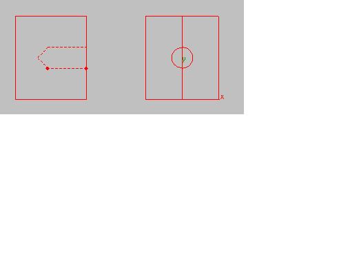

PostPosted: Sat Mar 14, 2009 6:31 pm    Post subject: Re: Smashing tubing Reply with quote
I would work the metal cold. If you take two pieces of hardwood and drill part way through the same diameter of the tube, they can be used as saddles to control the crush of the tube.
Clamp the blocks together and drill hole. Use blocks to support the tube while crushing in a vice.
You may need to make some adjustments for material thickness but I just wanted to illustrate the concept.
