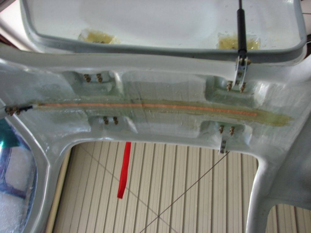

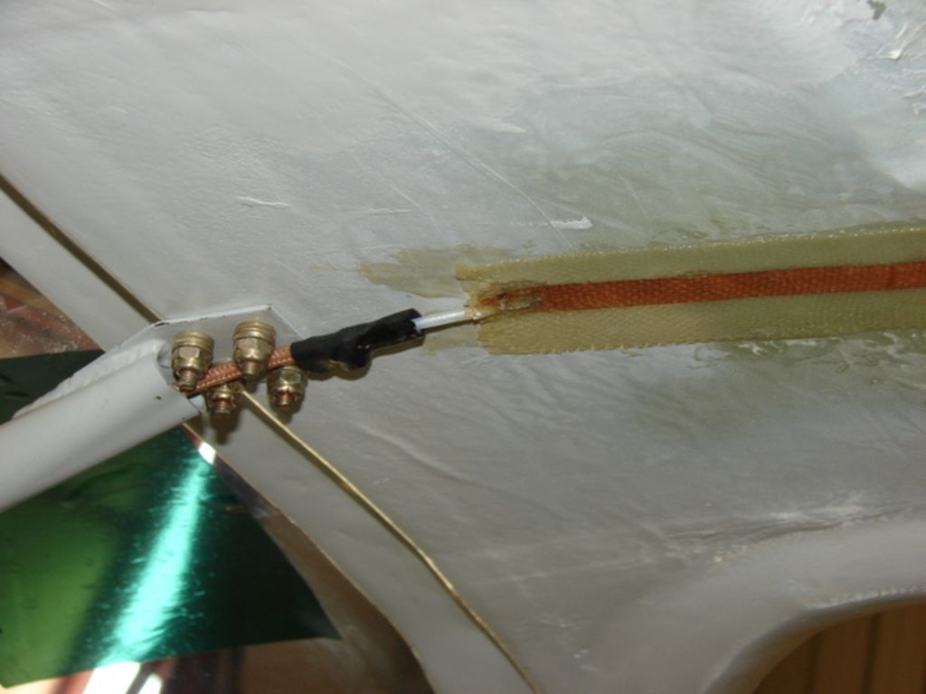

PostPosted: Tue Mar 10, 2009 1:06 pm    Post subject: Top COMM antenna Reply with quote
Michael,
I wouldn't give up on the tape antenna just yet. I use one for my 2nd
comm radio and it works great. My bent whip on the bottom goes to the
primary radio, but I've had great luck with the tape and use it to talk to
ground control and Unicom radios without any issues. Plus it's the cheapest
game in town by a long shot. I ran the comm cord up the cabin support tube
and tie the shield to the mount screw and the center to the tape with one
piece of fiberglass to cover the tape and hold it in place.

PostPosted: Tue Mar 10, 2009 1:35 pm    Post subject: Top COMM antenna Reply with quote
Marcus,
How long is your tape? I did mine according to the instructions and it
doesn't work well at all. I had a bunch of Ham radio guys come out and look
at it - they put a meter on it and told me it is electrically too short for
the frequencies I was trying to use.
Ralph

PostPosted: Wed Mar 11, 2009 7:01 pm    Post subject: Top COMM antenna Reply with quote
I honestly don't recall the length, but I ordered the "low drag" antenna for
$7 from Vans (Bob Archer???). I followed the directions closely so it is
whatever was specified. Best bang for the buck I've ever achieved with
avionics!
I've attached some pictures, there's not too much to it.
Marcus

Mike Whisky
Joined: 05 Jun 2006
Posts: 336
Location: Switzerland
PostPosted: Thu Mar 12, 2009 2:36 am    Post subject: Re: Top COMM antenna Reply with quote
Marcus,
based on what I know and what was also mentioned before the com antenna needs to be as much vertical as possible. So how does your installation on the cabin ceiling work then?
Michael

PostPosted: Sat Mar 14, 2009 7:45 am    Post subject: Top COMM antenna Reply with quote
Unfortunately I cannot speak to the technical questions that have been
raised, and are pretty good actually. However, I can attest that it works
great and I haven't had any issues. My thought process was to give it a
try, the price is negligible and I figured if it worked great, if not then
you can't see it under the fabric on the cabin roof anyway so no real loss.
Marcus
