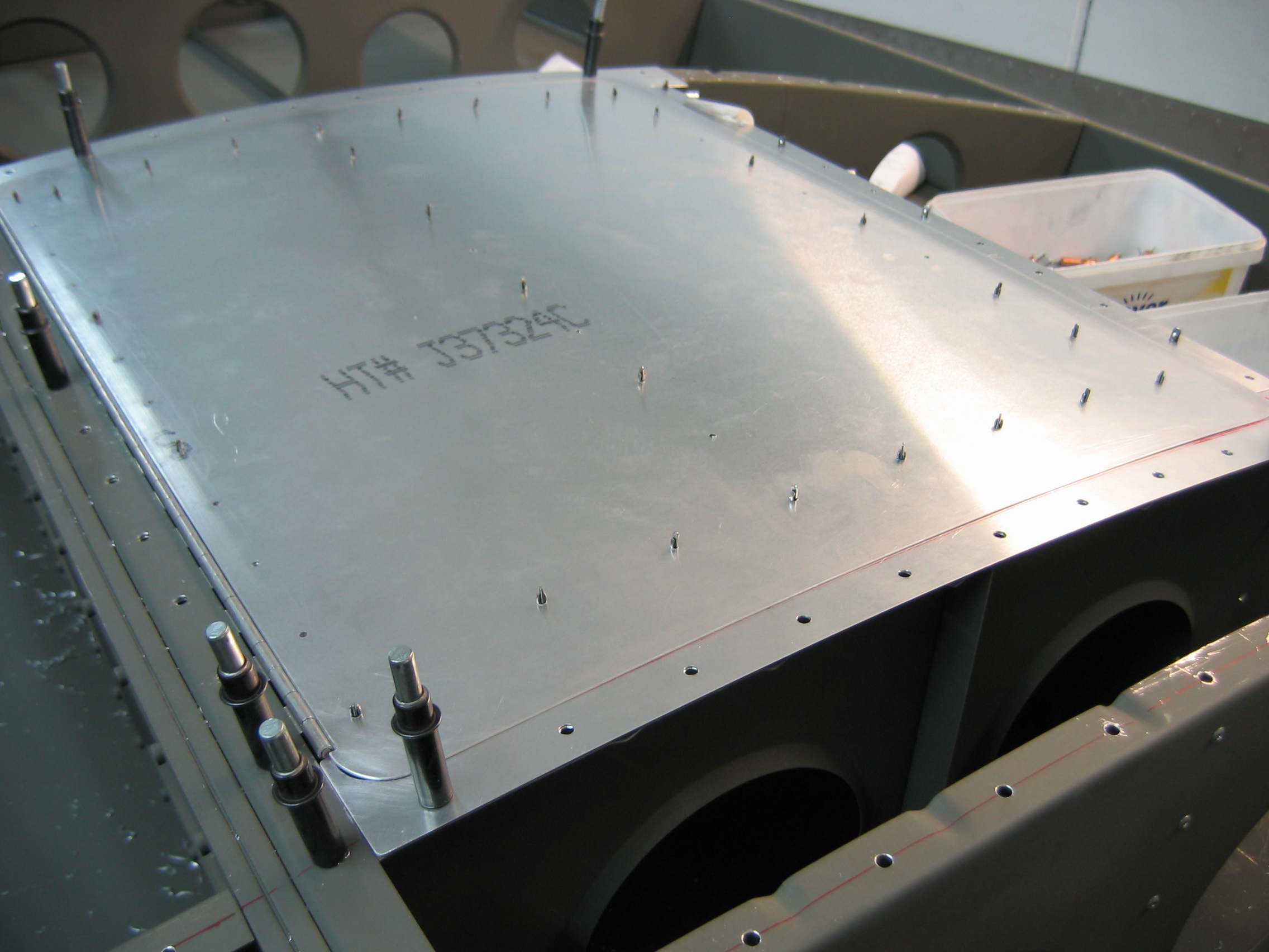

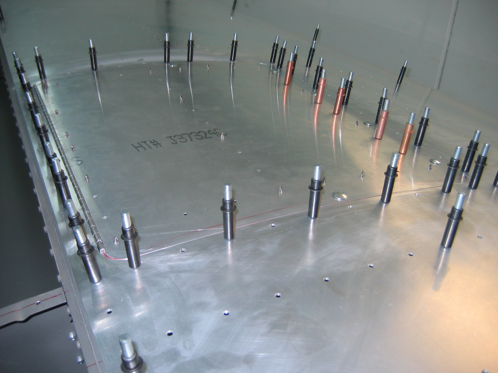

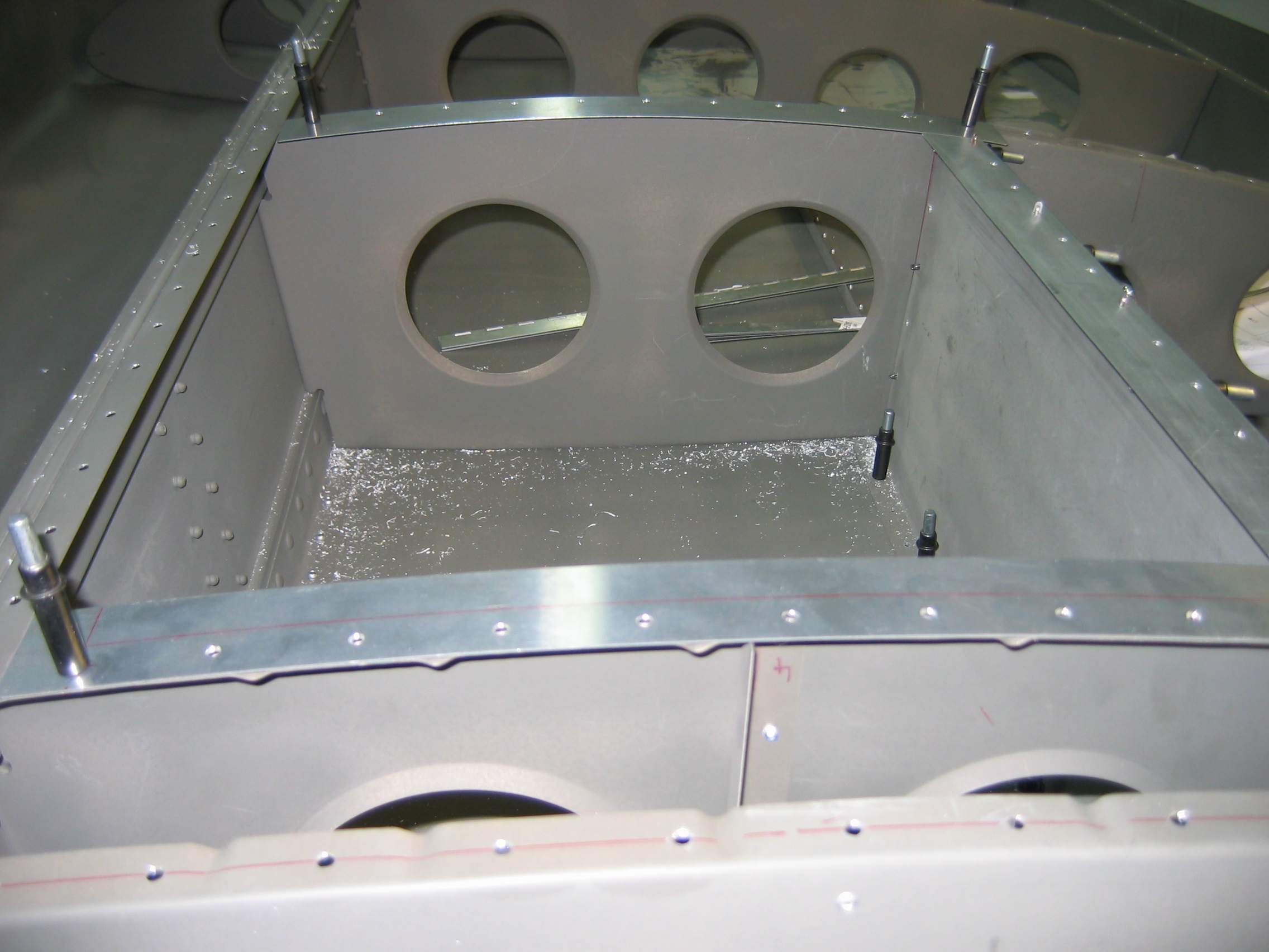

The hinge goes under the spar cap. I measured from the centre of the acutal spar , then the height of the wing lock rear panel fits .
I have just finished the right wing lock , my first and the shimming strips worked out perfect.
